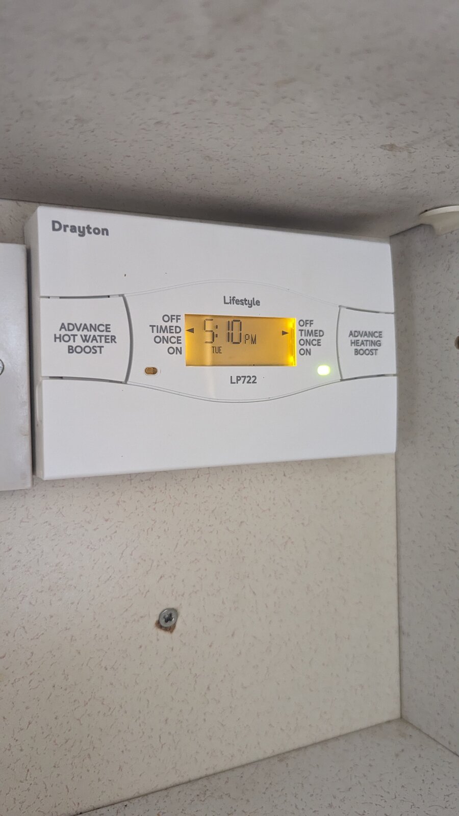

I have a Drayton LP722 central heating controller. Recently the hot water timer is not firing up the boiler (Baxi Solo 15 HE A) consistently. I noticed on the Monday evening (7.30pm - 8pm) that the boiler hadn't been triggered to turn on even though the light was green on the timing controller. If however I put on the central heating it turned on.
What was most strange is I left the Hot Water on timed mode, Heating off, and it did turn it on the next morning (7am - 7.30am).
Coincidentally I had someone from Baxi out to repair some parts on the boiler after a service so spoke to them about it. He asked me to switch on the hot water and it wouldn't turn on. The only way to get the boiler to trigger was by switching on the heating timer.
We then noticed that with the heating is on by itself, but the thermostat turned down so the heating doesn't kick in, it switches on the boiler in Water mode on the Drayton Motor Valve. If I then increase the thermostat for that the heating to turn on it changes to Water & Heating. It never goes down to just the Heating setting.
I've tried changing the 1st programon the Hot Water timer to see if it will switch on again on the same day but it doesn't.
I'm now waiting until tomorrow morning to see if it once again switches.
Any thoughts?

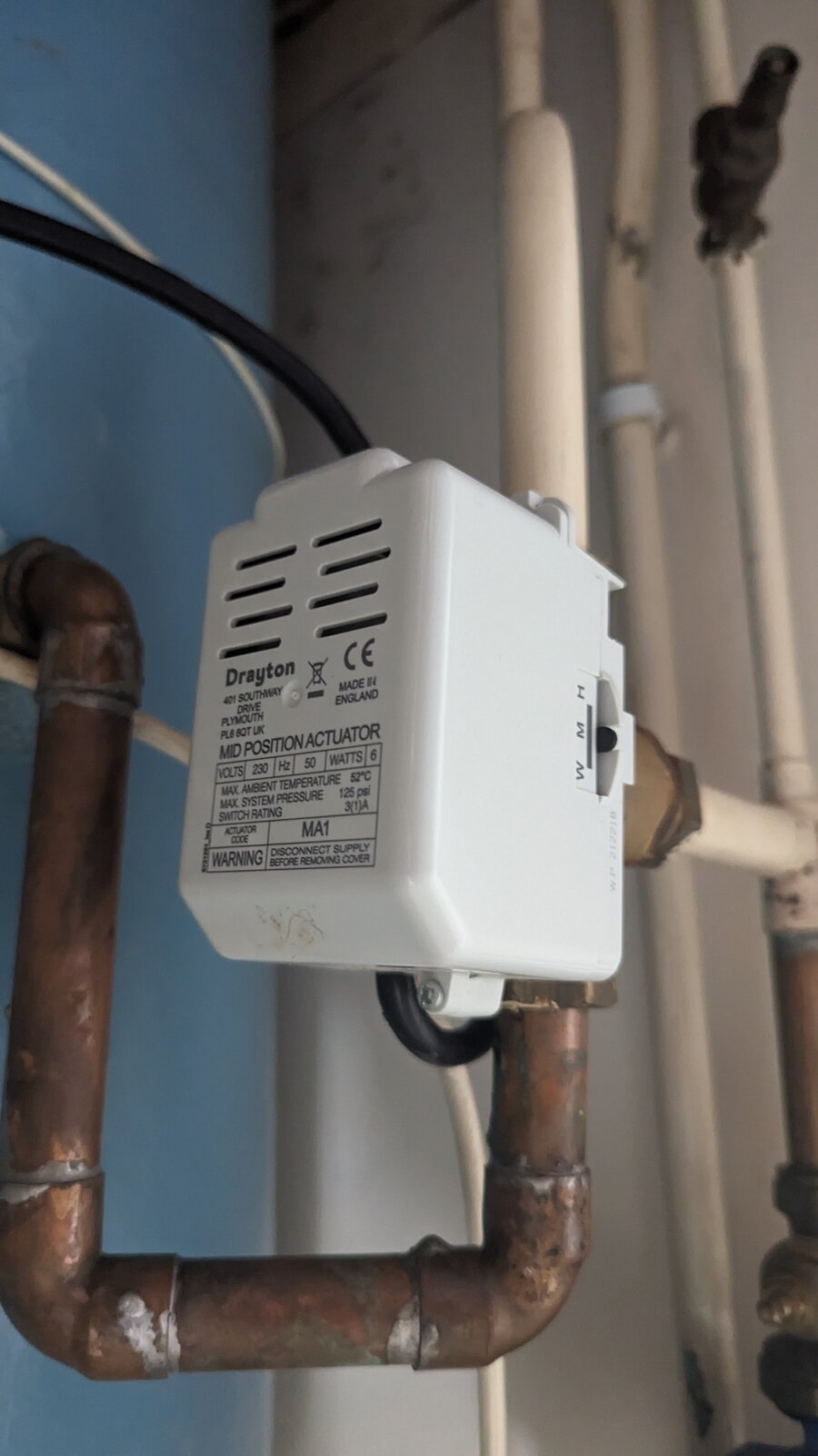

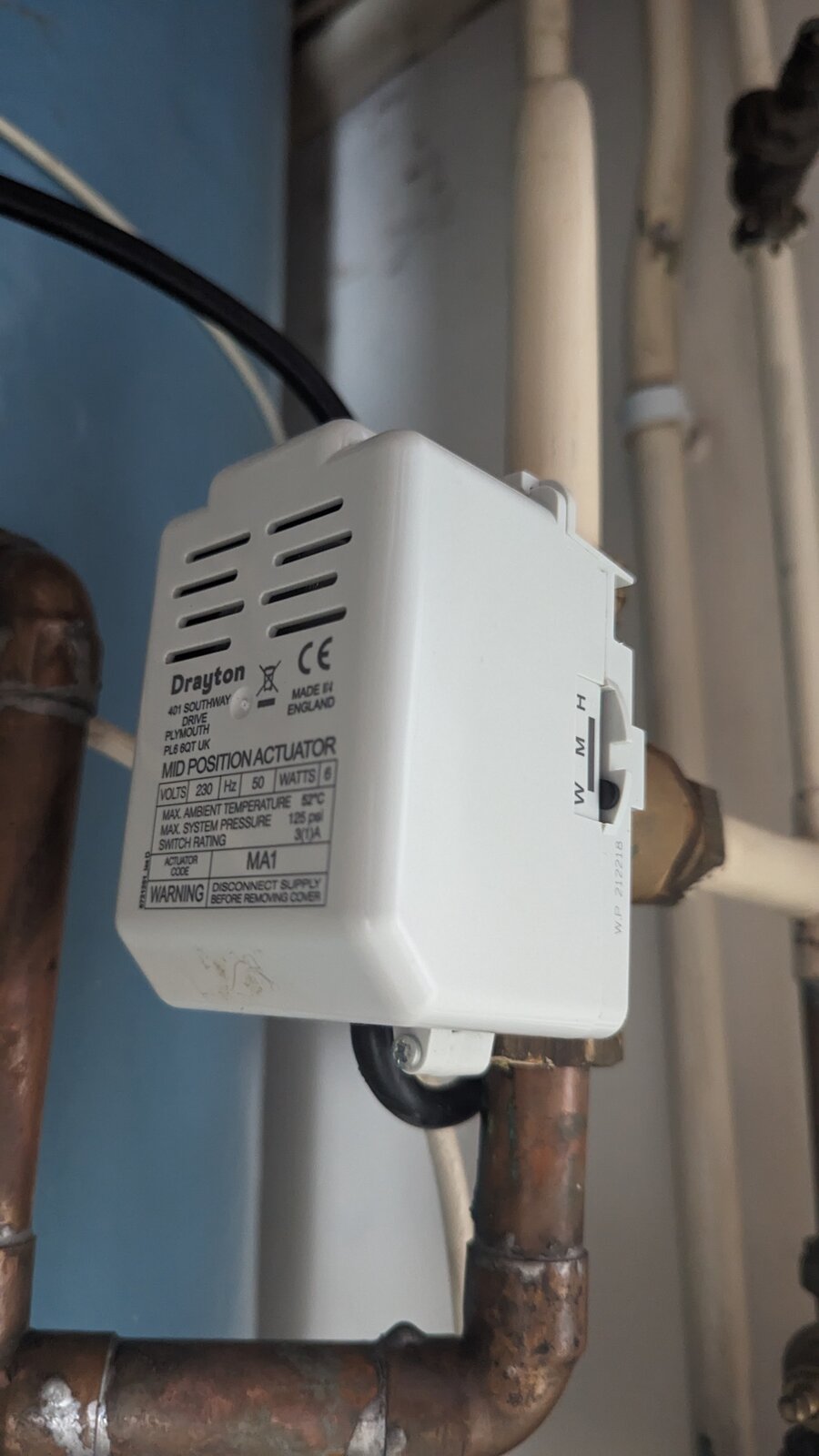

Thanks for the reply. Hopefully these images help. The image where CH mode is on only and thermostat turned up is the one where the Drayton valve is in the M position (also like that if HW is turned on as well as CH with thermostat up). If the thermostat isn't fully up but CH on then the boiler fires up, as does the valve, but in the W position.
If CH isn't on it doesn't fire up.
I'm intrigued to find out if it fires up tomorrow morning on just HW timer like it did today. That will be the real twist that I won't understand.

Looks like valve actuator fault.
Is the cylinder stat calling for HW each time HW is requested?, check/note its setting then turn it up/down to hear it clicking, return to original setting, normally 60C.
Request both HW&CH, valve should be in mid position, then turn cylinder stat down, check if valve goes fully over to CH only.

The HW only didn't trigger the boiler to turn on this morning so it does seem that there is a fault with that connection.
Still think it’s the motorised valve. Turn power off for the programmer, should also turn all other controls off. Wait say 10 minutes, turn back on and select a hot water demand, note if it fires up.
