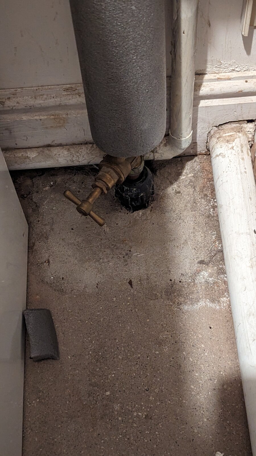

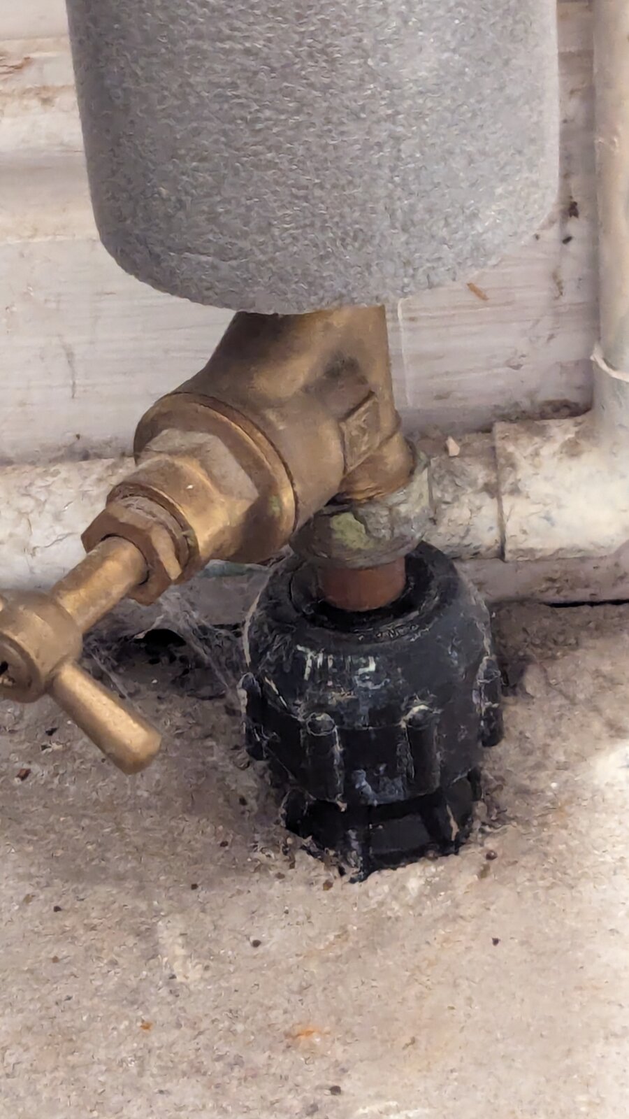

My incoming water main from the street is a blue plastic pipe.
I had a heating engineer in to give a quote for a new boiler and he said that because the incoming pipe is blue, it must be a 20mm so we should upgrade the copper pipe coming out of the black thing to 22mm - is that correct and can that black thing accept a 22mm pipe?
Also i'm not sure of the name of the black thing but i'm trying to work out how it attaches to the pipe beneath the floor level - would it be PVC glued, or just a compression fit?
Reason for asking, i'm trying to trace a dampness on the other side of that wall and there is also a "ring" of salts around the incoming main and i'm wondering if somehow its leaking beneath the screed level. Does it look like that, or ok? The heating guy didn't mention anything about that.

It's a compression fitting joining the pipe below to the copper pipe above ,and it shouldn't be surrounded / buried in concrete.
Are you converting to a combi boiler from a conventional boiler and hot water cylinder ?
Is the advice to rip out all 15mm pipe and replace with 22mm ,or a certain section ?
No, system boiler for system boiler and unvented cylinder, from current open vent Y plan.
Just been googling, i think its called a transition fitting and can accept 15-21mm pipes.
The suggestion was to increase the incoming copper side of the main from 15mm (as shown) to 22mm to the unvented cylinder which is going to be fitted, as the "other side" of that are already 22mm pipes internally for hot water.
Yes does seem odd that its buried. Might it be leaking a little too..
Get yourself another heating "engineer", only by measuring static/dynamic water pressures and flow rates can you determine whether the incoming service pipework is sufficient.
My own place has an imperial copper 1/2 main but with 5 bar static the flowrate is ample at say 1 bar dynamic (the pressure when water is flowing).
The 'black' thing is a Philmac universal transition coupler BTW ;) Easy enough to knock some of that concrete out around the coupler and check if it's leaking but TBH it would be darker and damp usually if it was. You may find that the current staining has just been condensation from the cold pipe.

Is there a number stamped on the side of that brass stopcock? To my eye it looks bigger than 15mm. You might have to hold your phone or camera behind the pipe.
