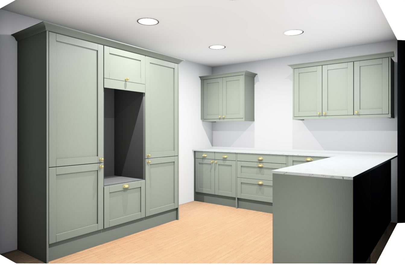

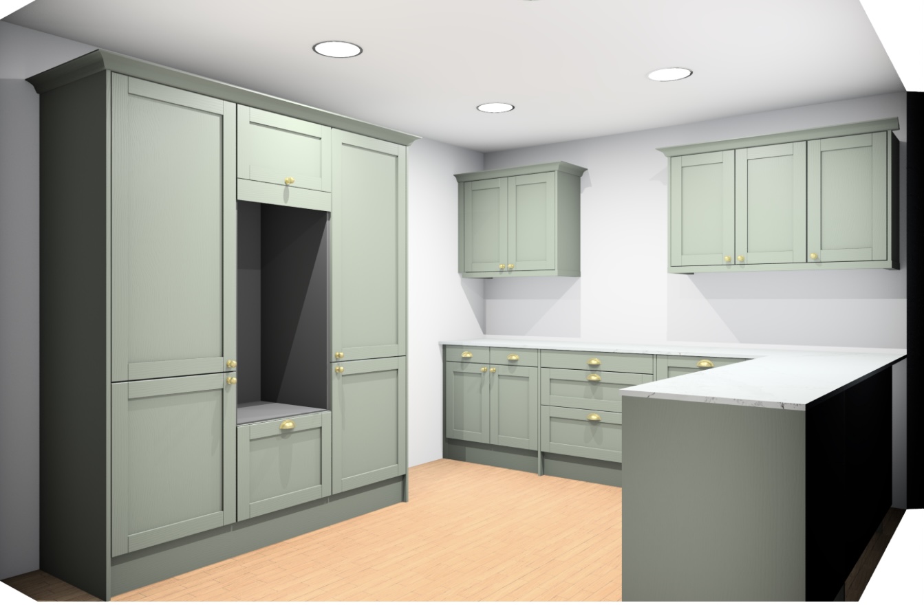

I don’t quite know what you mean but there are tall cupboards going either side of that (fridge freezer and larder unit) and they will be set to the same height. Will look something like this when done.
That looks great. I can't believe how quick you did it.
Should be finished by the weekend.?

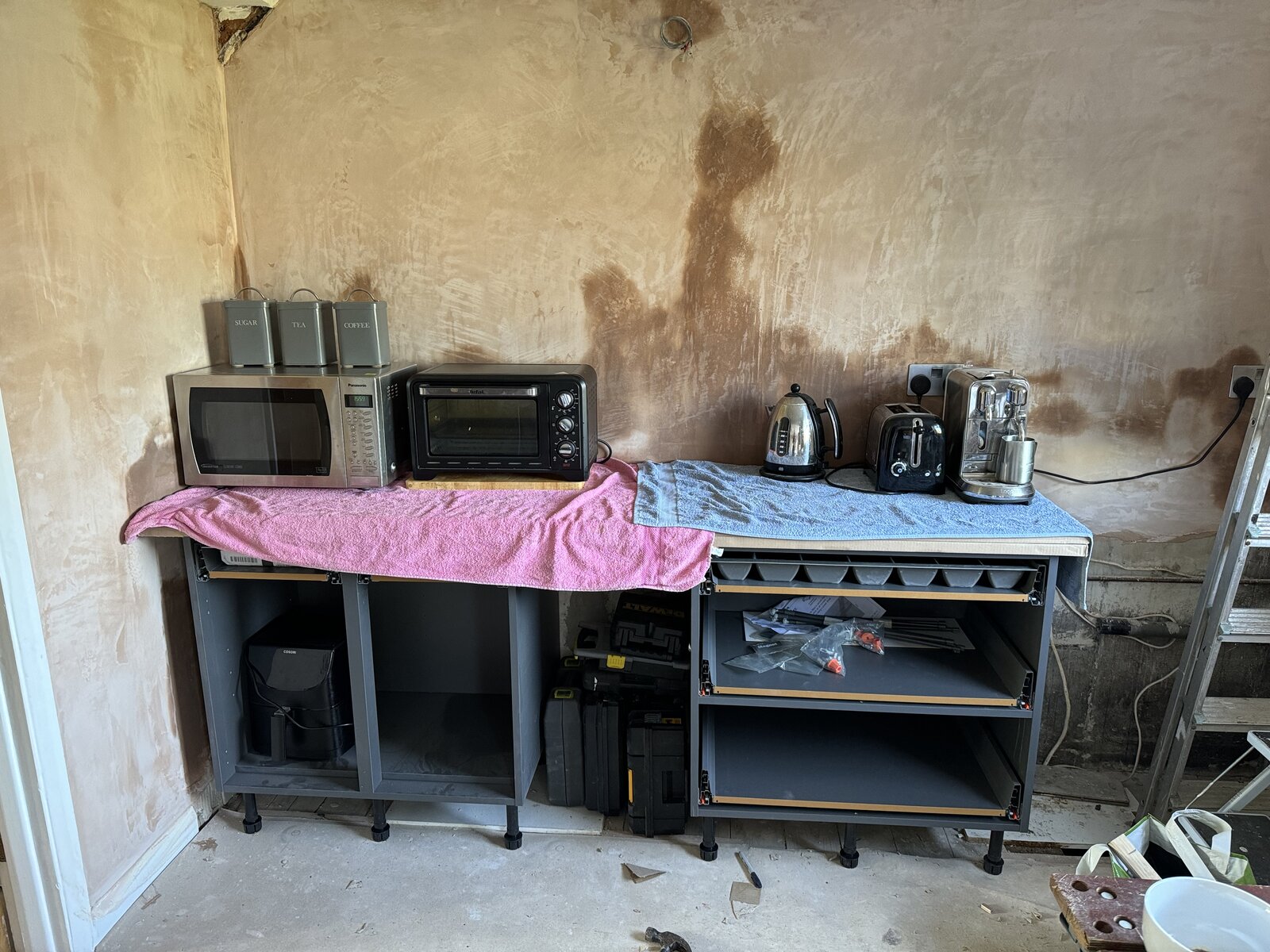

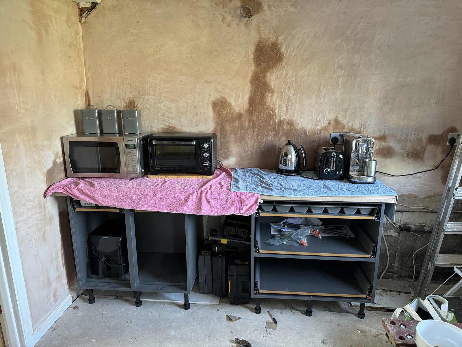

Well my mate came round this morning and plastered the walls for me. Going to come back and finish the window reveals when I’ve had the new window fitted. Wouldn’t take a penny off of me for it so I stuffed £100 in his pocket and after he had left, I saw he had put it under a cup on the table so I’ve got to get him back when he's next round.
Before:
After:
At least I can crack on with the units now.

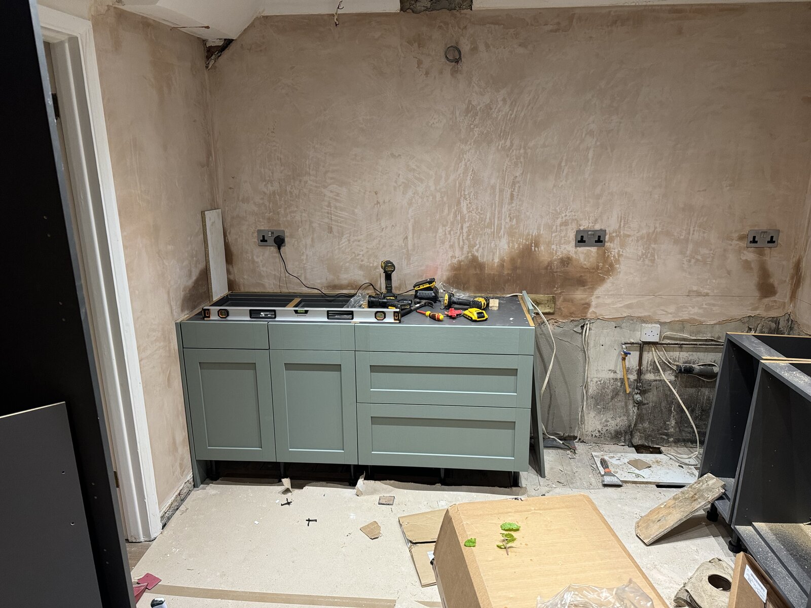

Well that was easier said than done. After spending a whole day getting the ovens fitted into the housing and the door, drawer and infill panel spot on, they've all got to come out again. I could cry!
Why?
When I lined up the larder housing to the oven housing, it was out and I had a gap at the bottom against the wall. The wall is slightly out too so might need hacking or skimming. Checked again and the oven housing is leaning slightly backwards. Going to have to take the ovens out, loosen the oven housing from the wall, build up the fridge/freezer housing on the left, connect all three tall units together and sod about with those units until I get the best fit. I’m on a break at the moment, might give it a rest until next Wednesday.
Plan B. Forget the oven/fridge/larder units for a while and concentrate on the base units. At least when they are done, they can come round and measure up the template for the quartz worktop. Yeah, that sound like a plan. While that is being made, I can then carry on fùcking up something else! :LOL:
Today’s possible headache was to move the stopcock 4 inches to the right as it would be in the way for the dishwasher. Then simply connect the dishwasher back up as we were getting fed up lugging dirty crockery upstairs to do the washing up in the bath. I couldn’t believe my luck - it all went like a dream. I even replaced the stop cock with a lever valve. Then it all went to shìt! I went to connect it up to the waste and I saw a drip coming from the waste where it goes through the wall - there was a crack in the pipe. I tried to change bit that but ended up changing all of it because it had solvent joints. Problem was, it was also solvent welded to the soil stack so I ended up replacing the lower section of soil stack too! I suppose these waste pipes do get brittle with age though - they have been there for 25 years after all, getting hot, cold, hot, cold - they were fitted when the kitchen was last changed. Anyway, to sum it all up, I basically spent all day just fitting the dishwasher back to within 4 inches of where it came out of!
