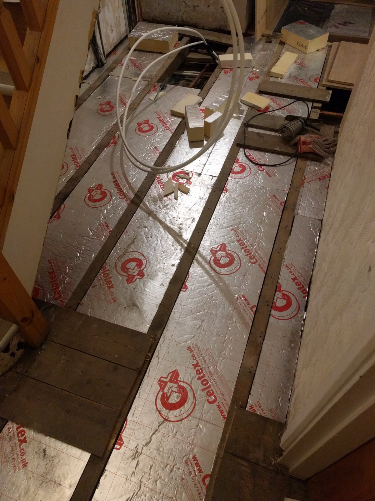

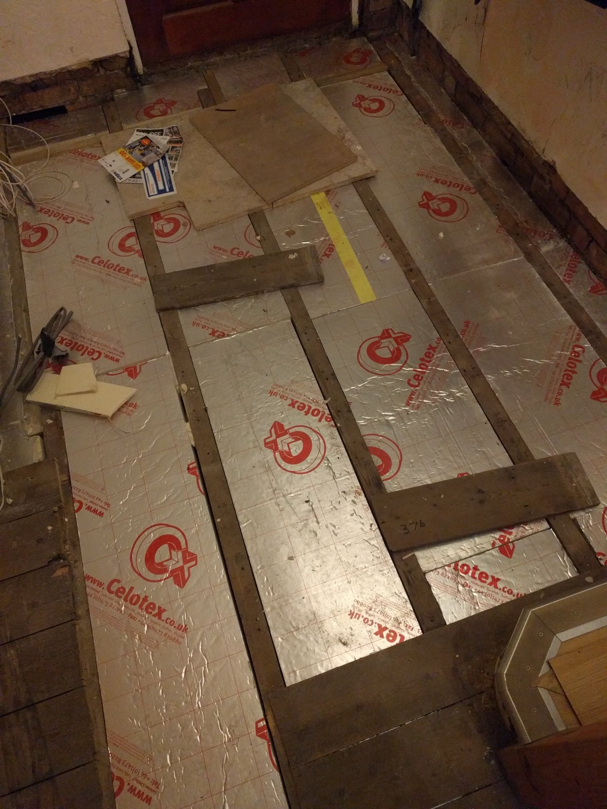

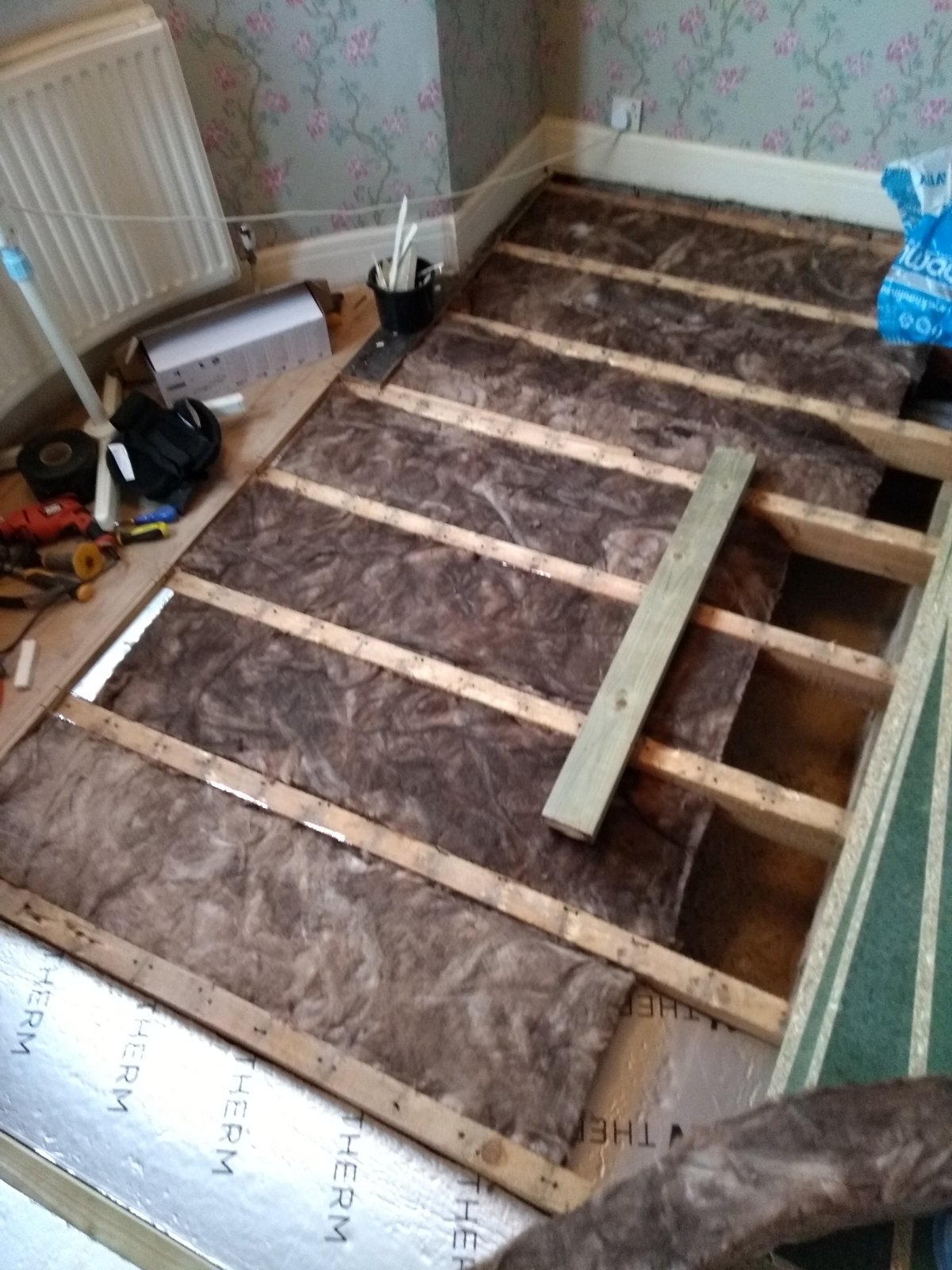

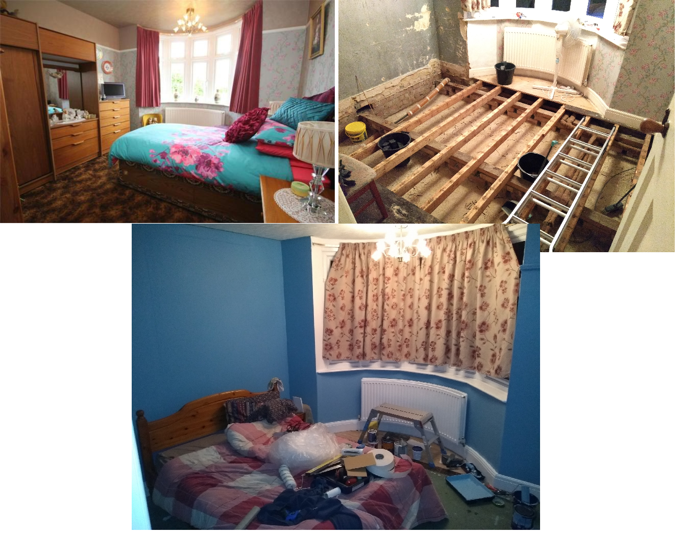

My wife has a better eye for cutting than me, this is her handy work today and last weekend or two. We were waiting for the gas pipe to be moved before the last bits. Just got to foam the edges and tape the joists, plus a couple of bits we don't have enough.

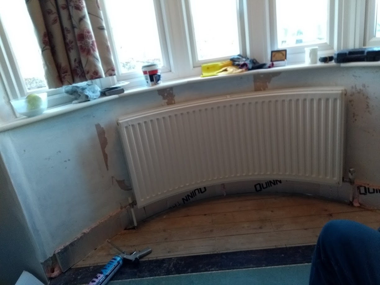

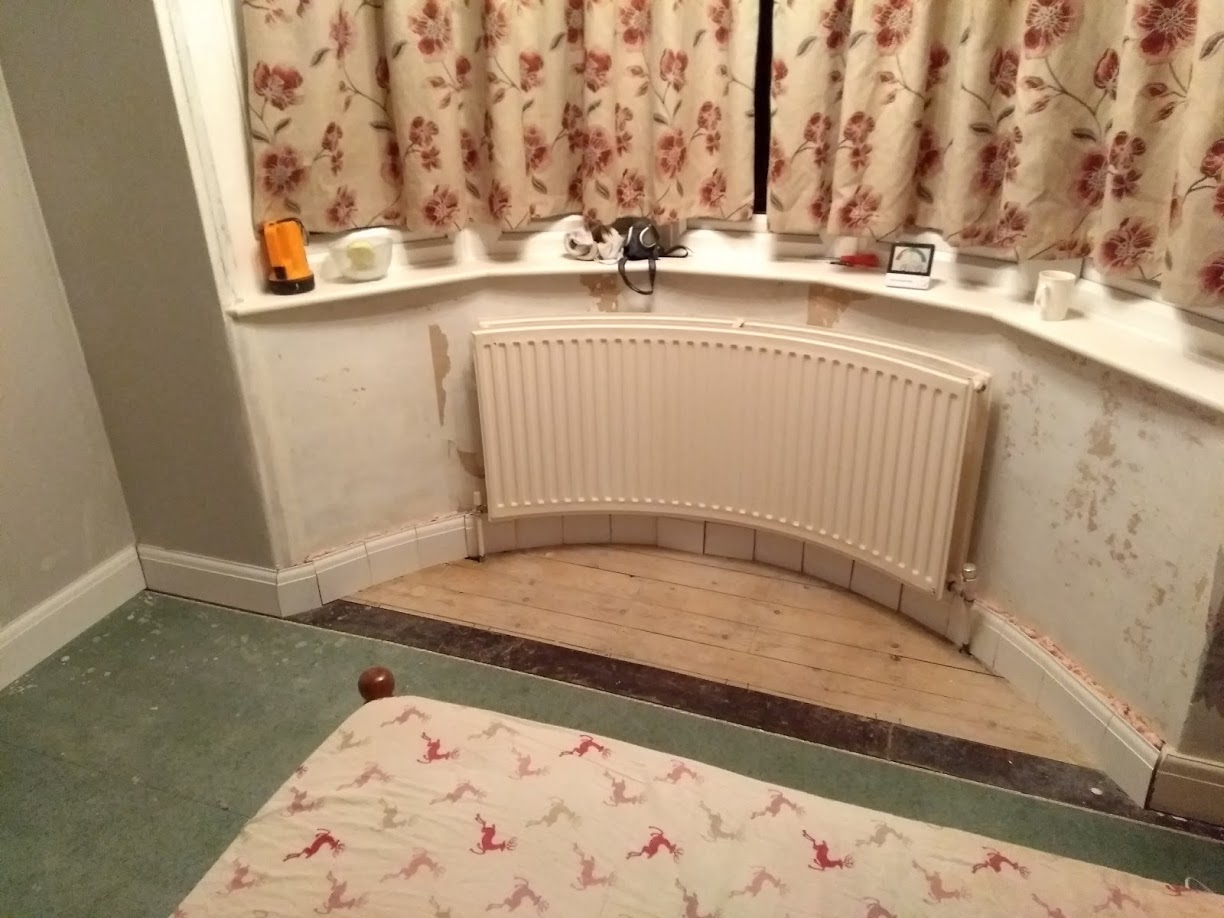

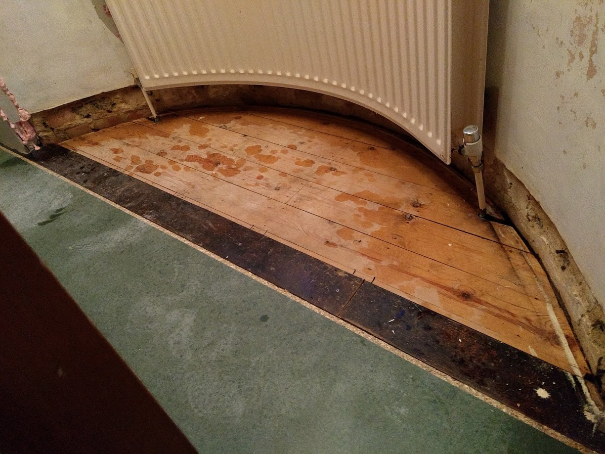

Skirting boards in place. Put insulation board along the bit under the bay, where the old got mouldy and a bit rotten. Sprayed everything with wood preserve beforehand. Will have a lip above the skirting in the bay, but better than rotten boards. And, warmer too. Already warms up quickly, and that's without a carpet.
