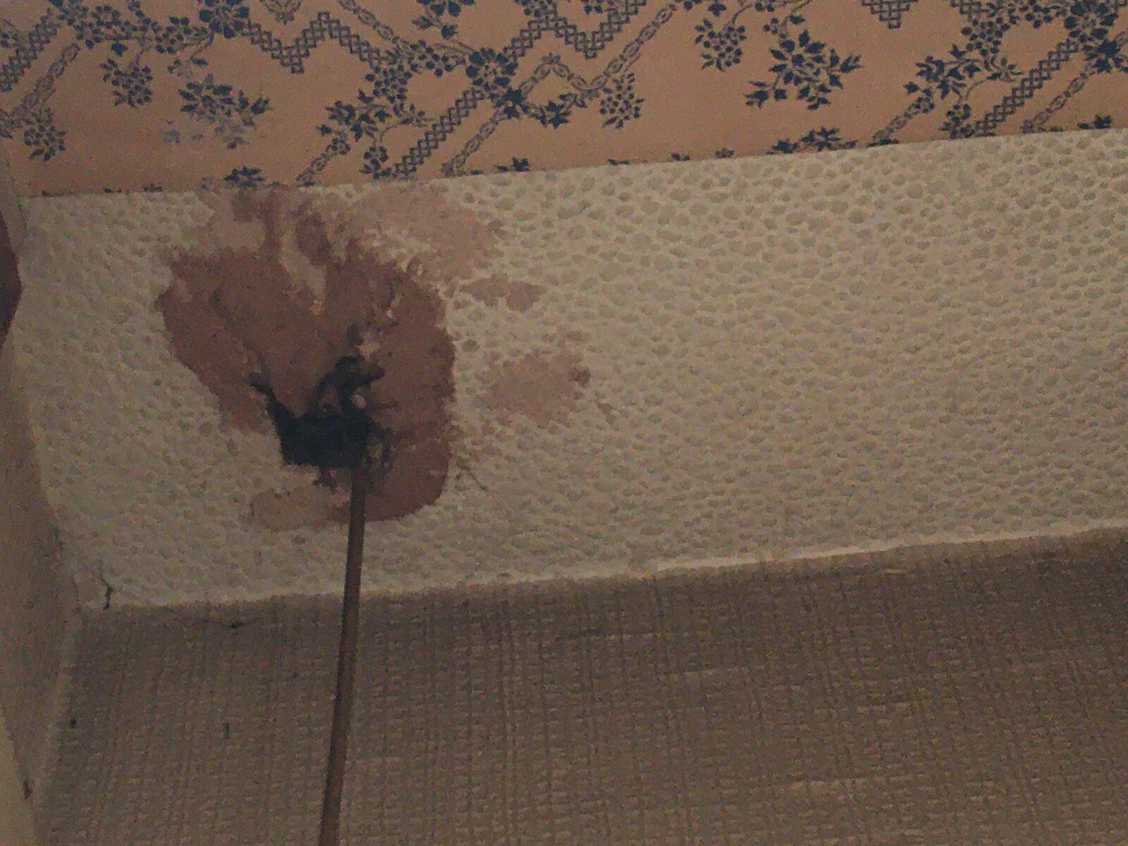

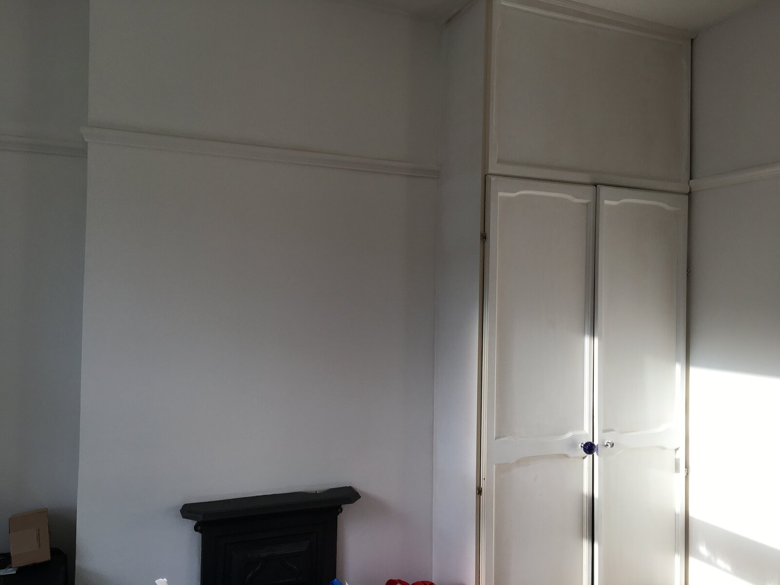

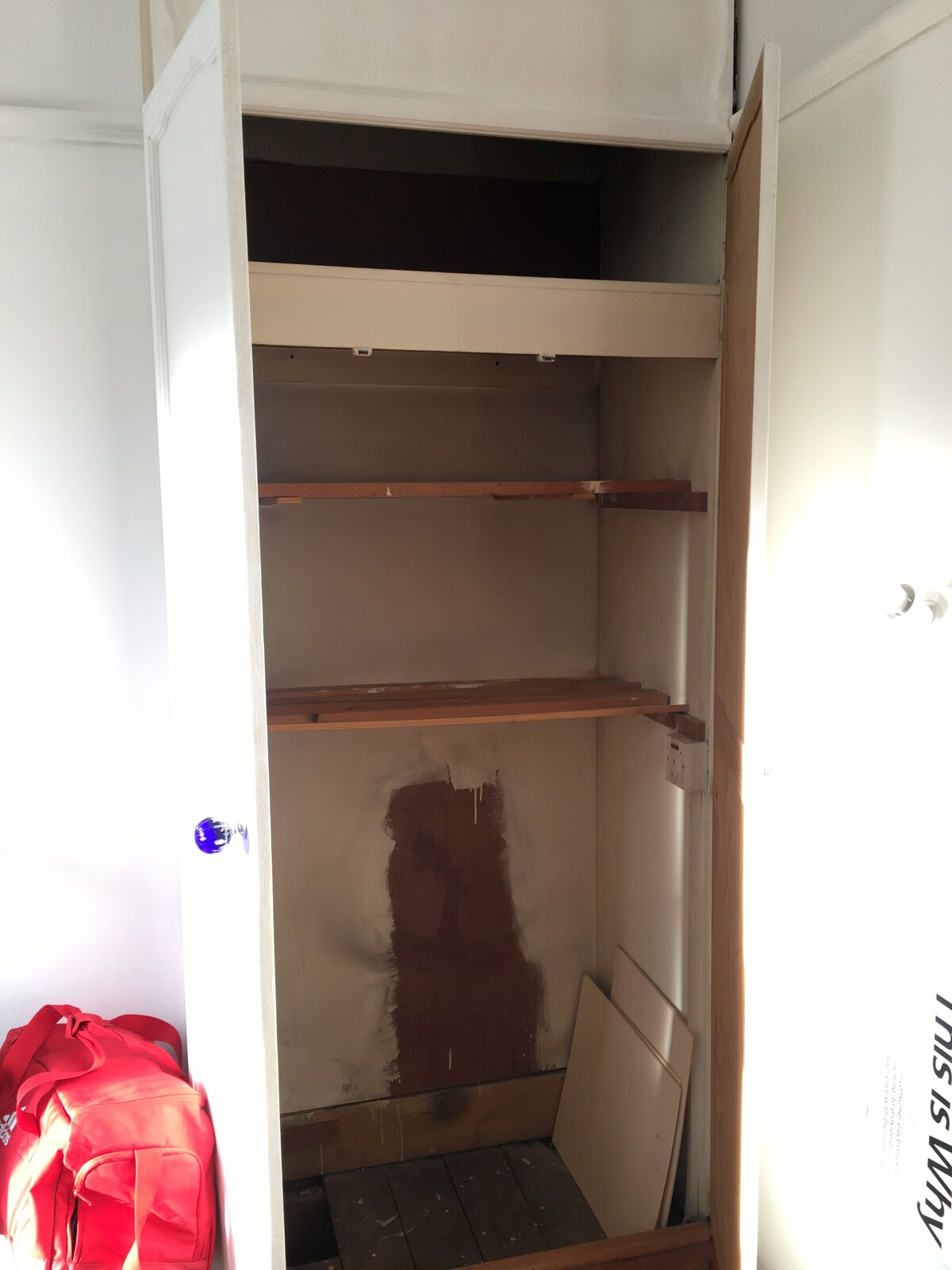

I have just moved into a house and found there is a wardrobe-like thing which is very dirty inside. I think it might be for the old boiler.

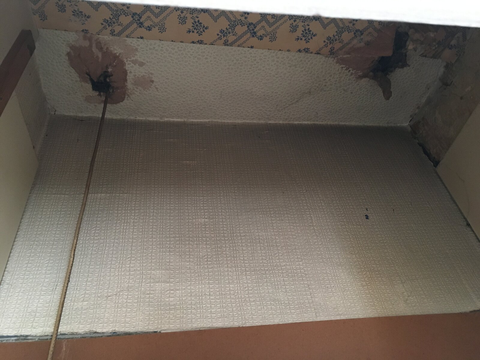

I can see from the ceiling inside the "wardrobe" that there are some pop-corn materials and other are 2 nasty damaged holds to the loft.
I fear that this material contains asbestos
Any thought on the photos?
I will have to hire a company to do the asbestos test.
The "wardrobe" looks strange. I wonder if anyone has idea what it was for? I really want to remove it. but probably plastering in this small area will be needed (ceiling and the wall)?

It looks like an airing cupboard. It would have had a hot water cylinder at the bottom and the heat that escaped through the insulation on the cylinder would keep clothes and towels etc on the shelfs warm and aired.
Thank you so much! it is definitely an airing cupboard and there was a hot water cylinder in it. All the pipes and the cylinder were removed. There are 2 holes on the ceiling in side the cupboard. I am thinking of completely removing it and redecorating the wall and the ceiling. Wondering what range of budget I am looking at?
Looks like a simple-ish job; crow-bar/screwdriver to break up the timber framework. Then strip the wallpaper. Finally patch/replace (or just sand and paint) the skirting if needed, then skim and paint the plaster.
As to cost, reckon on maybe half to a day of 'plasterer time', cost depends whereabouts you're based, probably have to ring round and ask.
