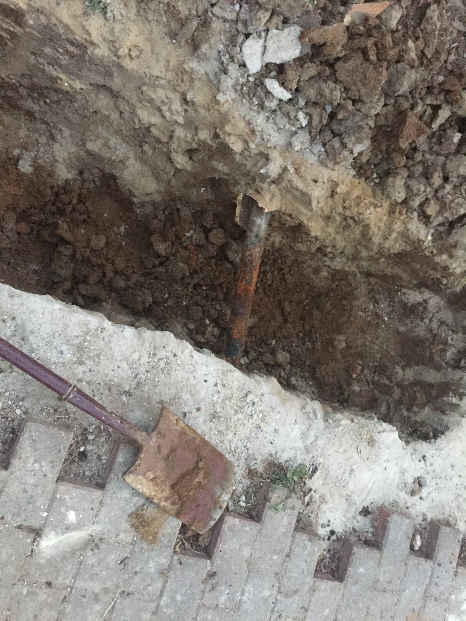

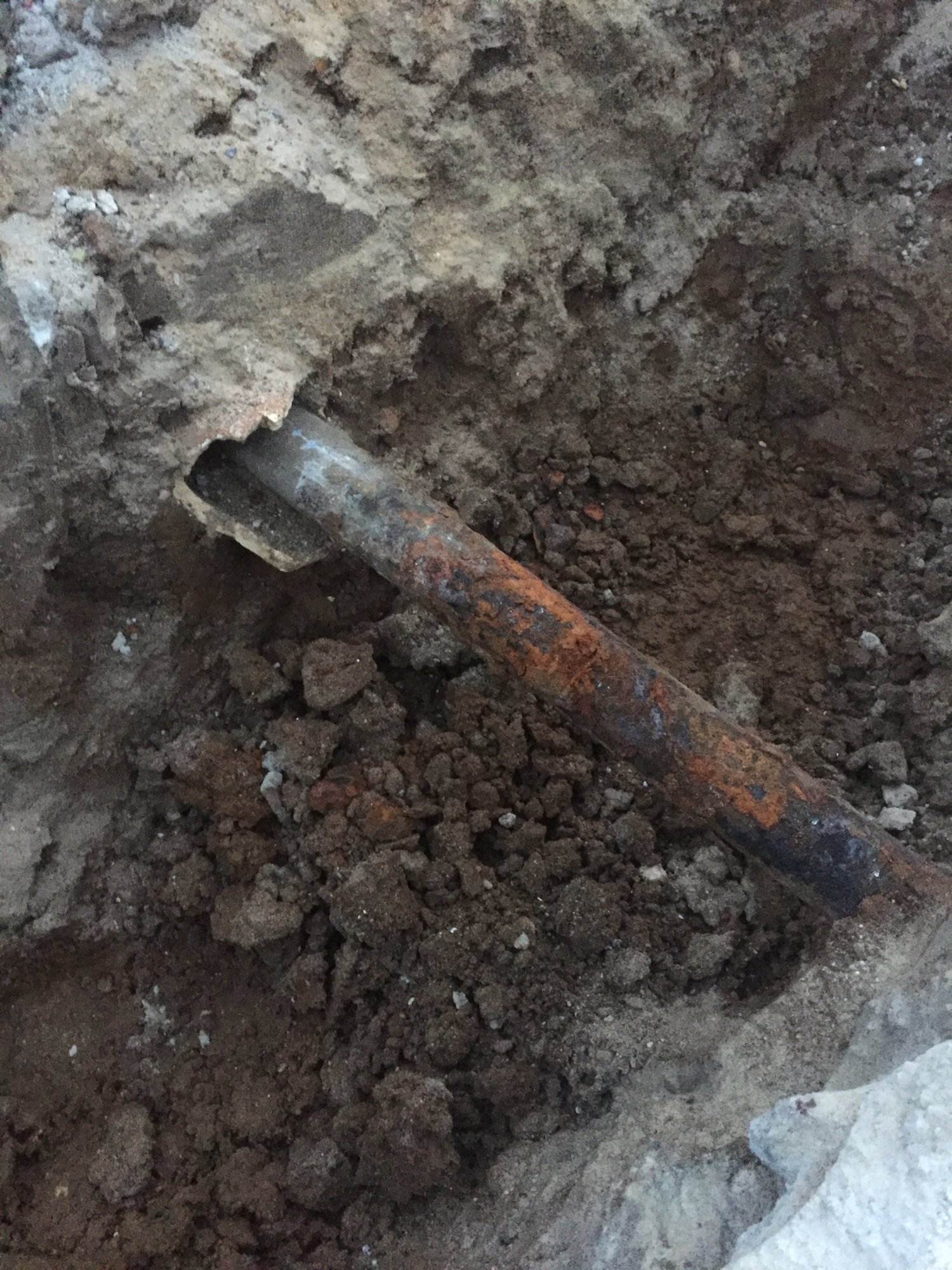

Evening folks,
Long time lurker but only just joined-wondered if anyone could give me some pointers on what this pipe might be related to?
I’ve just been digging foundations for the extension and come across a galvanised pipe partially laid inside inside a clay pipe. The clay pipe seems to stop where that break is. Haven’t measured it but it’s about 30-40cm down.
It’s coming from the rear of the (1930s) house, heading down a longish garden away from any roads. I know the gas, water and electric come in from main road at the front of the house.
Thought maybe a pipe to a soakaway but would that be run in relatively small diameter galvanised?
I’ll nab a CAT scan from work tomorrow and see if I can trace it but wondered if anyone had any clue what it might be?
Maybe an original gas pipe but difficult to tell without knowing where it's going to and coming from.
There may be a history to the development of your estate/nearby houses which would give a clue.

How did it come to be inside the clay pipe though, if it was pushed through?
Finally got chance to having an explore on this and thought it would be good to update.
I dug along the more accessible route (towards the house) and found the end connected to nothing but with a loose smaller diameter galvanised pipe inside it. So now I had an inch or so diameter steel pipe, inside a 3 inch ish steel pipe inside a clay pipe. None of which are connected to anything at the house end.
Mystery solved enough to chop it out of the foundation trench with no repercussions but not enough to actually know what it was originally laid for (and Im not curious enough to keep digging when I dont need to)!
