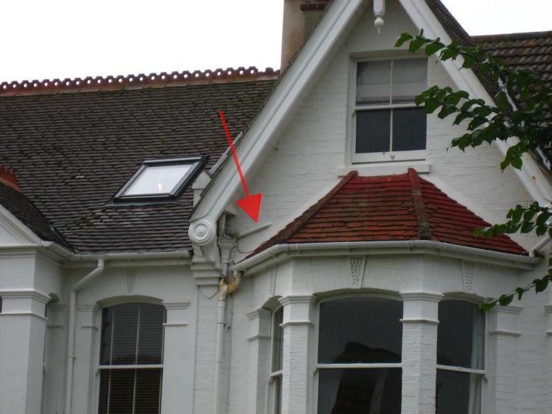

I just noticed a strange pipe that seems to feed a hoper on the front of the flat ... and I have no idea where this pipe comes from ??
Behind that pipe is a bedroom with a bed in the gable and a radiator under the window. But no water services anywhere near that outflow pipe.
The hopper also receives water from the valley above which flows straight down into the hopper.
What could that other pipe be ?

Well ..there looks like grass growing out of it, which isn't a good sign.
That's why I was photographing it actually.
Had it cleared 3 months ago, not sure how that vegetation got in there. Possible the f*ing seagull nest fell into the valley from the chimney stack after the chicks f'ed off.
I don't have any means of accessing that location so it £40 a go for the gutter man.
I would imagine that the valley was cleared 3 months ago but not the hopper.
The pipework below the hopper, and the pipe feeding in from the bay and the RH valley, is showing signs of rust perhaps its semi blocked, and weeping at the joints.
To the right end of the bay gutter there appears to be more vegetation growing in the gutter.
The LH valley is discharging into a chute outlet - presumably, lead dressed into a pipe. This vulnerable outlet and pipe should be investigated for blockage debris and leakage.
Your ladder person should take some pics of the bay roof tiles - they are deteriorating esp. at the hips.
The hopper, redundant sink waste and all pipework to below the tee could be removed and new plastic RW pipe and tee installed, and adapted to the outlet above.
Hopper was cleared 3 months ago.
But it's also been ending of the nesting season so possibly vegetation could have fallen down the valley.
