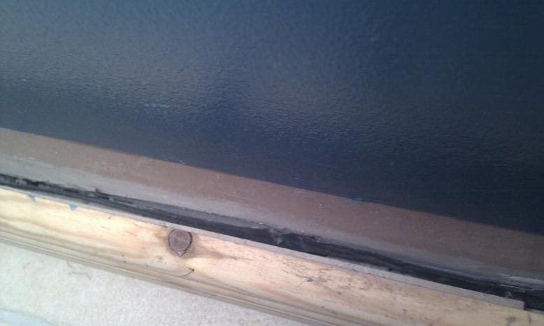

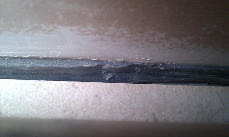

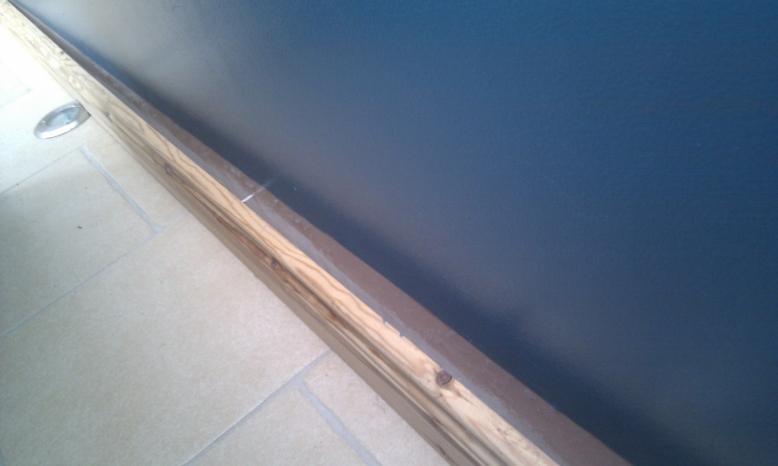

I've attached a few pics of where I pulled the skirting board back;
The smell is quite strong when the board is pulled back like this, and seems to be strongest at the end of this wall closest to the house. Also, I don't know if that's what the join between the wall and the floor is supposed to look like - can someone verify that this is up to scratch?
