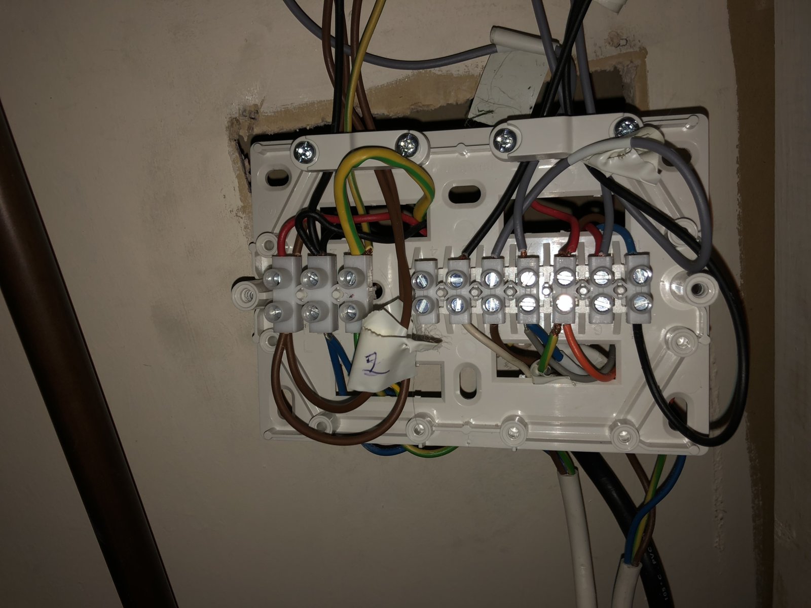

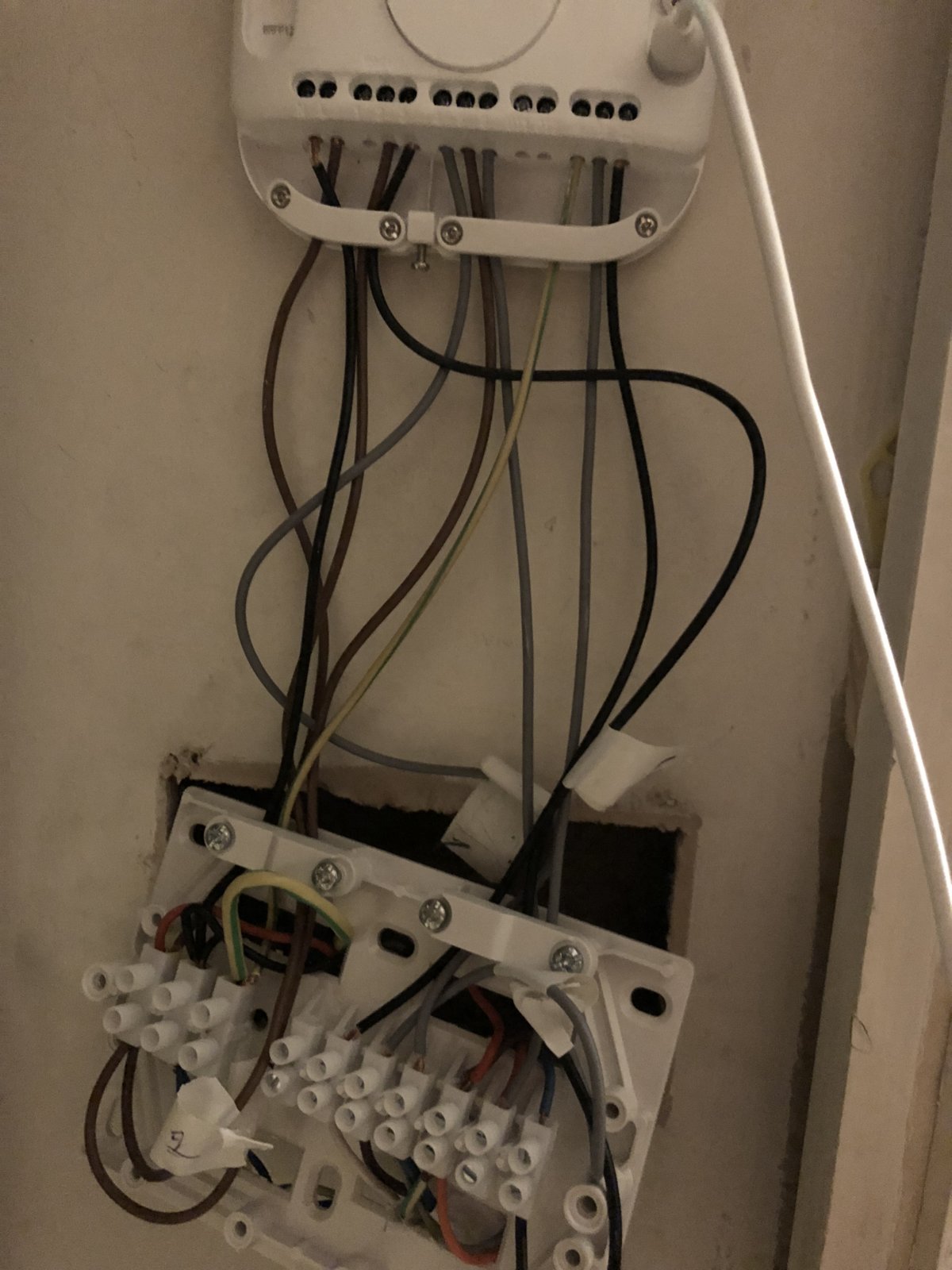

Got any pics of the wiring center ? Wired up
I’ve attached the photos of the junction box and another with the Nest Heatlink. I do plan to change the wiring colours once it’s all up and running - as mentioned, the cylinder stat needs changing plus a few others.
I have the following:
1 - Live
2 - Neutral
3 - Earth
4 - Blank
5 - CH on (valve white)
6 - HW off (cylinder C)
7 - HW on (valve grey, cylinder 1)
8 - CH on (pump L, boiler L, valve Orange, cylinder 2)

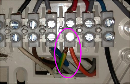

@ban-all-sheds as mentioned, the cylinder was wired with a brown, blue, yellow/green 3-core and those are the cylinder 2 and the orange wire from the 3-port valve. Is that not correct, or are you highlighting the colours? I’ve already mentioned that i’ll be sorting them once the system is actually working.
Green/yellow is for earth, not live.
Whilst using the G/Y core of a cable for something other than earth is allowed (as long as the core is oversleeved to identify it's use, which that one isn't), it's regarded by most people as a Very Bad practice, only engaged in by plumbers and others with no interest in doing things properly. You can get cables with more than 3 cores, so re-purposing the G/Y is inexcusable.
