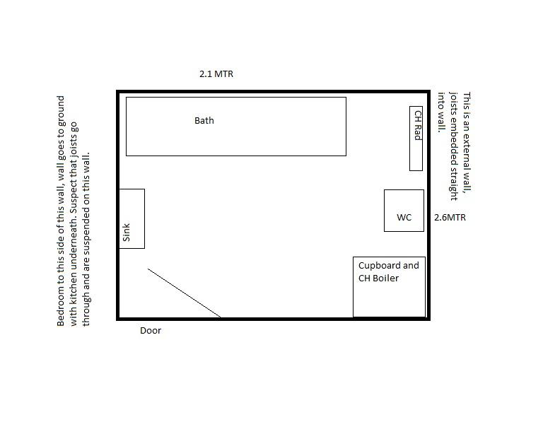

Hi All
I need to tile a bathroom floor, about 2.6x2.1mtr. It's a 1930s semi with joists set at about 430mm apart and they look to be about 6x2 inch. The 2.1mtr is the size of the room along the length of the joists and the 2.6mtr is the size at of the room at 90deg to the joists if that makes sense.
The floorboards aren't too bad but rather than over boarding over them I was thinking of ripping them up and laying 18mm wbp direct to the joists.
As wbp comes in 2440x1220 I'm hoping I can just use maybe three to do the entire bathroom, one alone if laid at 90deg to the joists will almost cover the 2.6mtr bit with a bit of help from a noggin.
Does this sound feasible or am I going over the top with this?

Hi again Richard
Ive added a dogy drawing of the bathroom if this helps..
Joists are 2x6 inch give or take a few mm and run across the room when entering the door.
The floor feels solid as a rock when jumping up and down, suspect they overdid things in the 30s...
Joists in many older properties are usually 7 or even 8” deep but your 6” are probably due to the short span of 2.1m. If they were 7” or 8” joists, I would have no hesitation with 18mm WBP but you may do better to go up to 22mm to be on the safe side.
I would lay the boards with the joists with the joint along the centre line of a joist. You may get away with 2 boards but it really depends on the exact joist pitch; 1200 isn’t exactly divisible by 430 so you may be stuck with trimming the edge of the boards back to get over the centre of a joist which means you’re stuck with 3 sheets. You could go across the room with 2 boards but you’re going to have the cost of extra timber & all the work of fitting noggins right across the bathroom. You should be OK with the thin strip of ply in the corner by the towel rail with adequate support; it’s not going to subject to any real loading. Usual advise is to fit noggins on the two unsupported sides of the room but, TBH, if it’s not subject to load it isn’t going to be a problem. I would only bother with the bit immediately inside the door up to & under the sink & also where the W/C is fitted; the rest is only subject to minimal loading & will be fine. Make sure the edge of the board is fully supported across the door threshold; sister the joist if you have to. Watch where the bath feet are located & if not directly over a joist, fit noggins to provide decent support.

Almost down, one strip to fit. Cut it by hand as was a bit worried that my viscious circular saw might have pulled the layers apart; joists gap varys by about 5-6 mm so couldn't use the timber merchants cutter.
The joists are 7 inches not 6 so used 18mm wbp, found it surprisingly easy to cut with a new saw.
