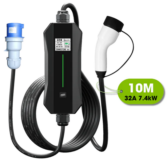

There are plug in charging leads 1700298591479.png designed for use in garages with 32 amp plugs able to use supplies intended for welding sets and the like for charging an EV. These can be set to 7 charging speeds: 6A, 8A, 10A, 13A, 16A, 20A, 32A, so could be used even when 32 amp not available. And they do have
Advert said:
Built-in Type B RCD protection: Type A + 6mA DC
however what they do not have is a CT coil to see what the rest of the house is using and automated to ensure the total load does not exceed the supply to the house.

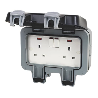

One has to do things in order this 1700299205650.png does not really work, one needs the charger before you get the car not after the event. I know it is tempting I have an outdoor socket myself 1700299390791.png and it would be tempting to simply plug in a visitors EV, and if we cordoned off the car so no one or animal can touch it while on charge then suppose safe enough, and we could simply take a chance that we will not loose PEN when charging. As a one off, OK, but not on a regular basis.
