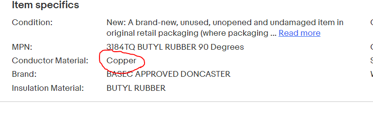

I believe what I read. Even if it's wrong, I still want to buy it: tinned 4 core heat resistant cable. Is there a special name for this cable? I don't want to buy one and end up not having tinned conductors. The exact appliance doesn't really matter.

For a 3A protected cable, virtually anything will do ≥0.5mm².
The flex you linked will carry 16A.
Oh, and incidentally, from the link:

Copper and tinned copper are not the same. Tinned copper is stronger and has other useful qualities. The links show what look like untinned wires.
