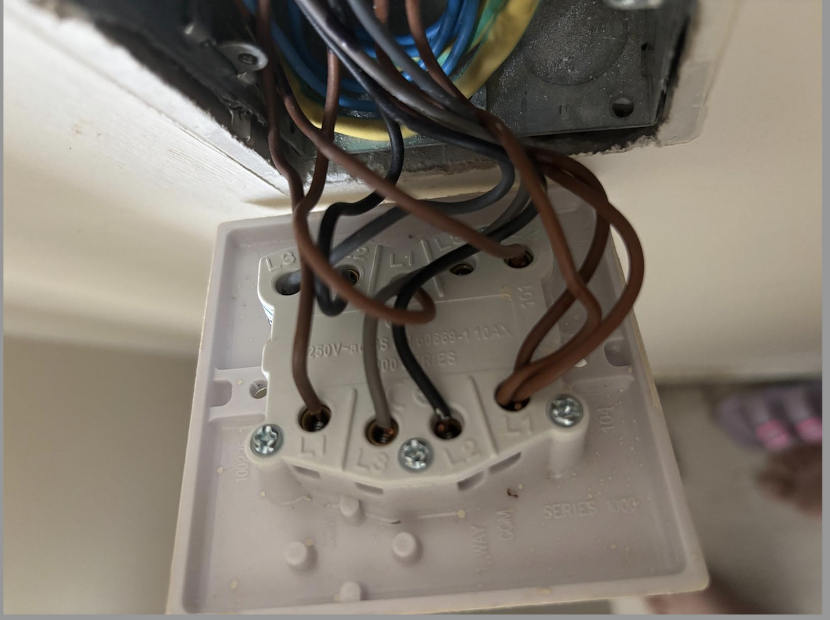

Hi experts,
Found on google that we have below difference in the naming scheme between 2-way switch, and 1-way switch:
L1 on old switch is Com on new switch.
L2 old is L1 new
L3 old is L2 new
I did exactly the same but no luck as all of my electricity gone due to fuse tripped which might be due to some kind of short.
My current wiring is like one:
New switch:

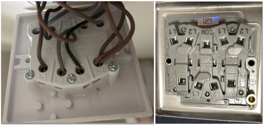

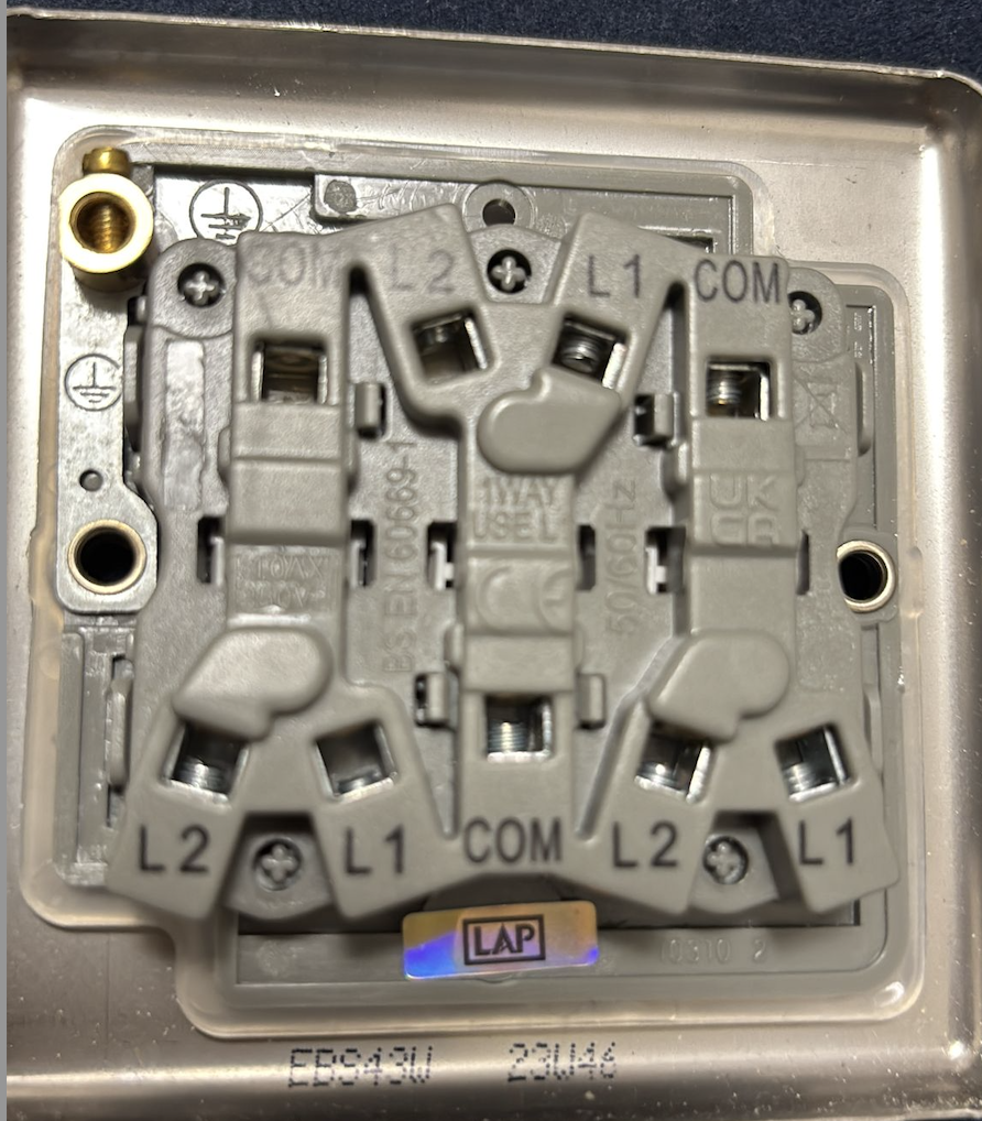

Thanks in advance.
Thanks for the replies.
I couldn't take the picture of the new one with the cables as had to revert back in panic as the two RCDs were tripped.
But what I did is just to use the below coding:
L2 old is L1 new
L3 old is L2 new
So, the brown ones connected to Com, black to L1, grey to L2 and one brown to L1 in the down row as it's connected to L2, as per above picture.

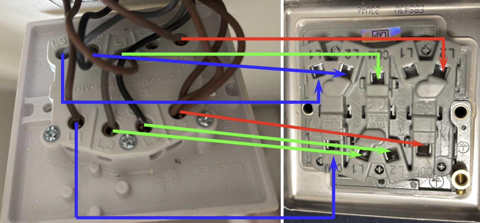

Did you?

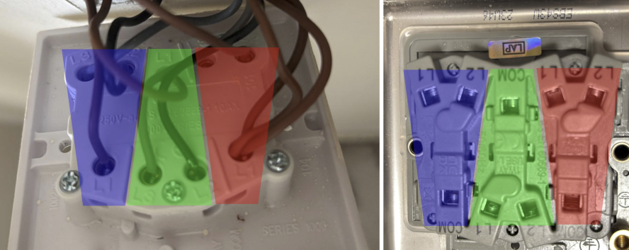

Getting L2 & L3 mixed up won't trip RCDs.
Putting wires from 2 different circuits in the same switch section will.

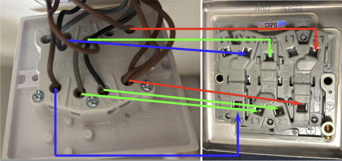

After the above gr8 advice, good that there was no fuse trip and I was able to use the first and the last switch without any issue but the middle one is keeping the light on. I used the old switch and same issue is replicating there. I matched the cables many times but not seeing any difference from the original one (which I captured the snapshot before I was changing the switch in which there was no such issue), so all 3 cables (grey, black and brown) are intact but still I can't turn off the light. Any suggestion please?
I would say the switch is faulty but you say when you use the old switch it is doing the same.
Does the light go out if you remove the brown wire from the switch?
Put the brown wire in a separate connector before switching the supply on again.
Yes, after removing the brown cable it turned off. I moved it to another connector but it didn't turn on there.
I meant a separate piece of connect block to isolate it so that it doesn't short on anything or give you a shock while removed from the switch.
Anyway - put the Brown back in L1 and swap the Black and Grey In L2 and L3.
Now what happens?
Thanks for the suggestion but I don't want to play further as last time I swapped L2 and L3 and it was a fuse trip :)

Then you must have swapped L2 & L3 between switches, not within.
No, I didn't swap the cables between the connectors. I followed the rule which I quoted in my first update i.e:
L1 -> Com
L2 -> L1
L3 -> L2
But these were done within each connector - but then both the RCDs were tripped.
