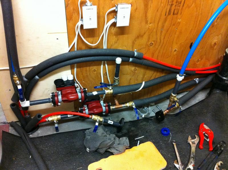

Dan_Robinson: well your guys were partly correct
i just found out that i had 2 problems on the same loop
( the not working GEO loop )

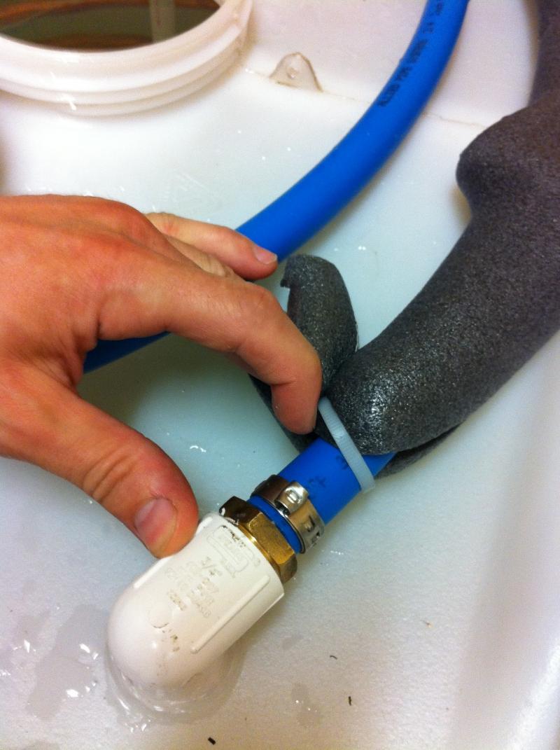

as the "crimp" ring was not set on the pex ( we have to change it over
to move the reservoir a few days ago ..probably forgot to crimp the new one after assembly )
and at the top of the line, the tubbing i used was leaking
( inside the tank, up from the water line ..so i was getting some air in the line all the time ... )
i used some cheapo 2 piece over pressure tank spoiler tube ...which seems like it was not tight fit by the company, will have to replace the 2 other i used later ..
now all 3 pumps are working 100% !!!! what a relief !

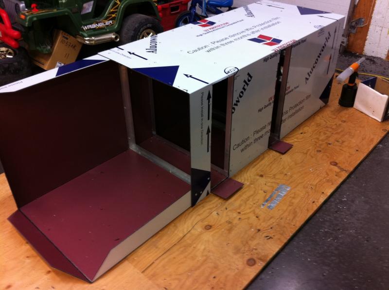

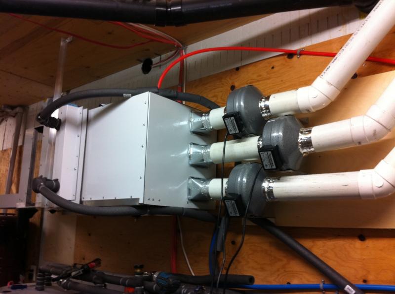

ac half box making ..space for up to 5" filter and the 20"x20" radiator ( 2"thick )
box installed with the water connections ..
had to modify the connections as i had the inlet on top and
i thought it might be hard to remove air in system ..so reversed the order
and now the water gets in by the bottom connection , and goes out through the top

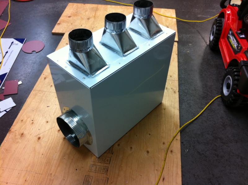

3 4"VORTEX ( made in canada brand ) fans on 4"bnq pvc pipings
that go to kitchen, dinner and living room

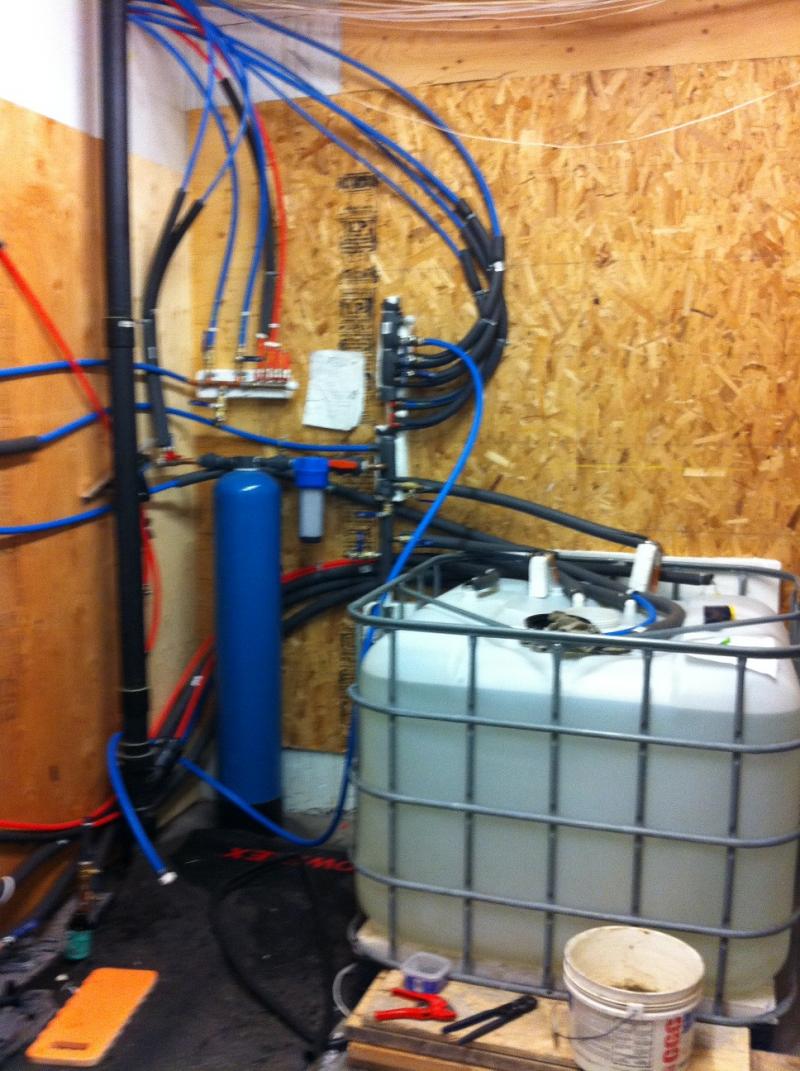

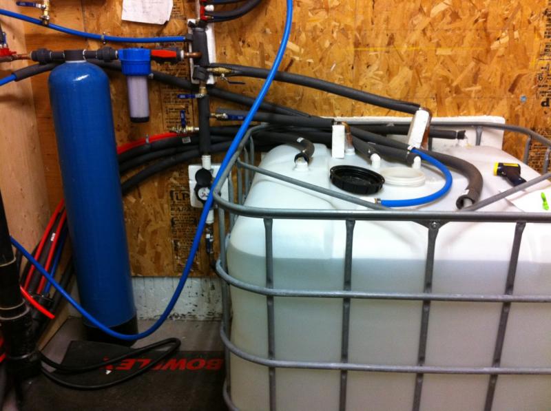

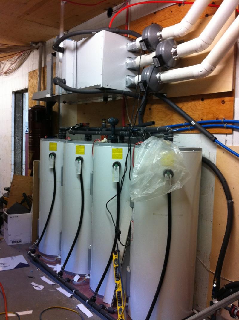

water system near ac reservoire
my water heater under the ac

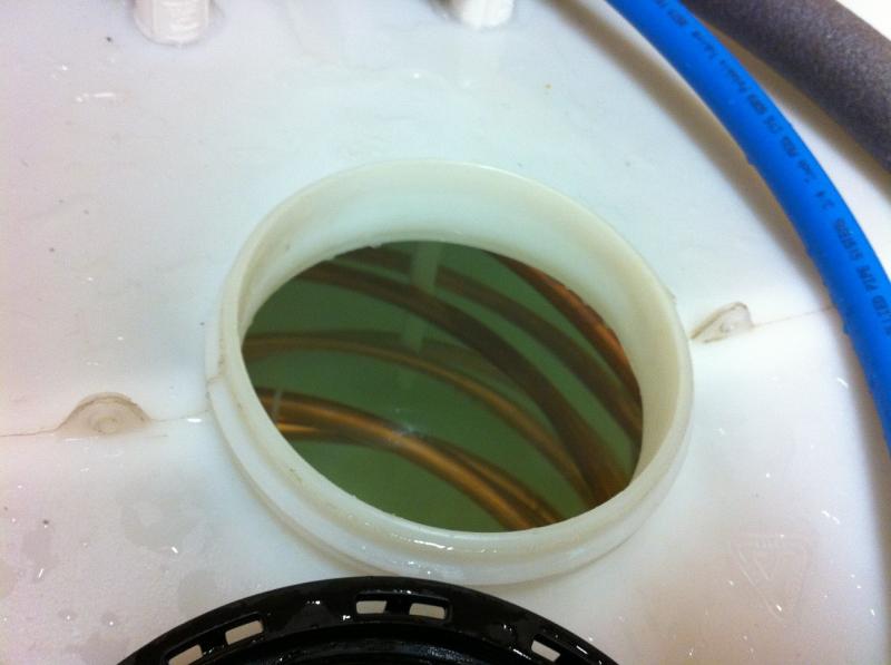

3/4" coil pipe in the reservoir ...was a PITA to get in without a bent ..
the crimp that was not set on the geo pump line ..+ i replaced this pvc elbow as the tube below it was not sealed properly and let air in
now it is a sweat fitting with a pex going down half depth of reservoir
