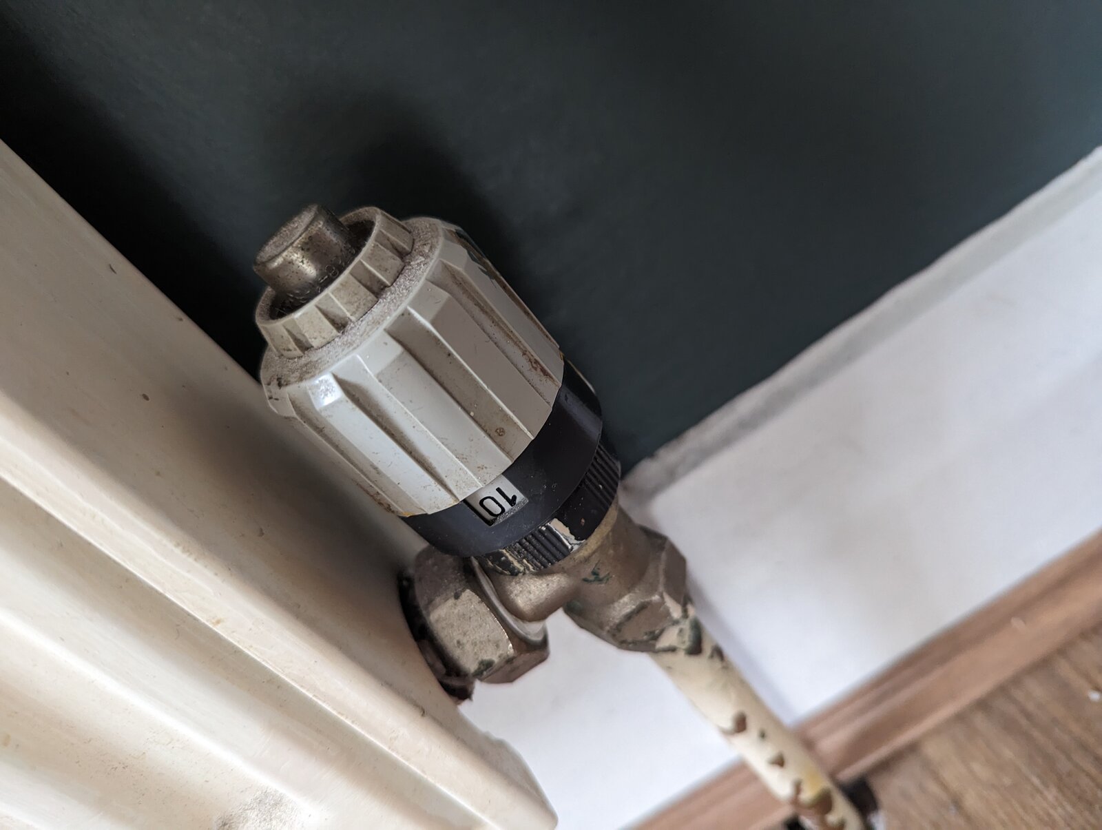

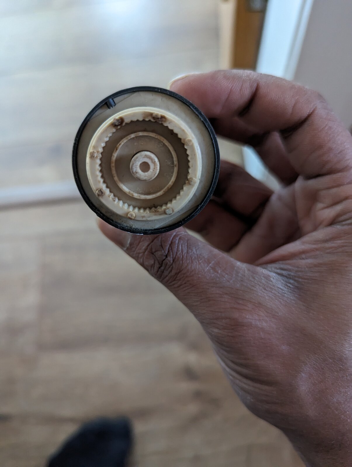

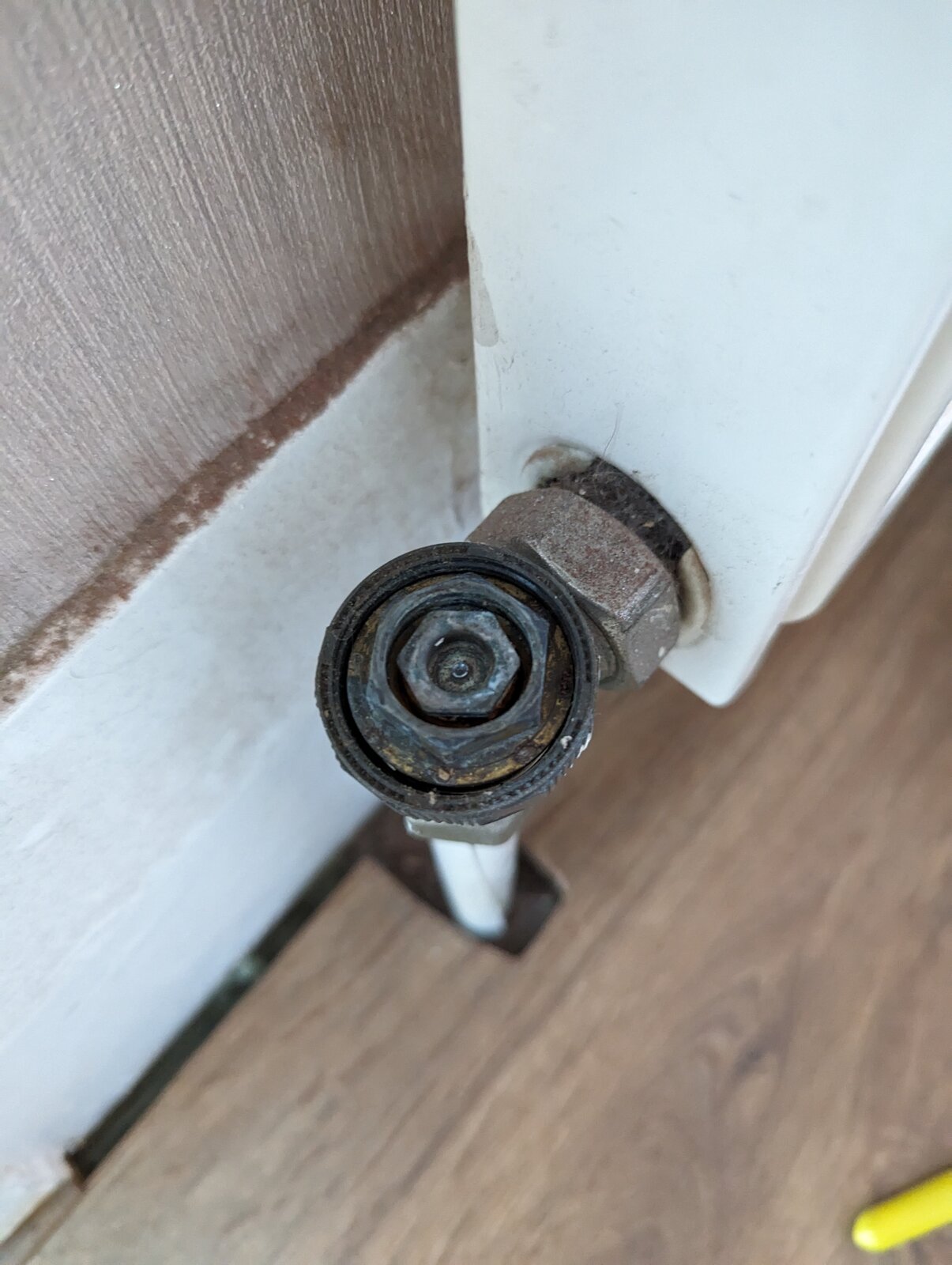

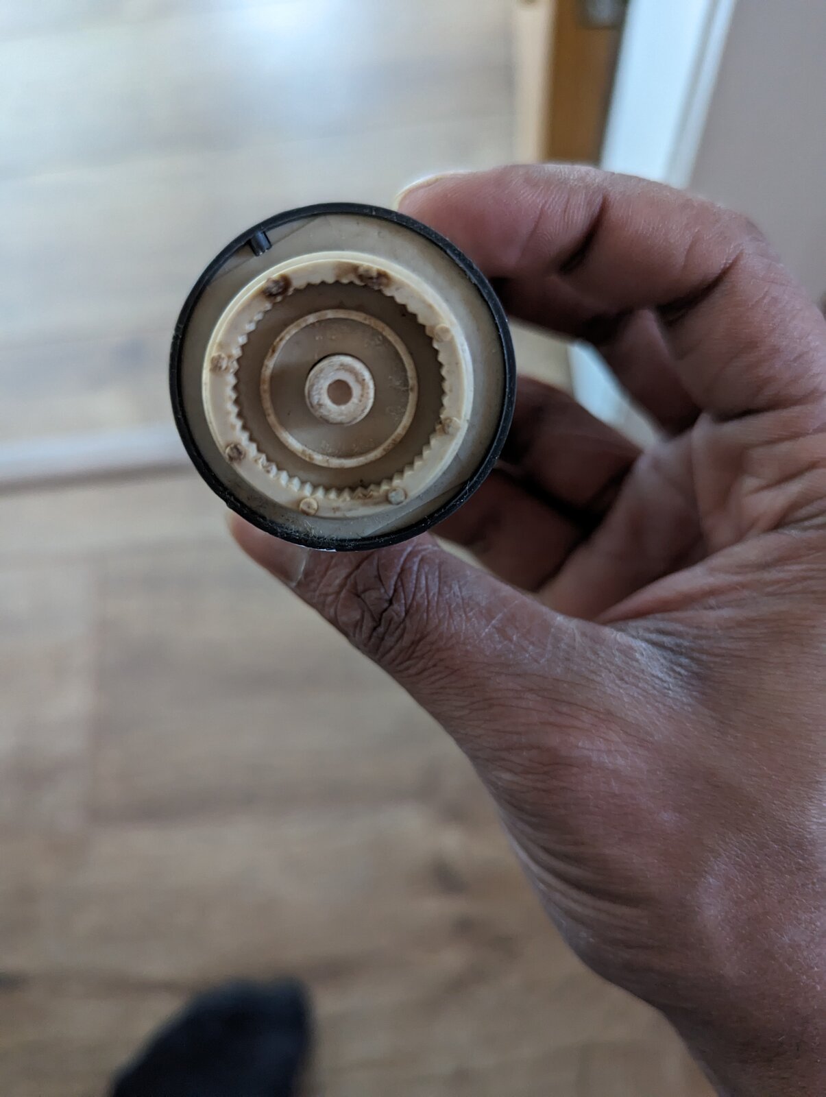

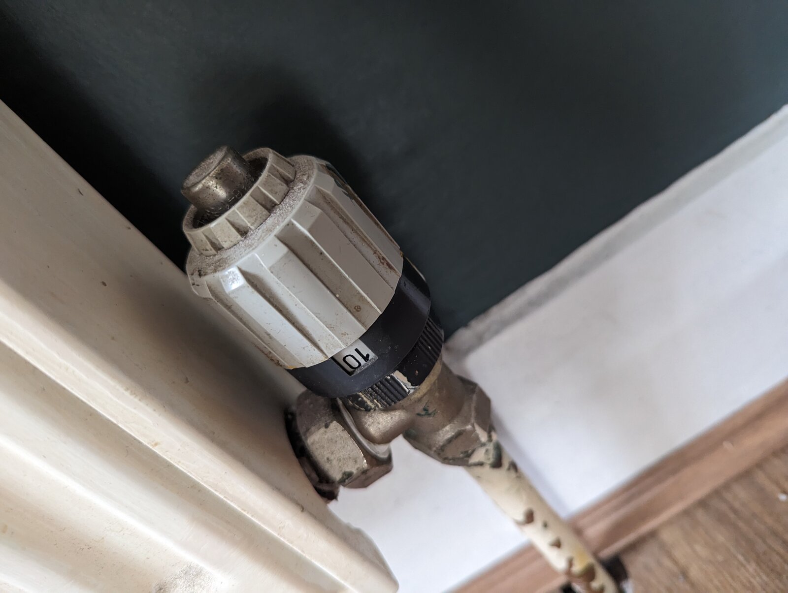

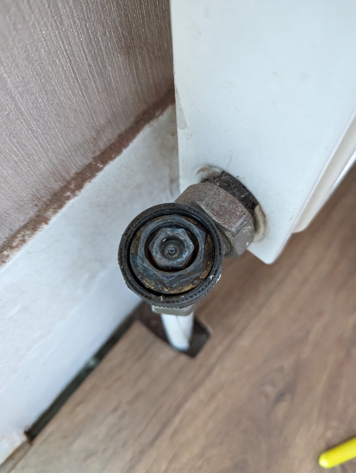

Hi,
Hope someone can help me figure out how to connect Kasa smart TRVs to my radiators. I've not had any experience with plumbing, barely know to how to a radiator so please bear with me.
I'm attaching pictures of what the current TRVs that I have all over the house look like and what I see when I take one of them off. 3rd pictures is the under side of the TRV. If it helps, it says Constana on top.
The bottom part of the TRV doesn't come off either, the part you have to loosen to get the thing off, unlike most other trvs I've seen on youtube.
Here's a link to the Kasa trv on Amazon, it comes with multiple connectors/adapters but I haven't been able to get any of them to fit mine.
TP-Link Kasa Smart Radiator Thermostat https://amzn.eu/d/3vltNxU
Thank you :)

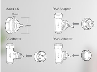

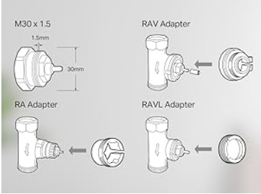

There’s no link? They look like standard type trv’s, so should accept smart ones. If not, then I’m sure an adapter would help overcome.
Today the standard thread on a TVR head is M30 x 1.5 mm, there is a kit with the head for some other TRV types, but older TRV's had a larger thread on the heads, your link does show which size of TRV they will fit

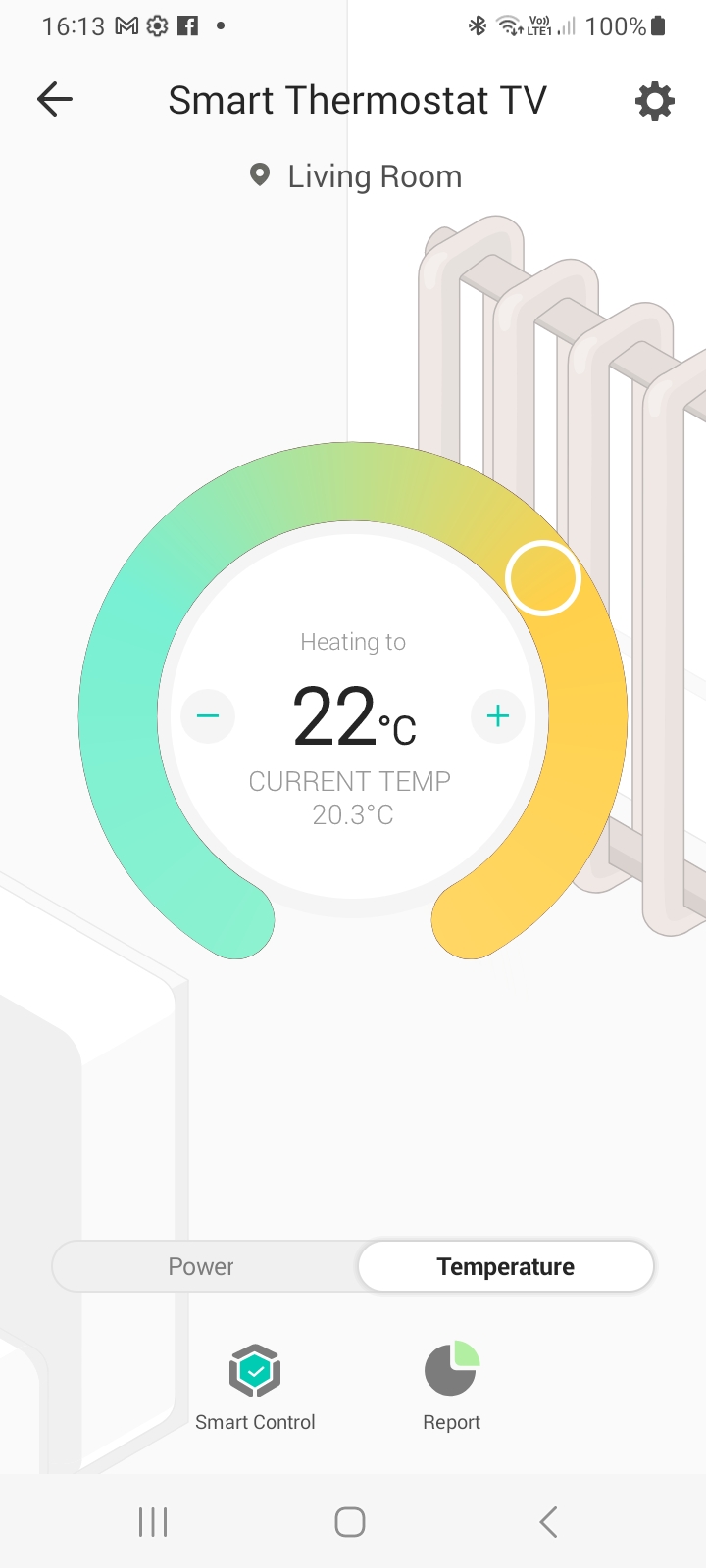

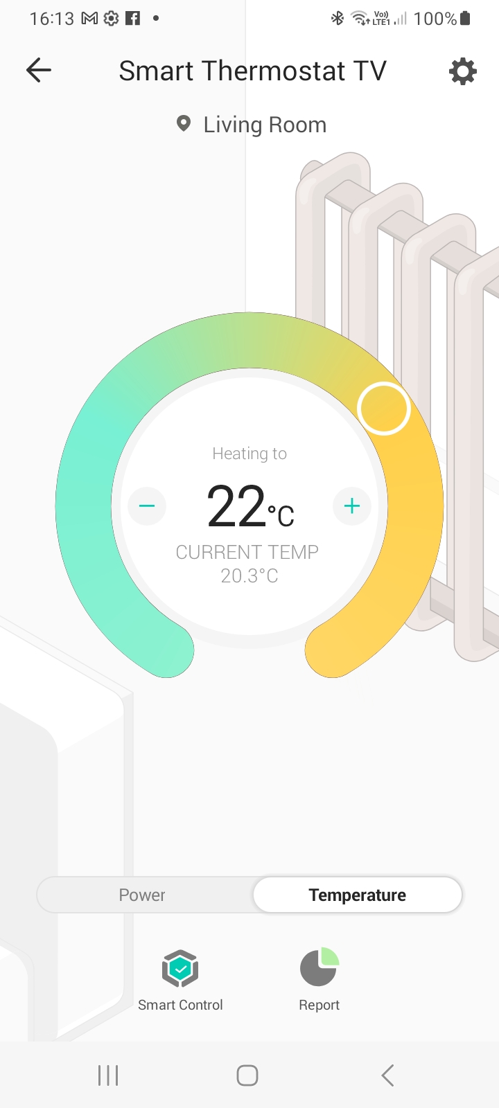

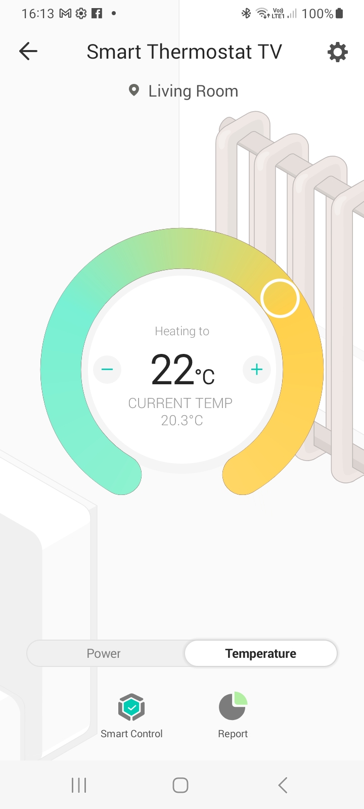

looking at your TRV base likely it could do with changing anyway. I simply unscrewed old head and screwed on the new one then set the schedule. Screenshot_20231017_161317_Kasa.jpg What I want to know is where one gets a compatible thermostat/hub? Found this 1697688267432.png but it's Tapo not Kasa, I have got the Tapo push button to work with the Kasa hub, they are both TP-Link, but my TRV only shows on the Kasa app, it does not show on Tapo app, so interesting to find out how you get on with them.
Today the standard thread on a TVR head is M30 x 1.5 mm, there is a kit with the head for some other TRV types, but older TRV's had a larger thread on the heads, your link does show which size of TRV they will fit View attachment 317564 looking at your TRV base likely it could do with changing anyway. I simply unscrewed old head and screwed on the new one then set the schedule. View attachment 317565 What I want to know is where one gets a compatible thermostat/hub? Found this View attachment 317566 but it's Tapo not Kasa, I have got the Tapo push button to work with the Kasa hub, they are both TP-Link, but my TRV only shows on the Kasa app, it does not show on Tapo app, so interesting to find out how you get on with them.

Anyways, going back to my old trvs, you're right, I'm probably better off just replacing the base/head. I'll see if I can find a step by step guide on here.

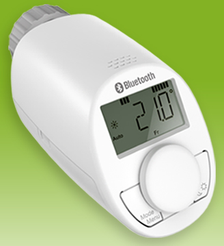

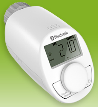

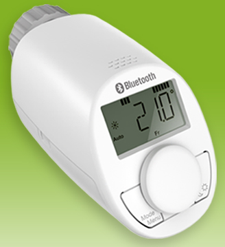

Nest USA have linked temperature sensors, but these to date have not been released for the Europe version, I use eQ-3 TRV heads upstairs and in kitchen 61dmtMm13BL.jpg these stop the rooms overheating, and work well as stand alone units, linked to one phone with bluetooth, but that means either my wife or I have control, not both of us. They were very cheap before brexit, I got them for £15 each, I have 5 of them, but the price has rocketed, the Terrier i30 is about same price now, but without bluetooth. One Energenie was smashed by carpet fitters, so I wanted a replacement, and preferred the idea of internet control, I already had Tapo stuff, so seemed good idea to use TRV's from the TP-Link stable, however reading what it said the TRV's are Kasa and use a different hub, not what I wanted, but still went for a new Kasa TRV and hub.

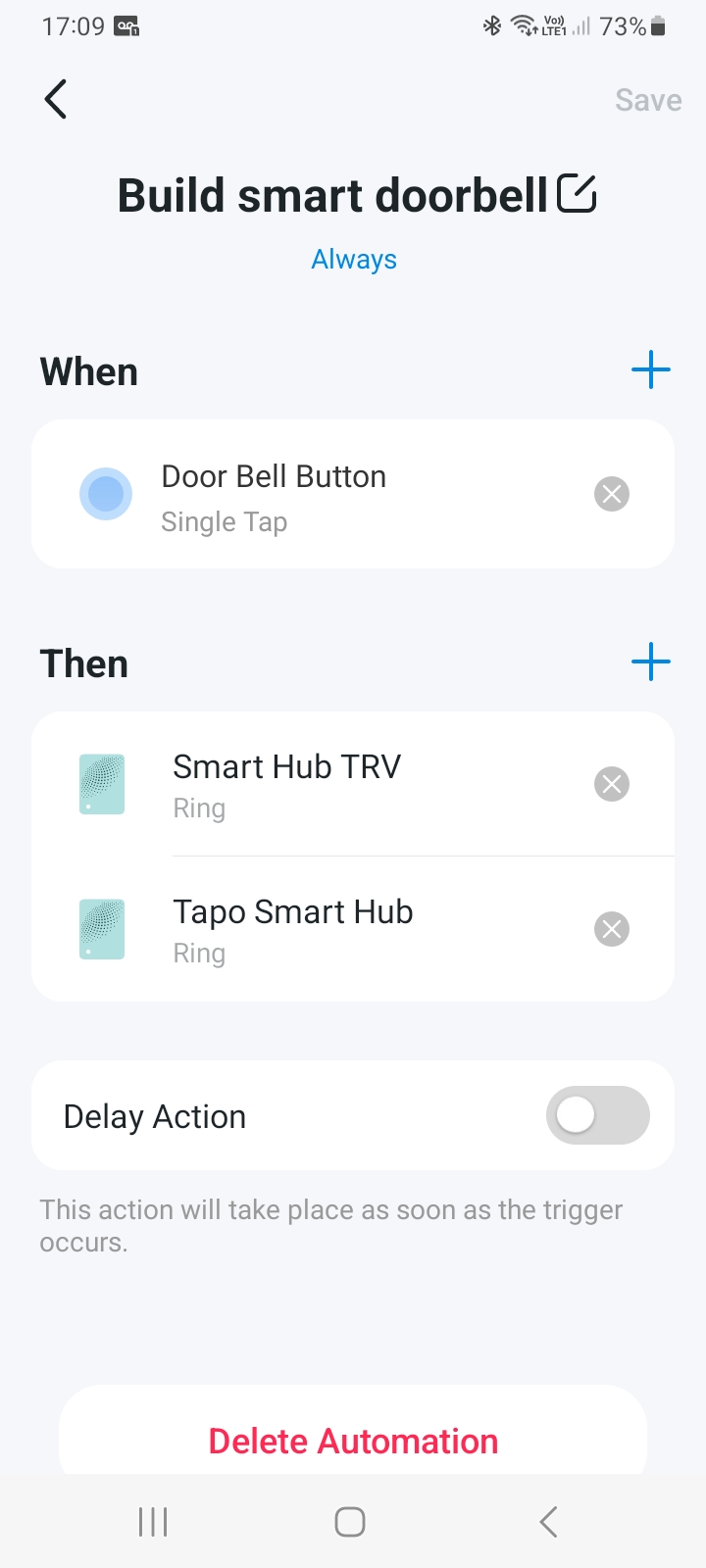

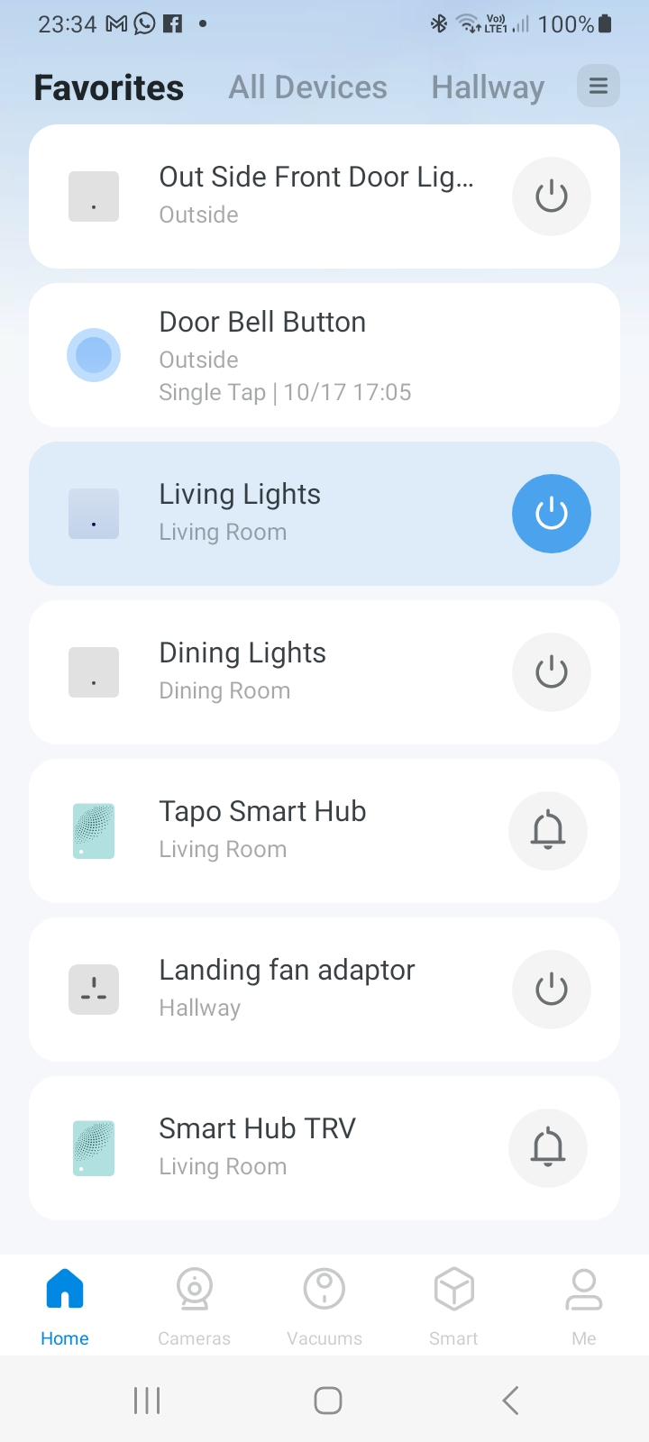

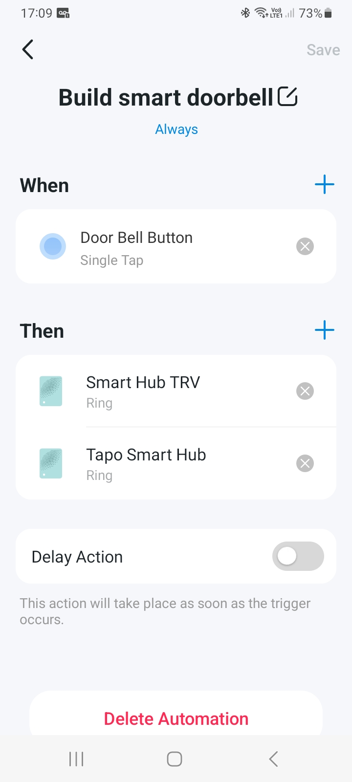

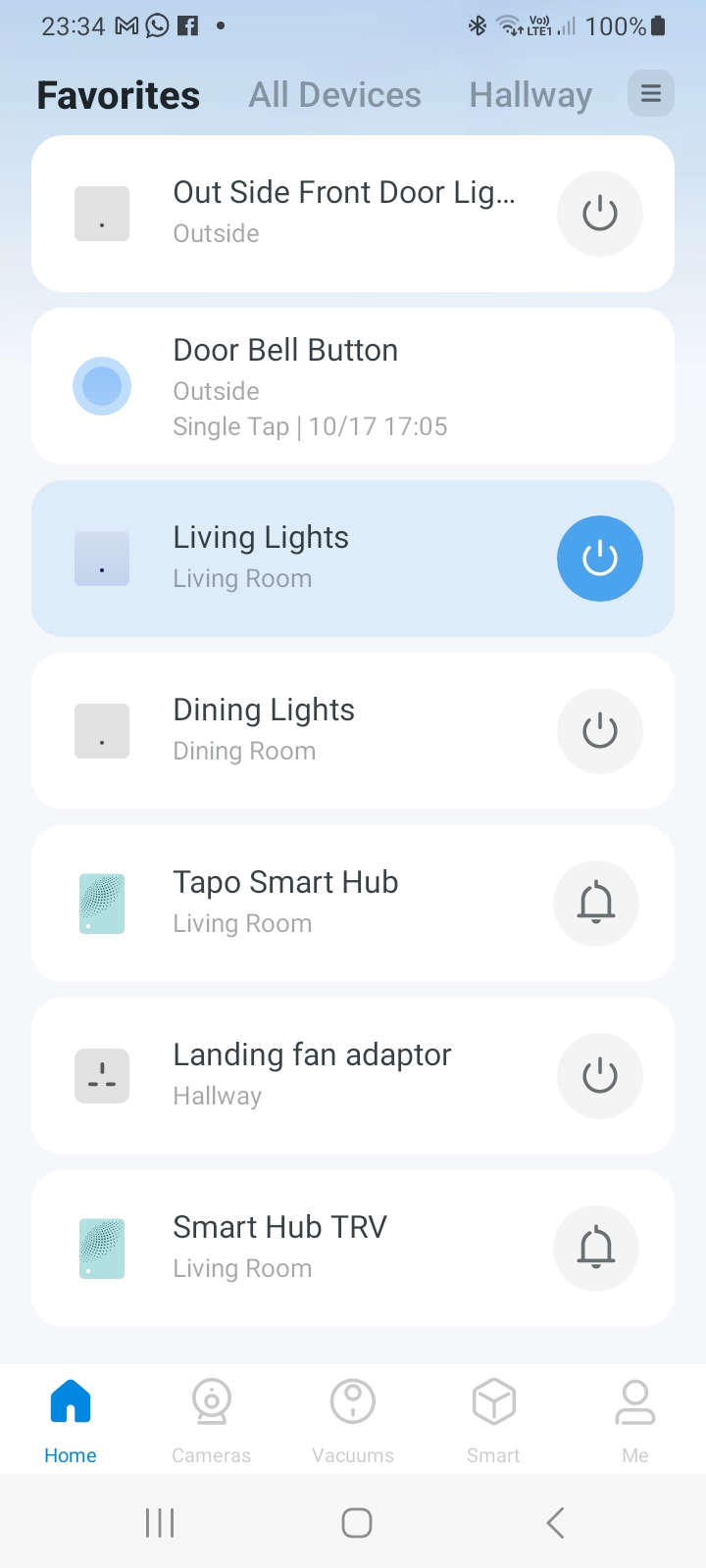

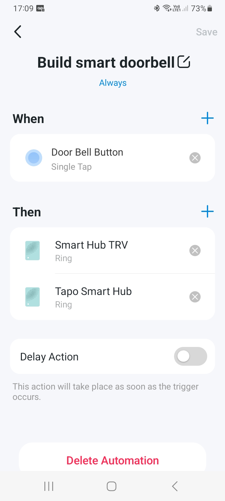

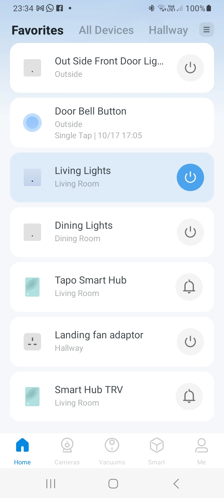

I have the KH100 Hub (Kasa) and H100 Hub (Tapo) and both the Kasa and Tapo apps, the Tapo app shows both hubs,1697754943343.jpeg but not the TRV, I found using the app was not the easiest, and to change what the door bell button did I had to remove it and then put it back, the door bell function seems to have gone from main menu, in the end I got it Screenshot_20231007_170929_Tapo.jpgand both now do ring, but can't remember how I did it, so am leaving well alone.

Nest USA have linked temperature sensors, but these to date have not been released for the Europe version, I use eQ-3 TRV heads upstairs and in kitchen View attachment 317684 these stop the rooms overheating, and work well as stand alone units, linked to one phone with bluetooth, but that means either my wife or I have control, not both of us. They were very cheap before brexit, I got them for £15 each, I have 5 of them, but the price has rocketed, the Terrier i30 is about same price now, but without bluetooth. One Energenie was smashed by carpet fitters, so I wanted a replacement, and preferred the idea of internet control, I already had Tapo stuff, so seemed good idea to use TRV's from the TP-Link stable, however reading what it said the TRV's are Kasa and use a different hub, not what I wanted, but still went for a new Kasa TRV and hub.
After buying them and been running for some time, I got a notification that the Tapo software would now work the Kasa hub, and I have not got the door bell ringing both hubs, so one on landing and one in living room, but don't seem to be able to work the TRV from Tapo hub. As said the wall thermostat is Tapo not Kasa so not sure if they will integrate.

I have the KH100 Hub (Kasa) and H100 Hub (Tapo) and both the Kasa and Tapo apps, the Tapo app shows both hubs,View attachment 317685 but not the TRV, I found using the app was not the easiest, and to change what the door bell button did I had to remove it and then put it back, the door bell function seems to have gone from main menu, in the end I got it View attachment 317686and both now do ring, but can't remember how I did it, so am leaving well alone.

No camera, but the door bell does log when pressed. Works well but my door is sheltered so door push does not get wet.
