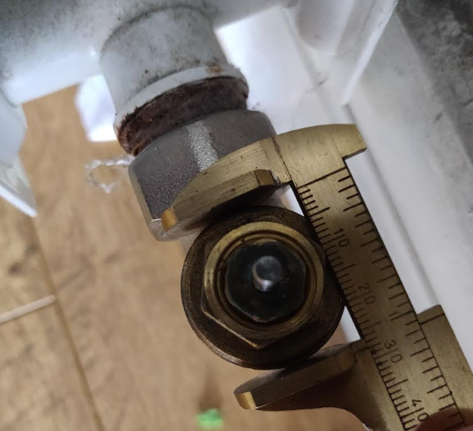

My house has radiators and hot water all heated by an oil boiler. They are there a while and nothing is zoned. Most of the radiators have TRVs on them but I was thinking of changing these to either programmable or smart TRVs to give me better control.
I am having problems working out what I need to fit new TRVs. They ones that are there are all Orkli and seem to be 28mm. The pipe into them is 15mm.
Please see the photos below
All new TRV heads seem to M30*1.5
So, I'm guessing I need some sort of adapter to put on my existing TRV bodies or else I need to change all the existing TRV bodies.
I'm not sure which is the best way forward here. Any advice is appreciated. The adapters are relatively expensive at £12 each and the TRV bodies have obviously been there a while.
It might be better to change them completely but do all new TRV bodies come with M30 connections?
