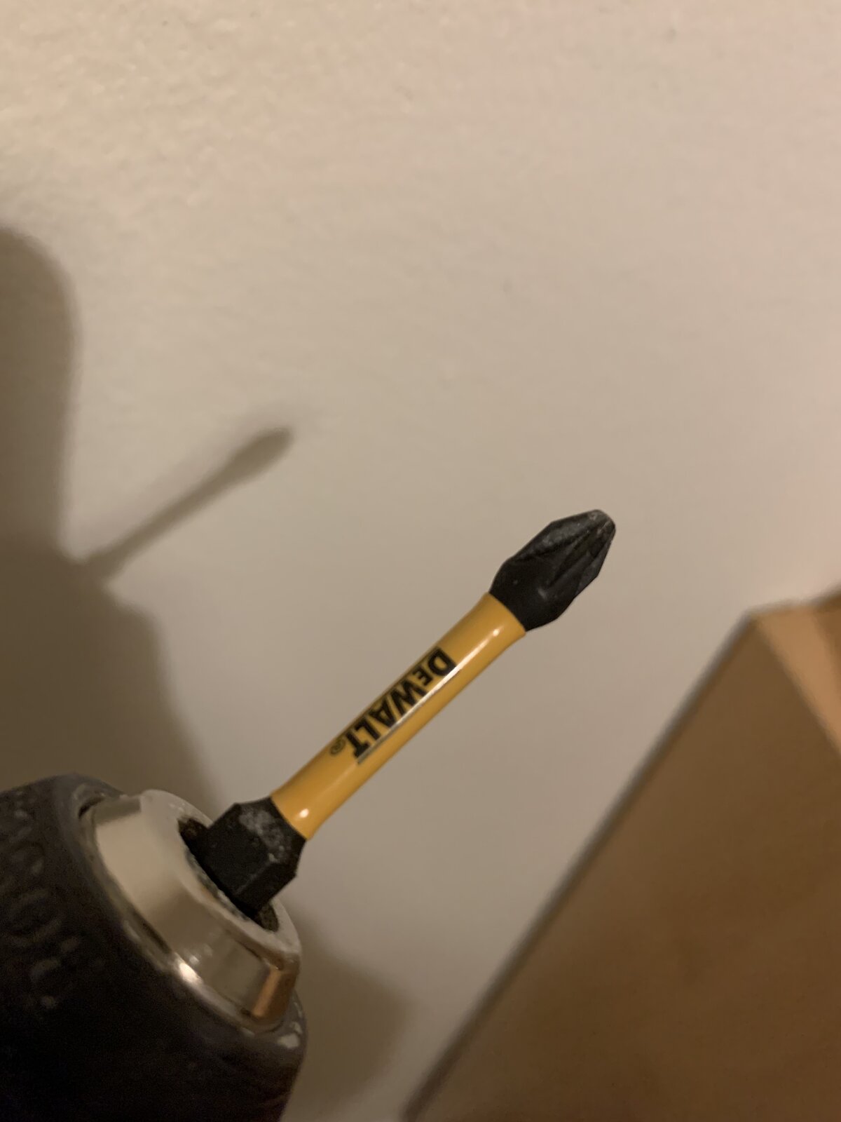

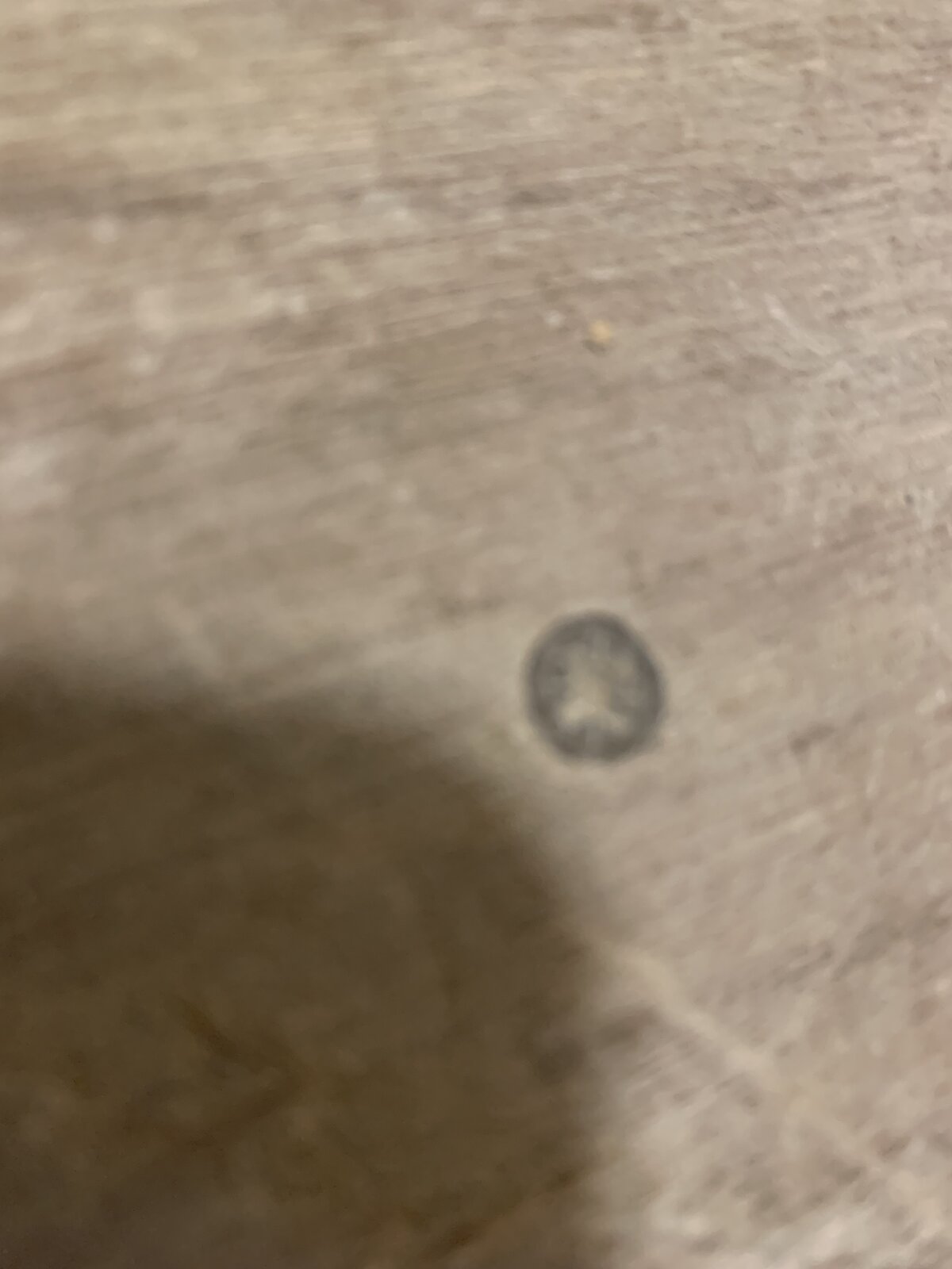

Hi All
I am refitting my bathroom and need to get up the old boards put down for the underfloor heating
but they are screwed down and nailed but they are rounding the head if I try to get them up, any ideas how I can get them up as the crowbar method isn't really working
thanks
please provide photos of the screwheads, and the screwdriver you have been trying to use.
photos attached thanks

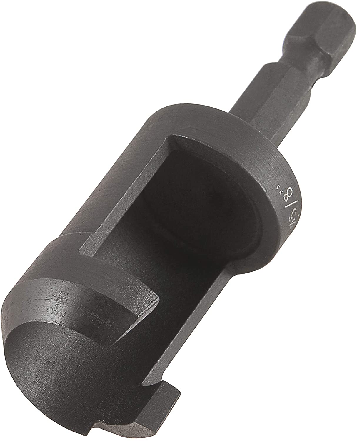

would a plug cutter work ?
Would need to be a tube type - the 2- or 4-prong versions can only be use in a drill press:
Run in reverse slowly for 2 or 3 revolutions pressing down hard, then forwards
thanks thats good to know , pity I didn't see it and after 10 holes I hit a screw not good

Looks like muck in the slot of the screw, although the photo is blurry, id recommend using an old tiny screwdriver or some kind of point to loosen the dirt, then vacuum it out, then use the screwdriver putting as much pressure on the back as possible making sure it's centred exactly, then try to loosen it.
Use a non powered screwdriver for better control. Tightening the screw first can help to release it. If all else fails chisel round the sides or use a small diameter hole saw to expose the head. Then grip the screw with needle nose pliers or carpenters pincers turning clockwise and counter clockwise until it loosens. If that fails use a crowbar but be prepared for the board to split and the screw to stay in place.
