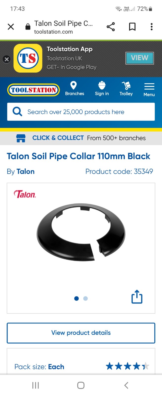

Hi, I need to make good around the 110mm soil pipe exiting our bathroom wall. It was just filled with mortar previously but as you can see, there is quite a deep/wide void to fill so would it be acceptable (or a complete bodge) to pack out the void with some expanding foam etc. before finishing off with mortar as before?
Any alternative options welcome. Thanks
Fill it with expanding foam then fit a pipe collar for a neat finish.
Foam - cut back - point.
