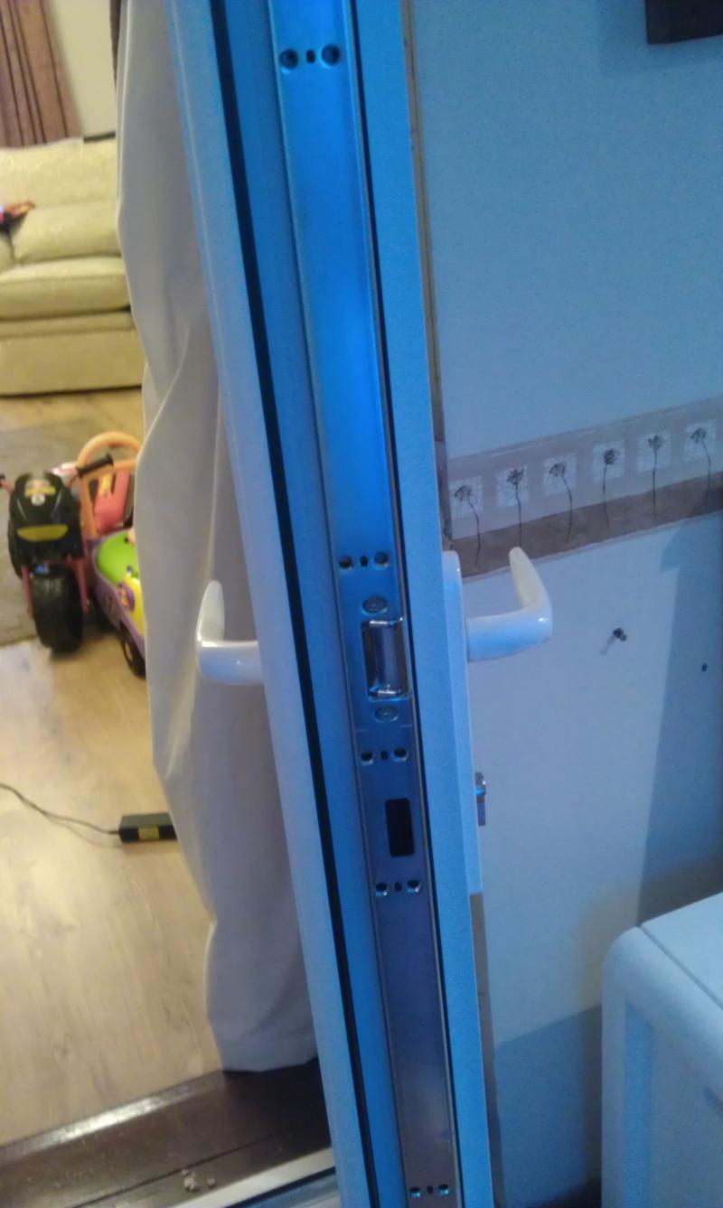

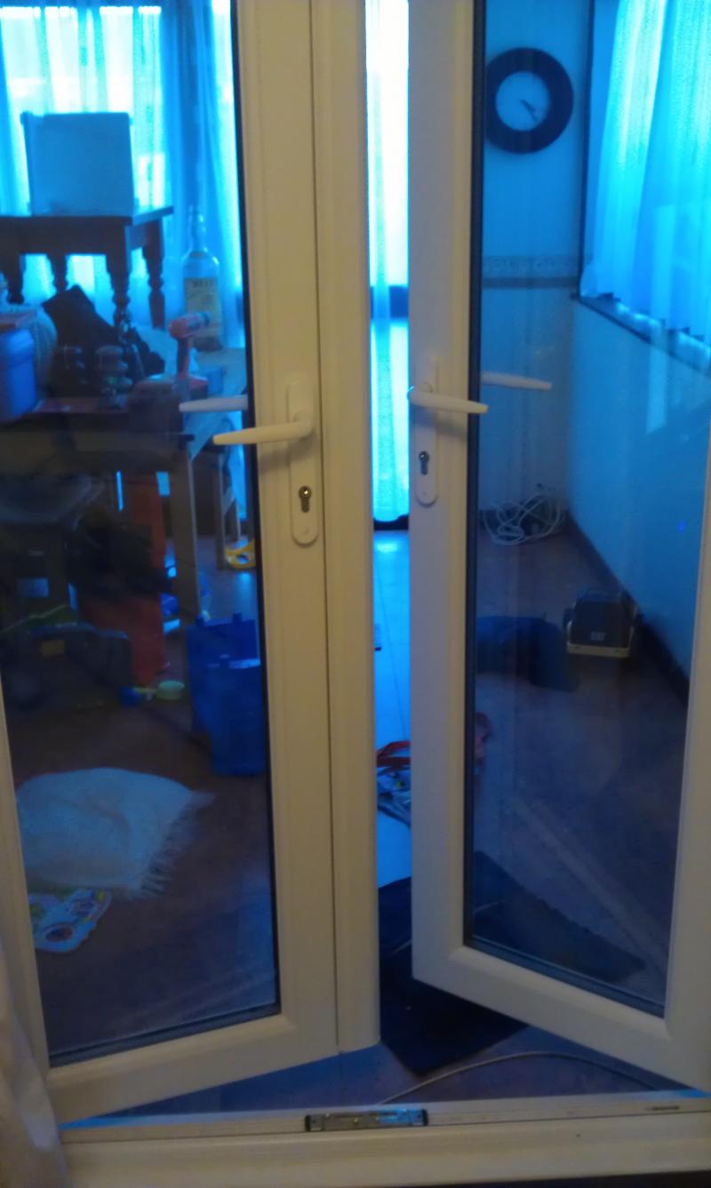

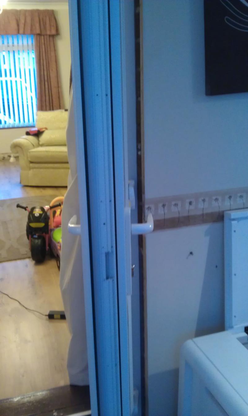

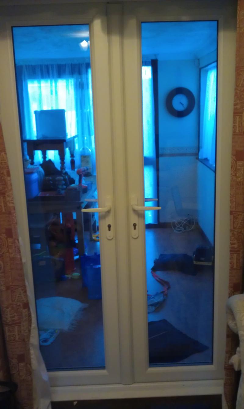

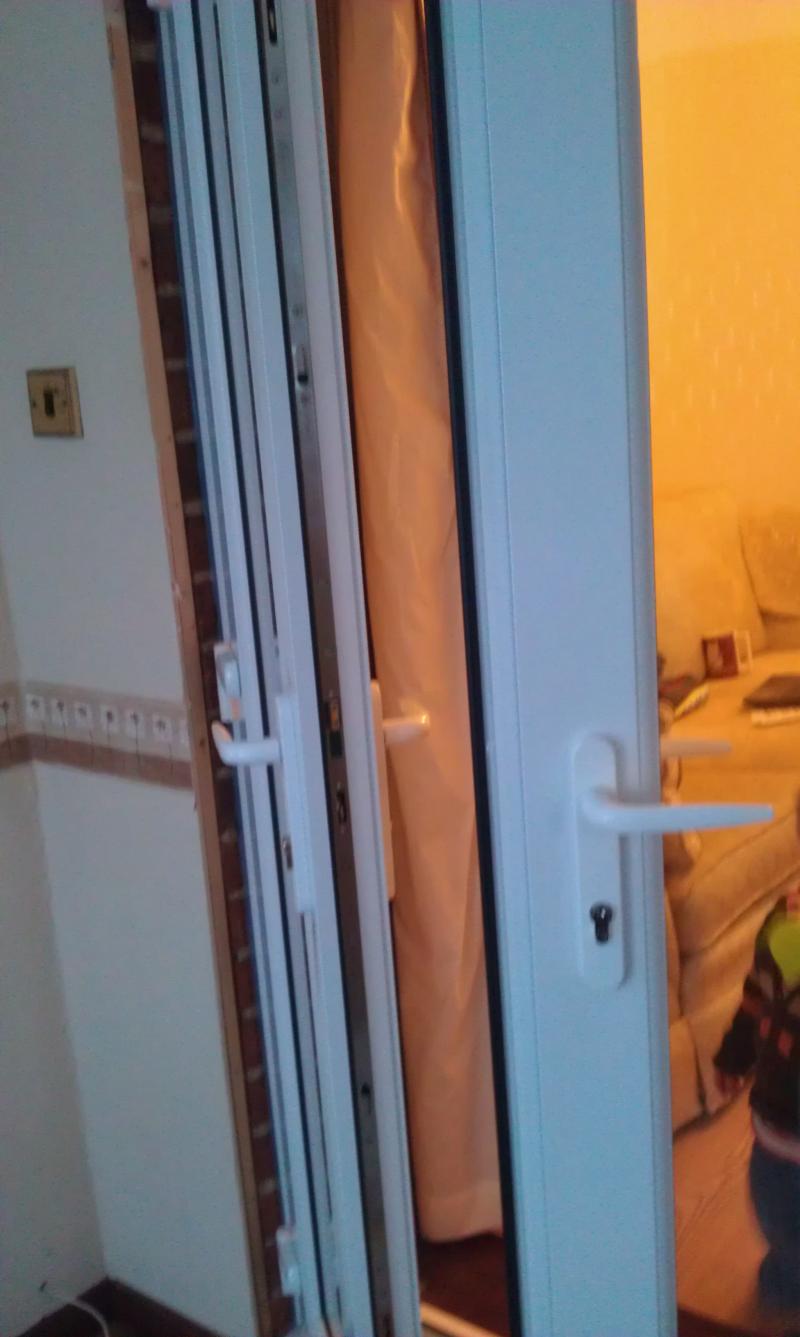

Now I've got that out the way I'll get onto my question...We've just moved into a house and need to make the patio doors from the front room leading to the conservatory open left side first (currently open right side first). It looks like if I was to remove the central strip and put it on the other door I would be able to open left side first, but, I have no idea how to swap it over. Any advice would be greatly appreciated.

If you're prepared for a bit dremmel(ing) then as far as i can remember it should be just a swap around.
The only thing i can think of that will be handed is the latch on the master door, hopefully the latch can be spun, if not then the mechanism is handed and then it becomes expensive, check if you can alter the latch first before going further, there may be a pozi screw going through the face of it, if so take it out and spin the latch. And also you'll need to move the shootbolt keeps over to the other door, these are the metal plates top and bottom of the frame
The flying mullion or the bit of plastic on the slave door is held on with 4 or 5 screws behind some screw caps
