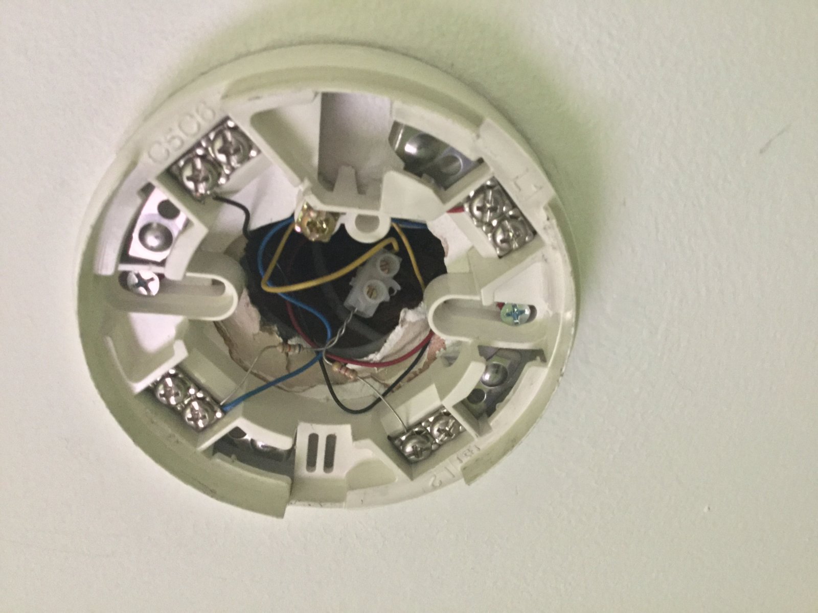

Need to know how smoke detector is wired
Photo would help?
If traditional 4 wire then just put wire link in that zone alarm pair and tamper pair,tamper could already be linked

I need the power supply to the smokes removed so I can take them down safely so I can replace with standalone alarms.

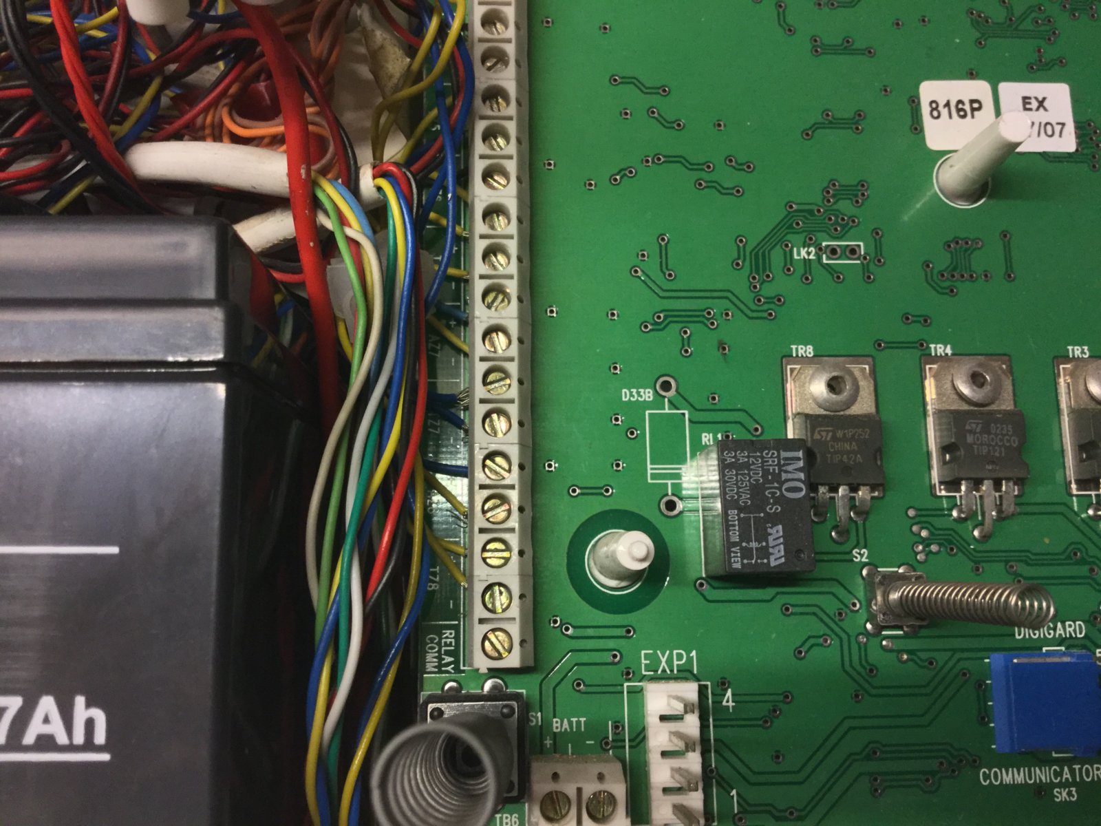

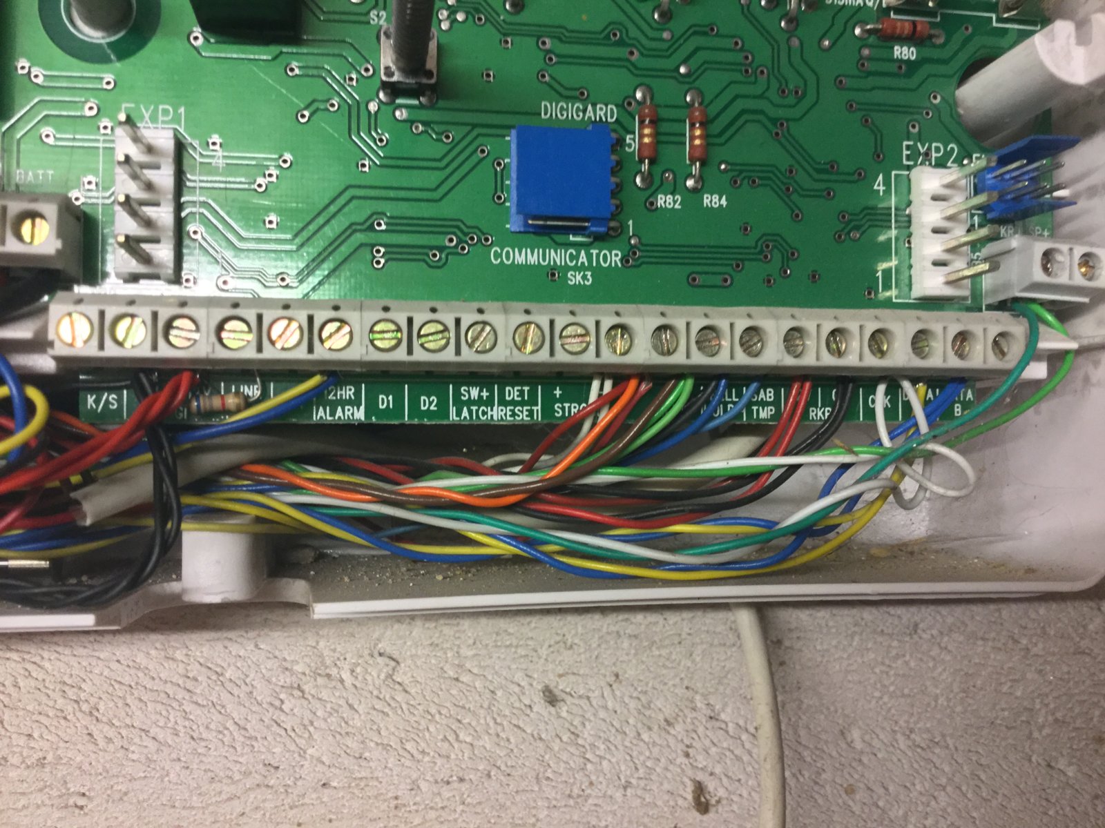

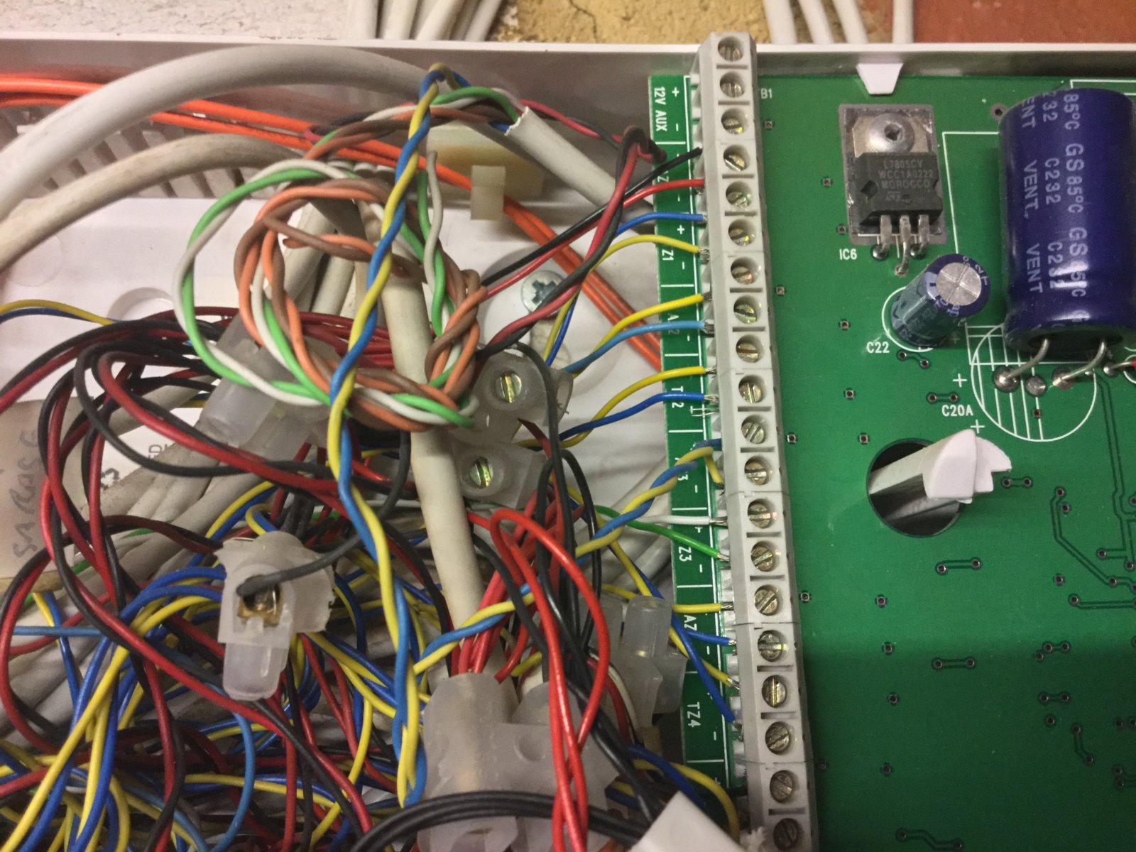

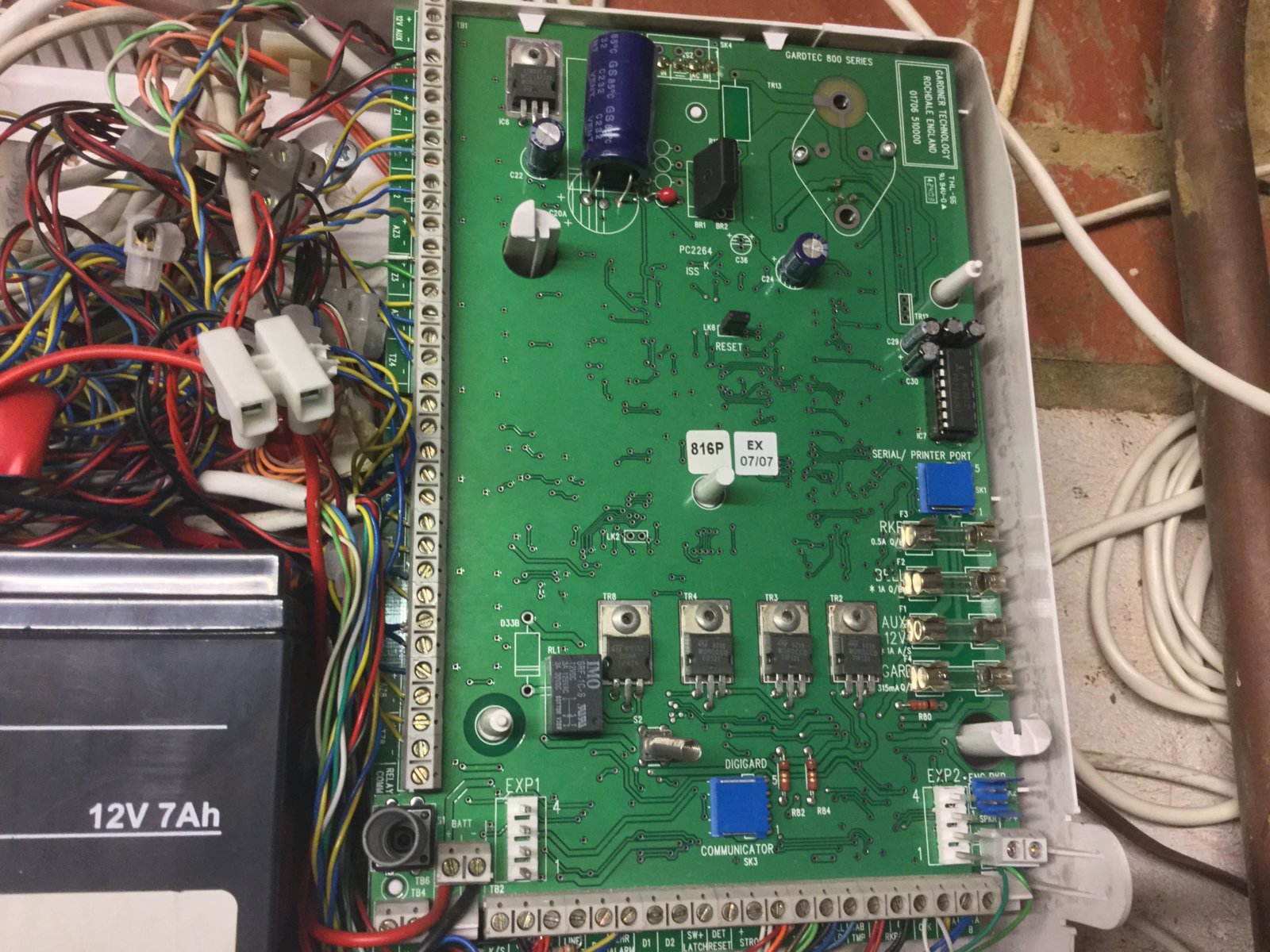

Not sure if the control panel has connections marked with zone numbers, if not what way can I identify the smoke connections ?
Take photo of alarm pcb wiring connectors.

Will take photo of alarm panel in a few hours when I get home and post.

Just remove the wires from T8 , T7, T6 ....put the resistor with the purple band out of the smokes across each empty zone T8,T7,T6

You say T8 T7 & T6 but there are 5 zones....12 &13 single smoke and 14,15 &16 Two smokes each....
Thought there would be 5 contacts to work on

Guess I was hoping I could simply remove the power connection at the ceiling smoke detector and tape up the other wires and push through into the ceiling.....although it seems I will have to do work with the resistors, which I will find difficult...
