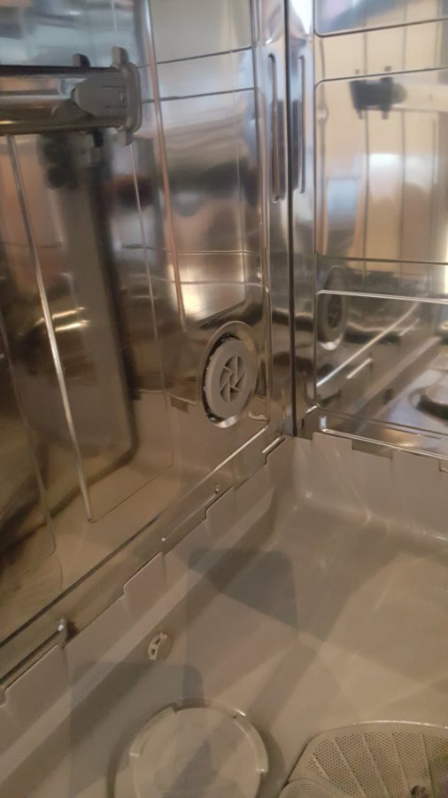

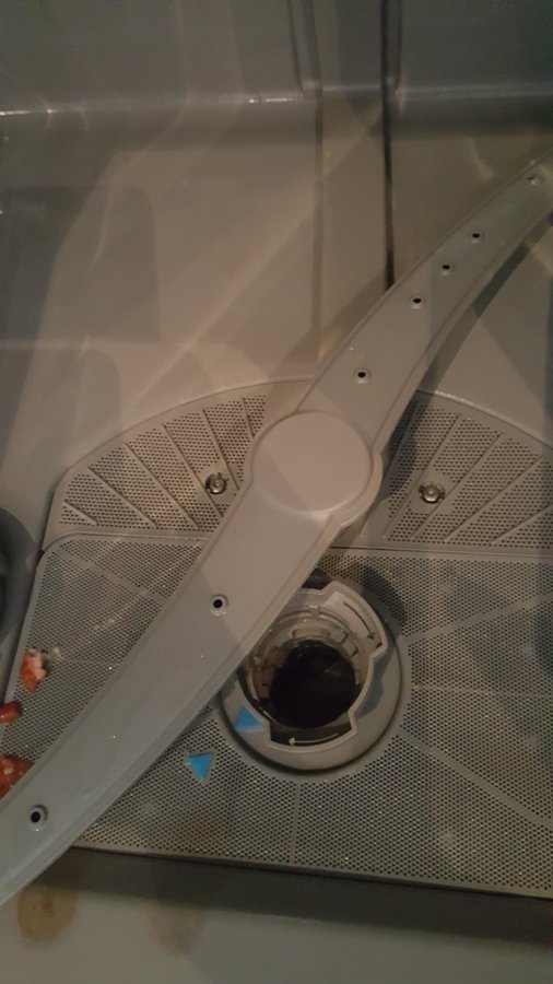

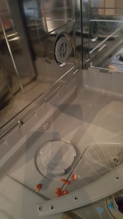

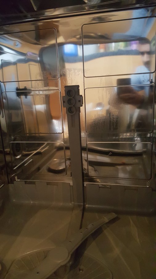

Hi there,
I have two problems with my Neff Dishwasher, see attached photos. Model: Neff S51E50X2GB Integrated Dishwasher.
Firstly it will not turn off, other than if I turn the plug off.
Secondly, water will not fill up.
2 symbols light up on the display - a tap symbol and a "flow" symbol.
Anyone know what could be causing this problem? As far as I am aware, no taps have been turned on/off.

Are the salt and rinse aid levels ok?
If so, try pouring a jug of water into hole at the bottom and try and run. If no luck it might be a faulty pump.
Tay7 - This worked. Thank you very much.
As you mentioned, I poured hot water down the hole. Then extracted any excess water using a small cup. Then Topped up salt and rinse-aid levels.
Appreciate your help.
I cleaned out the u-bend under my tap anyway and realised how much gunk there was in there! All in all, very useful. Have a good new year.
