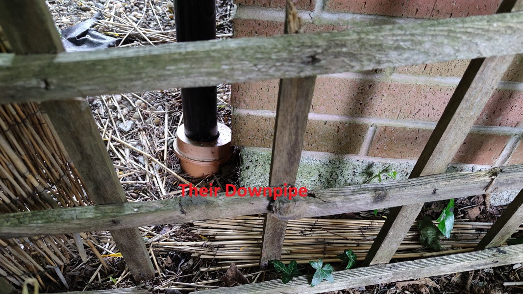

hi,

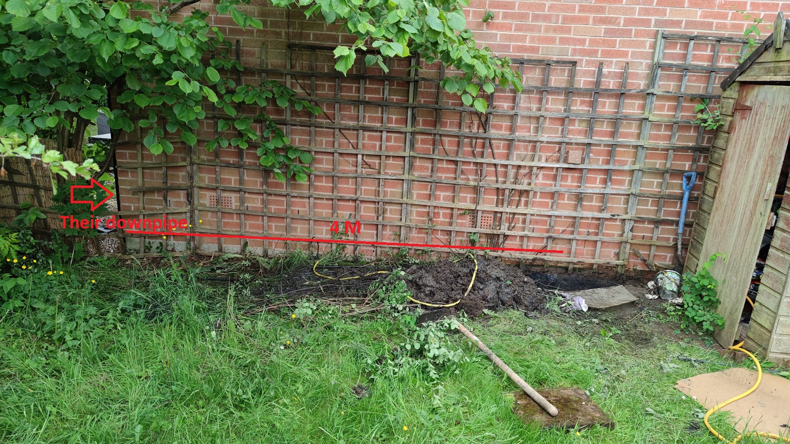

Ive been digging around in my backyard and found my rainwater pipe has been cut.
I followed the pipe and found that it has been cut right at their new extensions. I moved in after the extension. And new neighbors have moved in. But it looks like it has been cut to lay their foundation.
What can I do here?

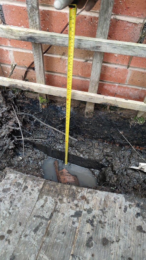

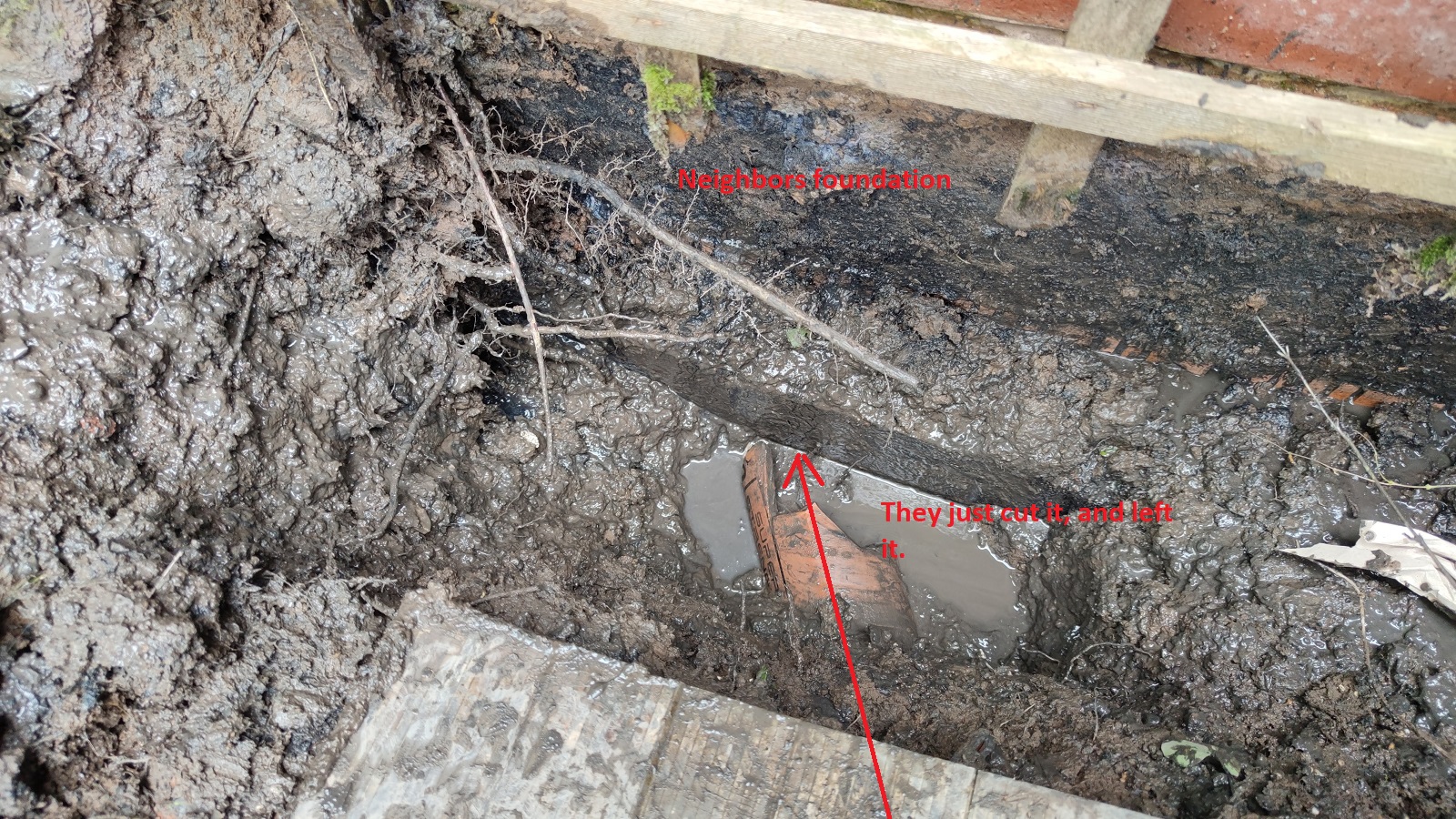

That is the foundation to their extension. The pipe is 60cm deep. It looks like they cut the pipe when digging the foundation to their extension.

Ask them to reconnect or reroute it and see what they say. You can point out that it will only undermine their foundations and could cause them serious issues down the line.
When it rains does water come out of the cut pipe ? It might be that the pipe took water from your neighbour's property into the drainage system of your property and onward to the main sewer.
When the extension was built it is possible that a new drainage system was installed and that pipe became redundant.

Yes water comes out. This area was always damp, and when it rains heavy there's a a stream, I assumed it was an overflowing gutter.

good point above. it could be their pipe been terminated. check first.

your rainwater should discharge into a soakaway on your land min 2 metres from boundary and min 5 metres from house foundations.
I think your best way forward is to find a solution on your property.
