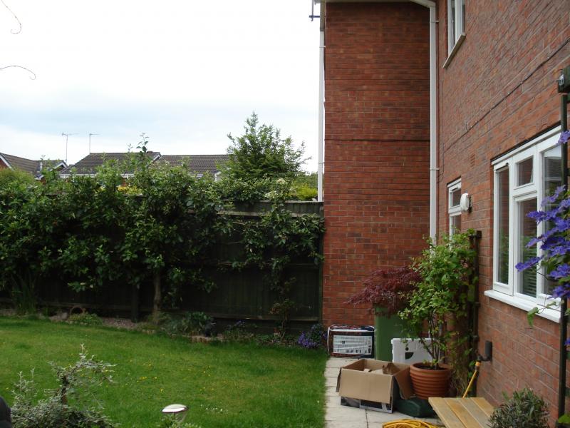

This is the side where the window will be.
If the building/extension is in line with his house - the guttering will overhang into my garden too - is this permitted as well??
no part off his building can overhang your property during or after construction without your permission
