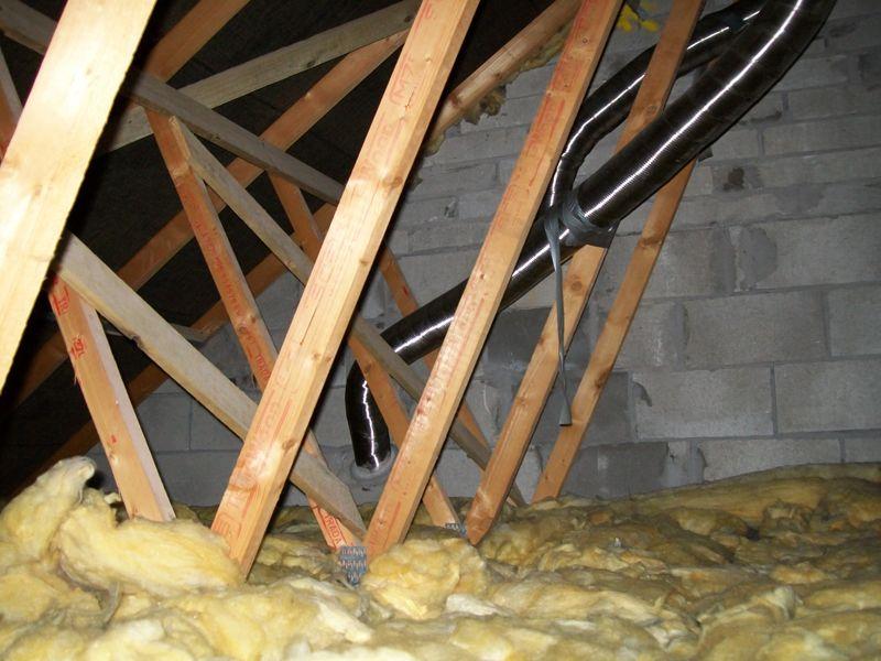

Neighbours gas fire flowing through flue in my property!
I think a pic or two showing the problem is essential, and the sooner the better.
If the RGI has to visit your loft, it's a big no no, quite apart from having to repeat the trip every year to inspect the flue with the service, there's a risk to you from the products of combustion as well as fire.

If that were the case he wouldn't have had to ask the neighbour if he could go in his loft.
Be interesting to see how the ridge tile is connected to the precast flue.
Just read this paragraph.
My neighbour asked was it alright if the fitter went up onto my side of the roof to check the vent, to which I said fine. Week or so later, neighbour called again and said because of this crossover flue issue, the fitter wanted to go into my loft to check that there was no issue re leaks etc. As far as I know, there are just breeze blocks separating the two loft spaces.
"As far as I know" does not sound very positive.
Pics would be nice!
Probably the builder cocked up and connected the flues the wrong way round. :roll:
Interesting a simple query has gone to two pages of prevarications.
The chimneys will be running side by side. How elese is the chimney supposed to rise in a chimney breast where two fires are fitted to a single wall?
The connection to the ridge tile will be cast or some other form. Issue here has been grasped by Doitall in that someone has connected the chimney to the wrong ridge vent.
Furthermore, it is not that the fire will not work (of course subjects to checks being satisfactory) but access to neighbour's loft space being mandatory when fire serviced.
Point I would make to the OP, why not get the installer to switch the connection to the ridge vents and all will be resolved. :)
My guess would be that the cast block/adapter breaking the flue out of the wall has been put the wrong way round - bricky just plonked them on without double checking. So the OPs flue goes through the neighbours loft, while neighbours flue goes through OPs loft.
