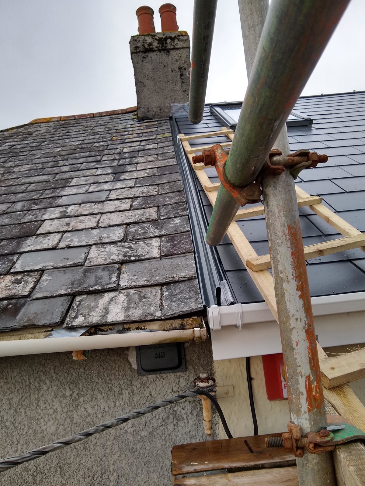

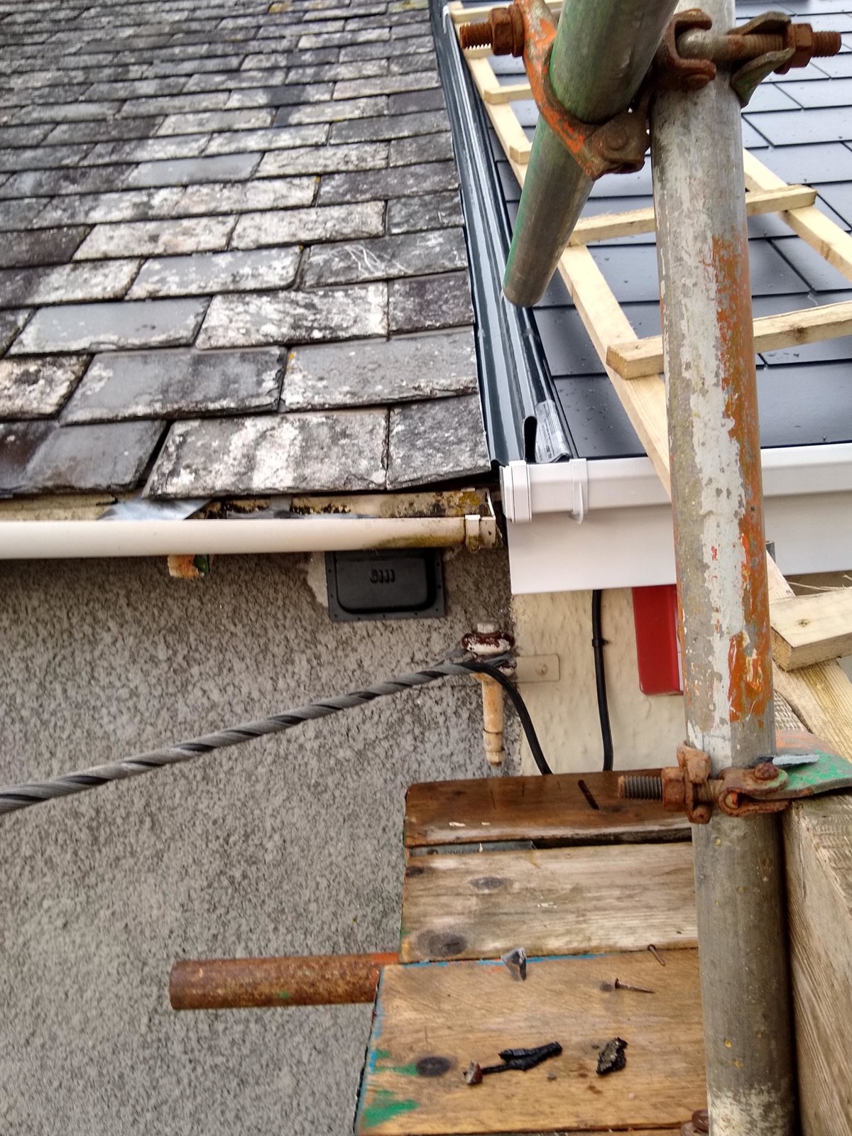

Sorry for the delay but here's the external view
No wonder you think it looks ugly - the tiles normally go over that lip so you only see the upstand.
Its not sitting down low enough, Im not sure why.
The tiling battens should have been cut leaving 75mm gap all the way up and filled with mortar -fire check, was that done.....
Hopefully one of the roofing pros here will advise.
Sorry for the delay but here's the external view. Waiting for weather and permission to climb up the scaffold to inspect.
A picture paints a thousand words is my first thought. Neighbours are reasonable but I don't think they are too interested in the problem that has been imposed on me to be fair.
That gutter left dangling should be attached to what was an exposed party roof rafter, now covered & taken over by the neighbour's new guttering, soffit & facia. So the party centre line is just about where the bonding gutter upright is.
As a point of interest three doors down had just the one side converted & re-roofed too, but they managed to merge old and new tiling together successfully without using a gutter.

I use these bonding gutters on a regular basis and this is done wrong and will leak eventually. The slates should be as close the the central up-stand as possible.
These bonding gutters have 2 lips in them on each side and both are supposed to be covered.
https://gyazo.com/acc0579bf7c5869f5424a17132e055c0 - this is how they look, so the way yours has been done the water will be able to blow in.
It should be done like this - https://gyazo.com/fcd53a0aa0a417fa4ec4dbc8afd37acb

The roofs are in the same plane so why couldn't they do that here :?: They obviously weren't bothered about leaving your gutter hanging too far over the support bracket. People shouldn't carry out these works without proper consideration for their neighbour's property . Just to confirm there should not be a clear open gap on top of the party wall it should be firestopped.

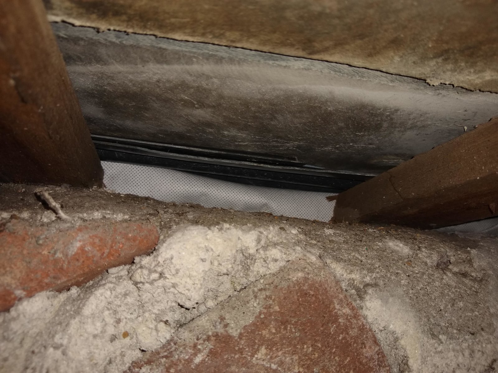

Here's a photo from inside the loft looking at a section of the party wall between two roof battens. The fabric you can see is overhang from the neighbour's build.
I should point out that a roof rafter runs down the top of the party wall (the one mentioned in my previous post where my gutter is meant to be attached). It is between the wall and the battening and covered by the original build cement as shown. As you can see the gutter has been placed OVER the battens and squeezed under the lifted slates - is this right?
Since the gutter is over the party wall and installed without consultation do I have any right to ask them to remove it?

I'm convinced the installation has been done poorly and needs rectification. My neighbour said he had asked the builder to call in to discuss but didn't turn up on the day arranged (surprise!) but 4 days later I was lucky to catch him on site. I kept it friendly and expressed my opinion that the gutter should not have been fitted and had been poorly installed.
After pointing out the semi-detached building next door to us has also had a conversion with the integrity of the tiling (old to new) maintained successfully without a bonding gutter, he went a little quiet in my view.
The builder seemed fairly reasonable at this stage and although he obviously wouldn't admit to there being a problem, he at one point said he would "remove it if you like". However as time went on he was very much pushing to add a foam to the tiling as a fix after I enquired about firestops - called styro-something (fire-resistant) I think. I rejected this idea as a poor long-term fix.
Wen I hinted that I thought I would prefer the removal of the gutter and making good by joining the old tiles back to the new, he started on about their battens now being on a different pitch and wouldn't match. I have a sample of their man-made tiles and they are larger (30x60cm) compared with mine (12"x20"=30x51cm). The thicknesses are LESS THAN 1MM DIFFERENT! I'm convinced therefore the bonding gutter was put in as a cheap & lazy approach. To show I was being reasonable I said I would think about it and not act the angry neighbour.
