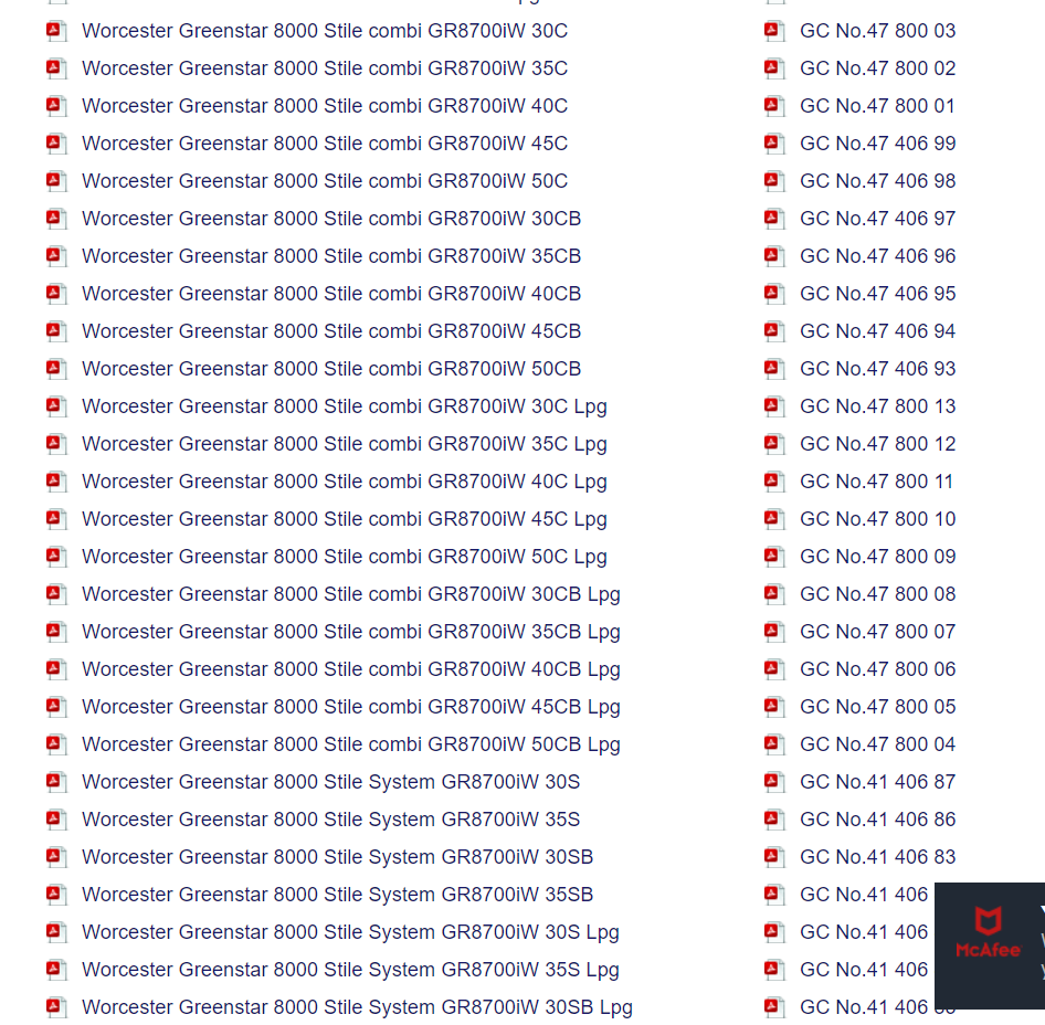

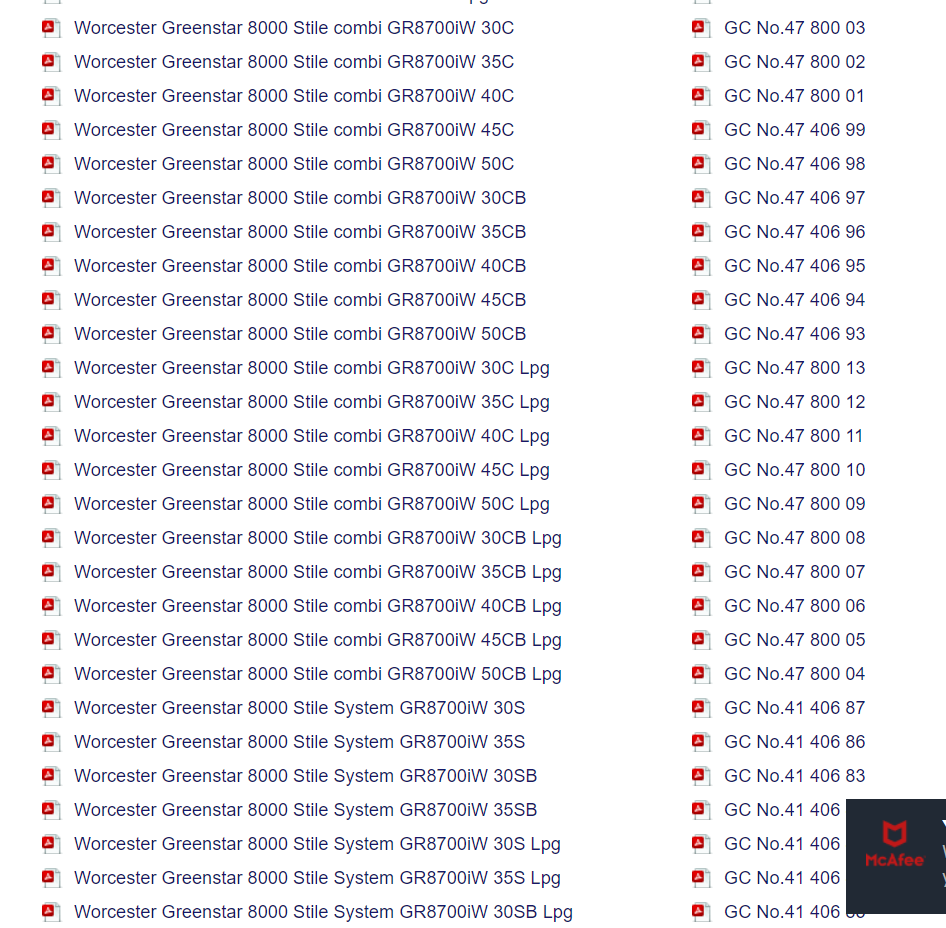

    Could you narrow it down a bit ?

    It is a Worcester Greenstar :rolleyes:

    Combi or system boiler with zone valves ect :rolleyes:
