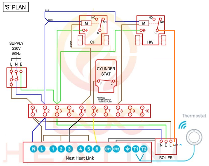

Problem : HW (Tank) only being heated when CH (OpenTherm) has the boiler running/heating. Nest HW boost doesn't work.
Here's my current wiring:
CH : Controlled by Nest which opens the CH valve via connector 3 and controls the boiler temp via OpenTherm. Valve orange wire not connected to boiler as OpenTherm replaces it.
HW : Controlled by Nest which opens the HW valve via connector 6 and I assumed would control the boiler temp via OpenTherm (i.e. Call for higher boiler temp when HW is ON). From a lot of reading it seems like a common issue that people have where the HW is only getting to CH temp. Valve orange wire not connected to boiler as OpenTherm replaces it.

3. Use OpenTherm for CH and wire up HW valve orange to SL2 for HW. It's not clear to me if this is supported by the boiler and what would happen if both the CH (OpenTherm) and HW (Call for heat) are asking the boiler for heat at the same time. Logically, I would expect that if there is a call for HW, then the boiler heats above the OpenTherm CH temp (I asked Ideal in the same email mentioned above).

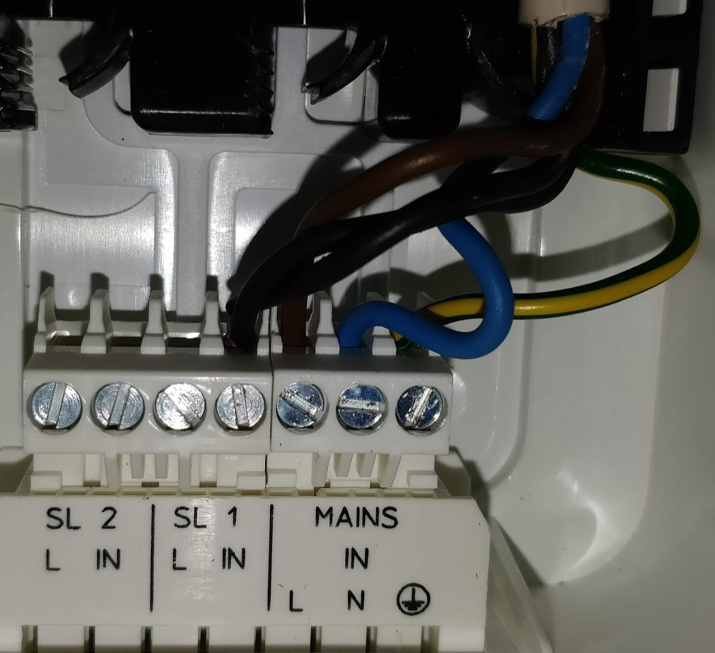

I managed to speak to someone at Ideal today who relayed answers to my questions:
1. What's the difference between SL1 In and SL2 IN? Answer : There is no difference.
2. Can OpenTherm be used for CH and SL2 IN for HW? Answer : Not recommended as it might confuse the boiler.
3. Why do you supply a system boiler with OpenTherm if it can't be used with HW? Answer : I'm afraid all the technicians are busy on other calls....
Apparently I can't speak to a technician because I'm not a Gas Safe engineer. I'll have to call back to get a clear answer on question 3....
In the meantime I have rewired so that it's not using OpenTherm. CH and HW call for heat are going to SL 1 and SL 2. I'm pretty sure that the call for HW is causing the boiler to heat the water to a higher temp than the the call for CH. I'll do some more testing as I don't feel confident in the responses I got from Ideal.

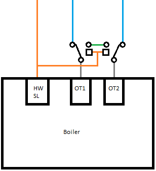

I think I've found a potential way to achieve OT CH and SL HW (Excuse the crude diagram)
By using a couple of relays; when there is a call for HW, the relays close the OpenTherm loop at the boiler (Boiler then thinks there is no OpenTherm control). When HW is off, OpenTherm is connected to the Nest. The challenge here is that the Nest will probably complain that it's lost the OpenTherm connection.
