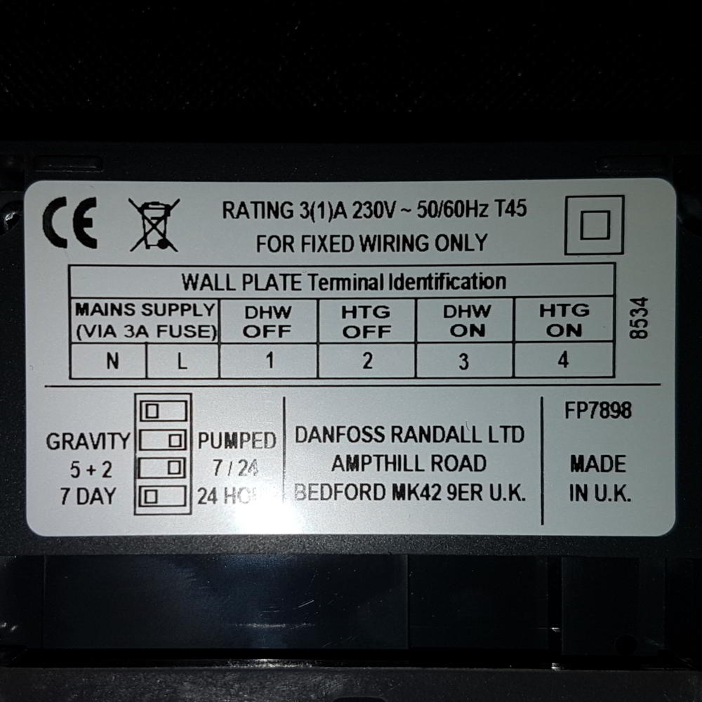

    Now just need to know how to wire up the NEST 3rg Generation Thermometer/Heatlink.
    I currently have a 'Danfoss FP715' programmer, with:
    • Live
    • Neutral
    • Earth
    • Terminal 1 - DHW Off
    • Terminal 2 - N/A
    • Terminal 3 - DHW On
    • Terminal 4 - HTG On
    Room Thermostat End:
    • Live
    • Neutral
    • Switched Live
    • Earth

    The wires from the existing thermostat are moved to the Heat link terminals that have the same function, thus:
    • Live.....Heat link (L)
    • Neutral.....Heat link (N)
    • Earth......Heat link (Earth)
    • Terminal 1 - DHW Off.....Heat link (4) DHW Satisfied
    • Terminal 2 - N/A
    • Terminal 3 - DHW On..... Heat link (6) DHW Call for Heat
    • Terminal 4 - HTG On.....Heat link (3) HTG Call for Heat
    The two Heat link 'Common' terminals (2) and (5) need to be connected to the (L) terminal
    Trace the cable back to its origin. I can't tell you where that will be as that depends on where the original installer thought best to wire it in. Usually (but not always) it's a wiring centre near the motorised valves, but it could be connected to other places. Once you have found the other end and positively identified it, preferably by testing with a multimeter, then:
    1) Note where the 'Live' and 'Switched Live' wires are connected
    2) Disconnect all 4 wires and remove the cable, make sure other wires in the same terminals are not disturbed
    3) Insert a wire link between the terminals that you have just removed the 'Live' and 'Switched Live' wires from so that they are electrically connected
    4) If you wish, and it is convenient, you can extend use the disconnected cable to power the thermostat by connecting it T1 & T2 at the Heat link. Otherwise run a new wire [or purchase a separate plug in power supply :whistle:]
