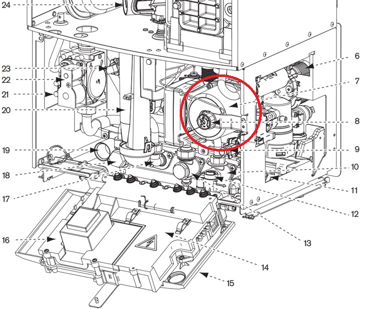

I'm assuming you are referring to the circulation pump located inside the boiler.
If so, that pump is controlled by the boiler's internal circuits and not the Nest.
All Nest does is tell the boiler that heat is required which you say it is doing. Then the PCB inside the boiler then looks after all of the boiler's internal functions. Diverter / Gas Valve / Ignition / Pump / etc.,
Are there any other external controls fitted to the boiler? Frost Thermostat? Weather Compensation etc.,
Maybe one of the RGI's on here who is familiar with the intricacies of your particular boiler and has come across this before maybe able to assist.

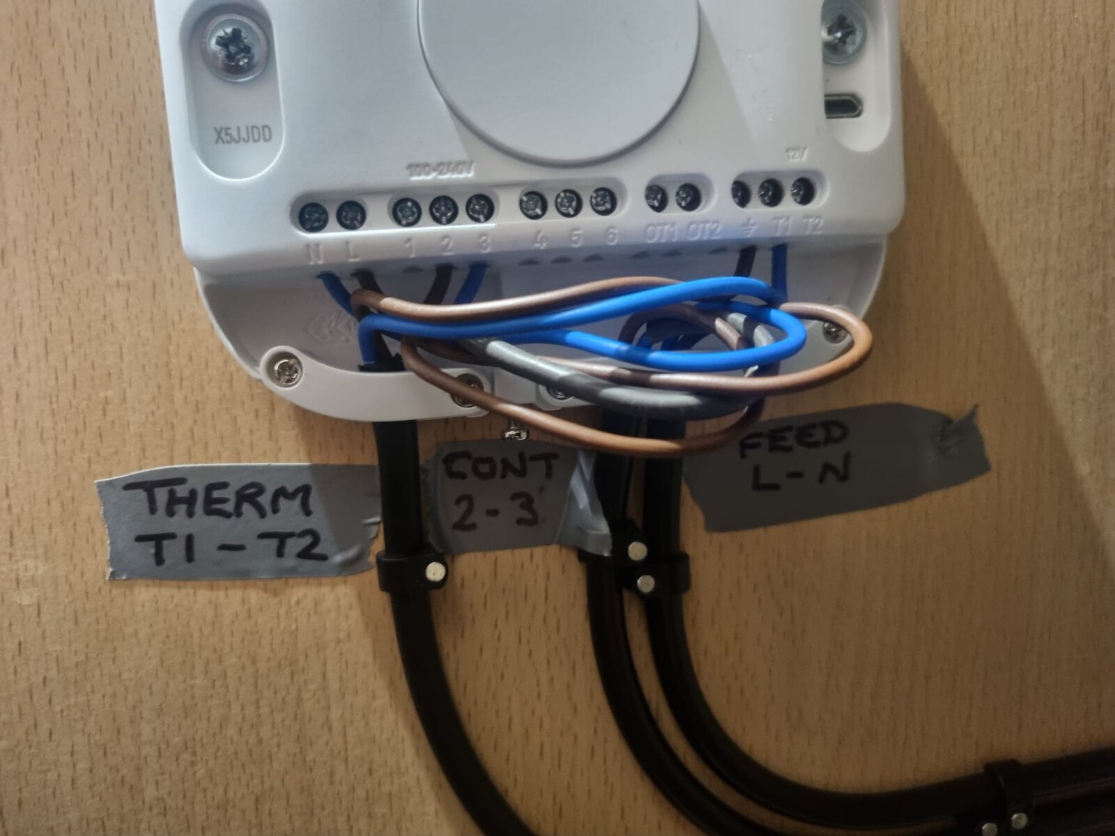

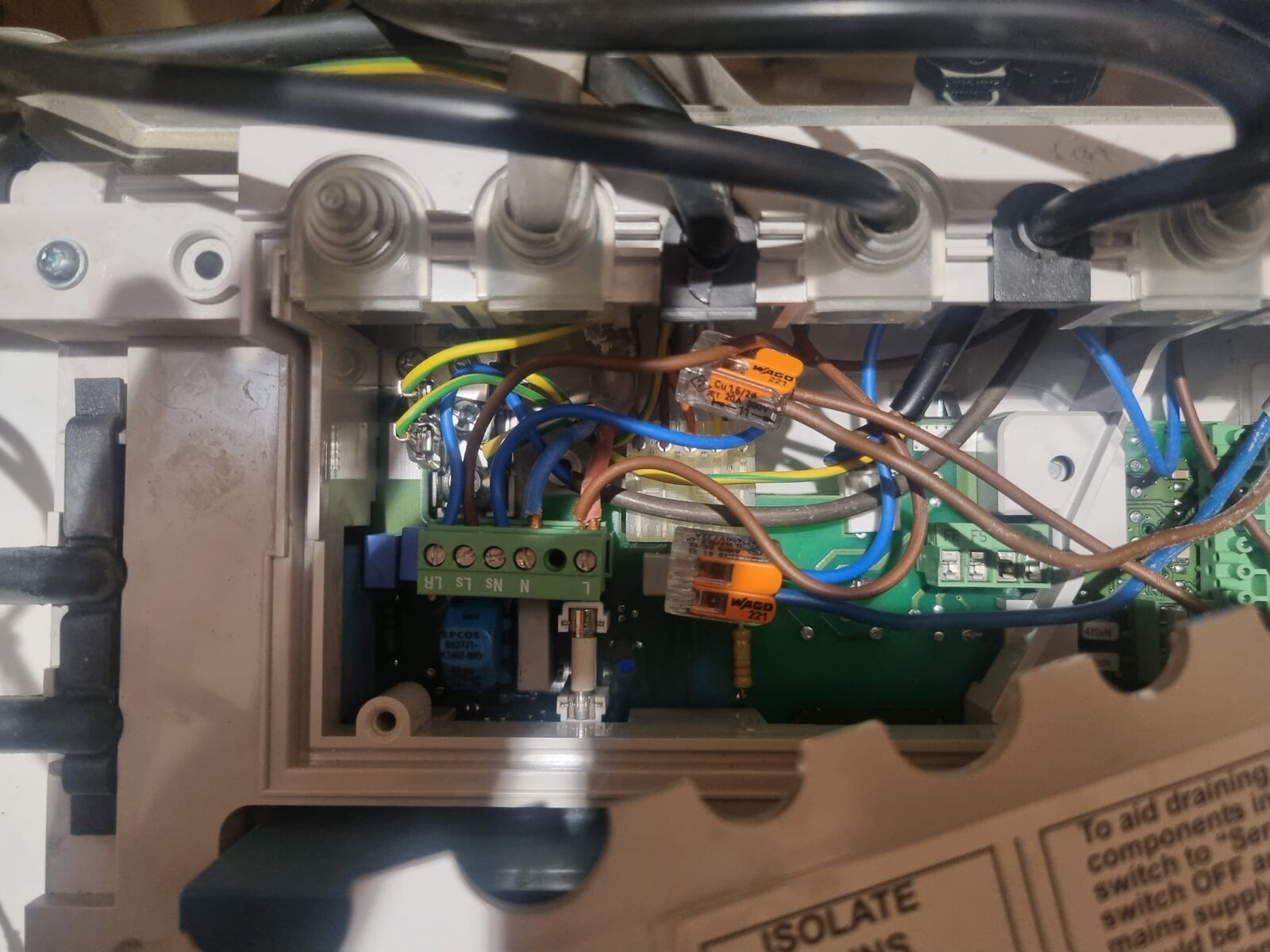

can you post a pic of the wiring both at the nest end and the boiler end

Thanks for the reply. There is a TP200 timer on the front of the boiler, which obviously i am no longer using or is the original worcester room stat now connected to it.
And yes its the circulation pump thats running all night thats my issue.
Neil
The TP200 will only switch the heating on/off so again won't directly control the pump. If you do as suggested by @ianmcd and post a couple of photos it might help us spot something.
