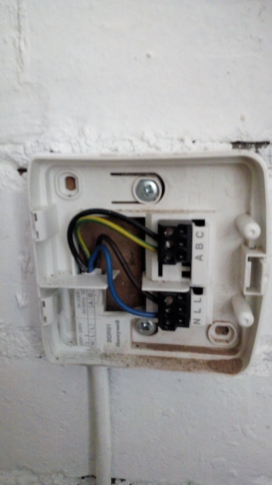

Hi, hoping someone can help. I've bought a nest 3rd generation heating unit and replacing my Honeywell heat link .I'm unsure as to where the two wires go into the nest unit (I'm fine with the L + N)
Wire in BDR91 A=Nest Heat Link 2 'Heating Common'
Wire in BDR91 B=Nest Heat Link 3 'Heating Call for Heat'
