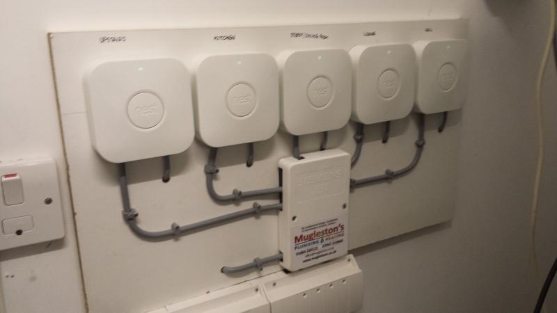

I once did a full ground floor of UFH with five Nests...
