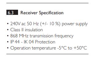

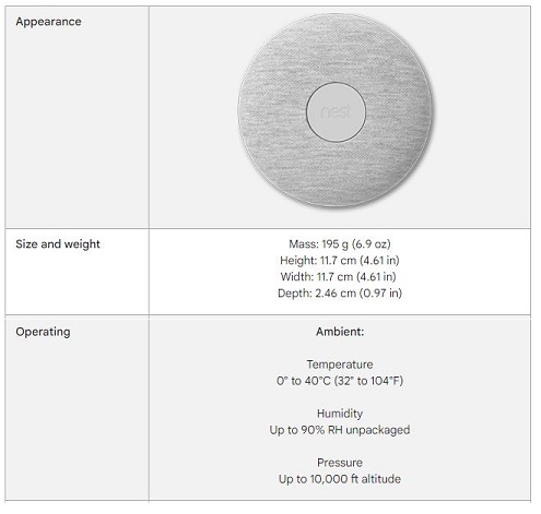

It's only a receiver, and the thermostat tells it what to do, which means there's no issue with it being in a colder place than the room thermostat. From that point of view, it's the same set up that you have now.
However, according to the Nest-e technical specification the operating temperature range of the receiver is 0 to 40 degrees C, so if the temperature in your loft falls outside of that range then it's not really suitable. As well as your concern with the cold, some lofts can also exceed 40 degrees in the summer.
The Baxi Receiver you have now has a 15 degree wider range.
Also to consider, is that unlike the Baxi receiver which is mains powered; the Nest-e receiver is battery operated, so you would have to access the loft to change the batteries.
