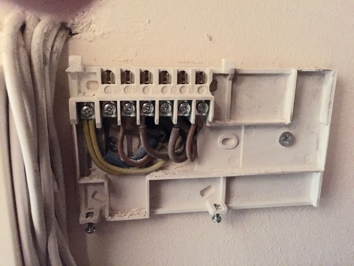

Can anyone help me with the wiring - replacing my Honeywell T45 with the Heatlink for a Nest 3rd gen? Does the common need a jumper from the live? Many thanks for any help, see attached pics

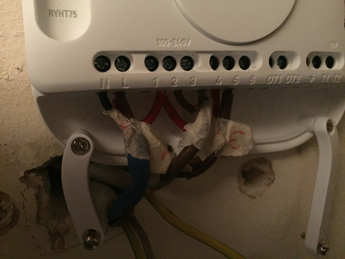

Can you post a photo of your Heat Link wiring? You won't normally need anything connected to the old HW Terminal 1, unless you've got an odd system! Did you have a room thermostat before, or just the timer?
Thanks really appreciate this ... posted a pic of Honeywell too.

It's hard to see what you've done there. Maybe post a picture taken from the front, rather than at an angle from the side where it's really difficult to see what wires go where? A bit more illumination wouldn't go amiss either...

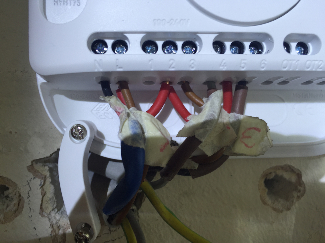

OK this better ... and yes 1 room stat, not done anything with that yet, but tried with it turned up and down. Was going to remove once nest working properly

Come on man use the rear entry holes on the nest, don't ram the unsheathed wires in the surface wiring entries! You had lovely neat wiring before. :cry:

Good. The wiring all appears to be in the connect terminals. I take it you have a 3 port valve?
If you have a multimeter, set it to AC volts, black lead to neutral terminal on Heatlink for all tests, then check:
With heating and hot water off there should be 240V on terminals L,1,2,4,5
With only heating on there should be 240V on L,2,3,4,5
With only hot water on (and cylinder stat calling) there should be 240V on L,1,2,5,6
You'll need to turn that up to make your heating work with Nest attached. Eventually, you can re-use those wires to power your Nest, although to do that you'll need to wire your Heat Link into your heating's wiring centre rather than where the old programmer was
As far as I can see you've wired everything correctly, save for not having connected the Earth, so it suggests that your links between L, 2 & 5 perhaps aren't linking properly. Time to get the multimeter out...
