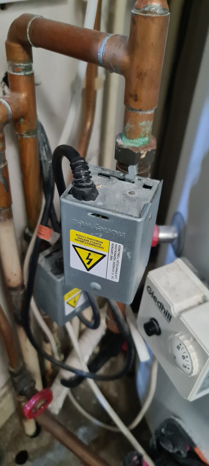

When you call for the HW Cylinder to heat, does the DHW Zone valve open ?

It doesn't seem to do anything, the cylinder just uses the immersion heater straight away, the nest app shows that hot water is currently ON.

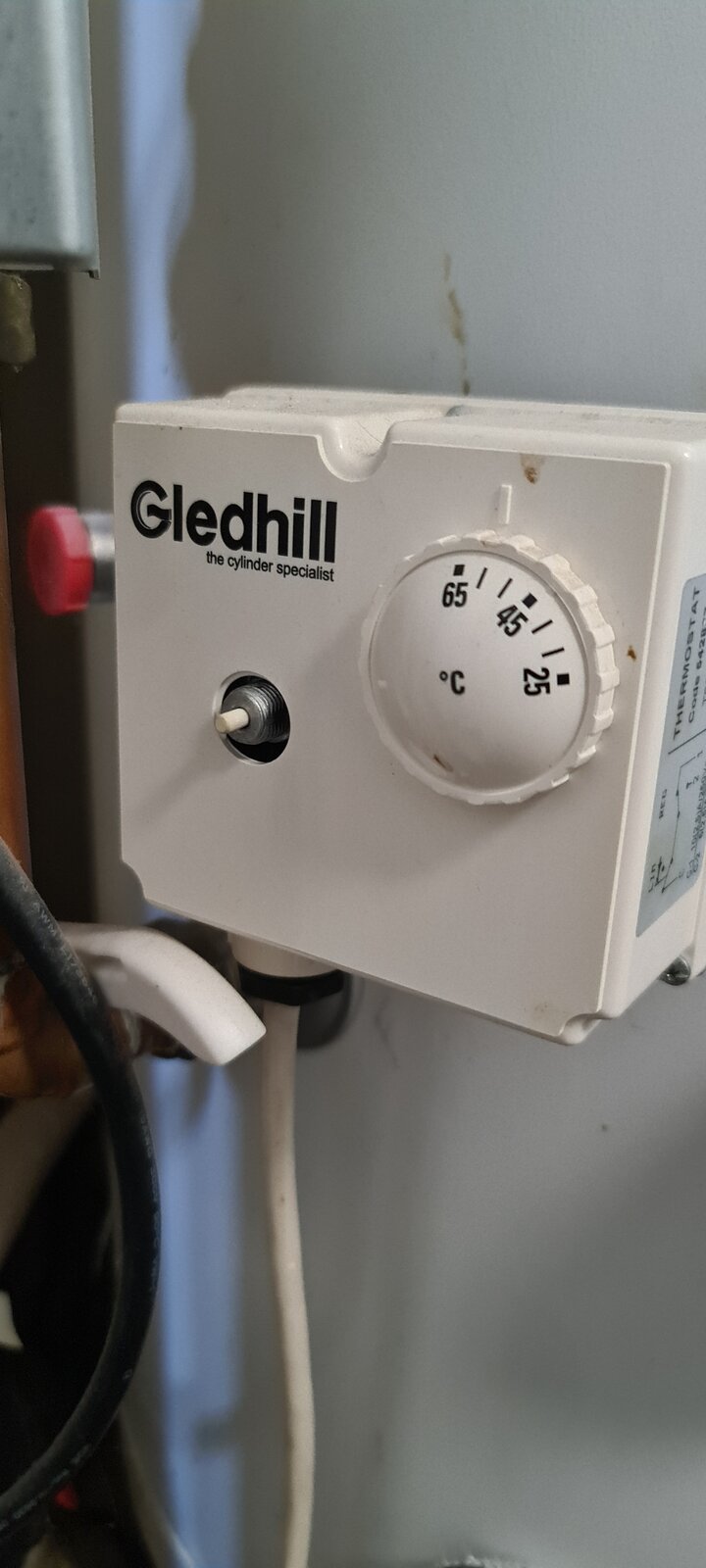

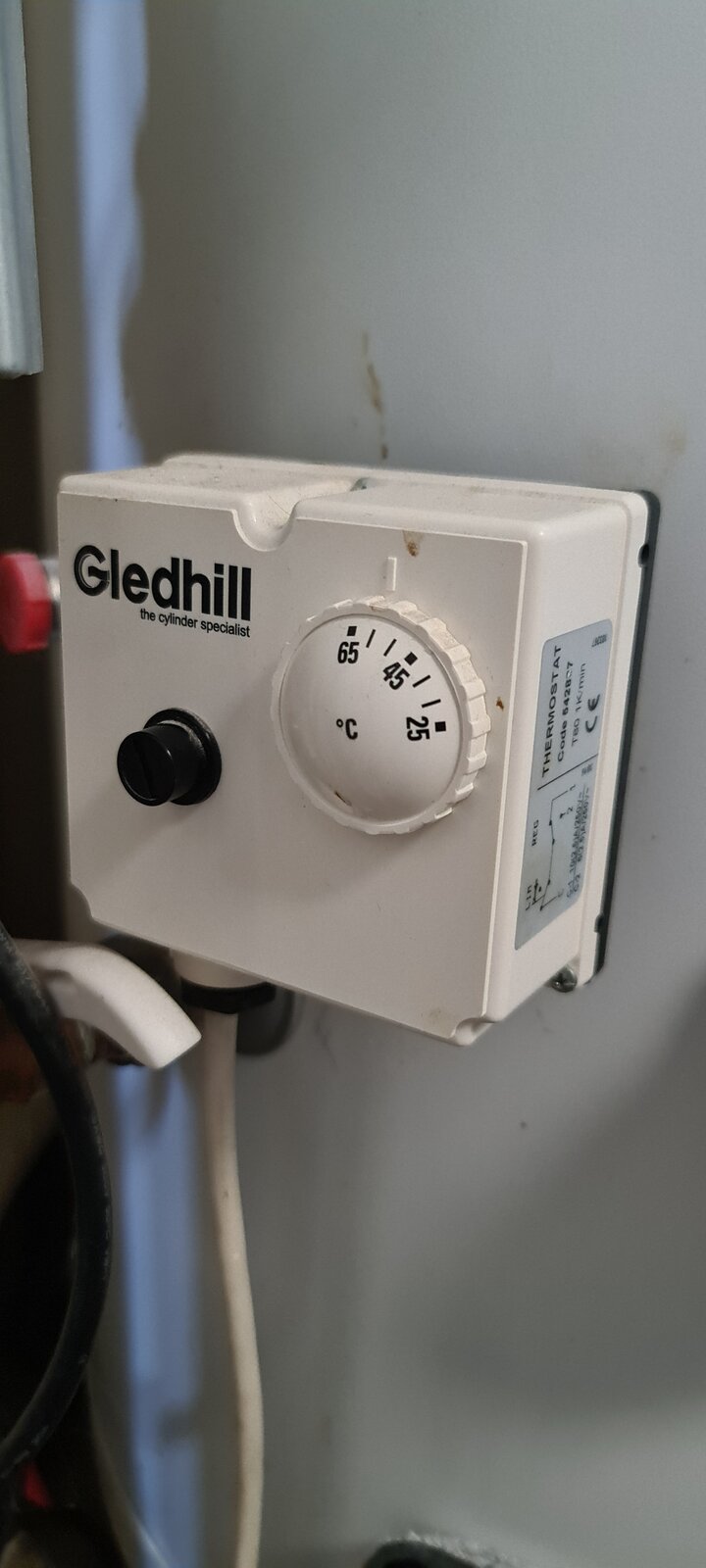

Look at the cylinder thermostat there will be a reset button on it. Probably under a screw cap - not the one on the immersion itself though...
If all else fails post a picture on here or look it up in your user instructions. It's probably labelled 'high energy cut out' or similar
If it's tripped it will stop the boiler heating the water

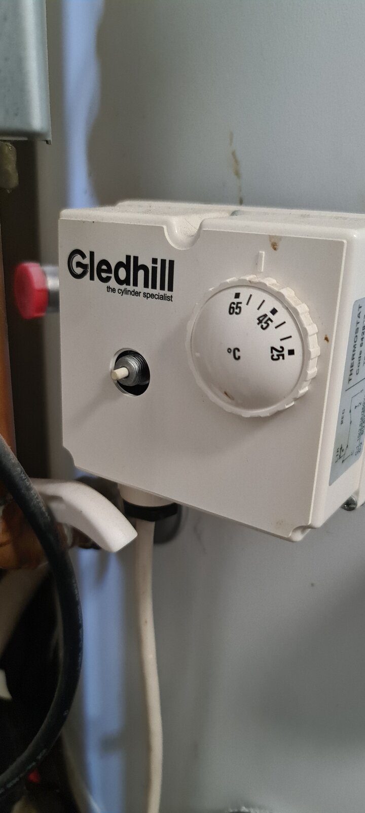

There's a small black plastic cap with a plastic pin underneath it that is sticking out, does that seem normal?

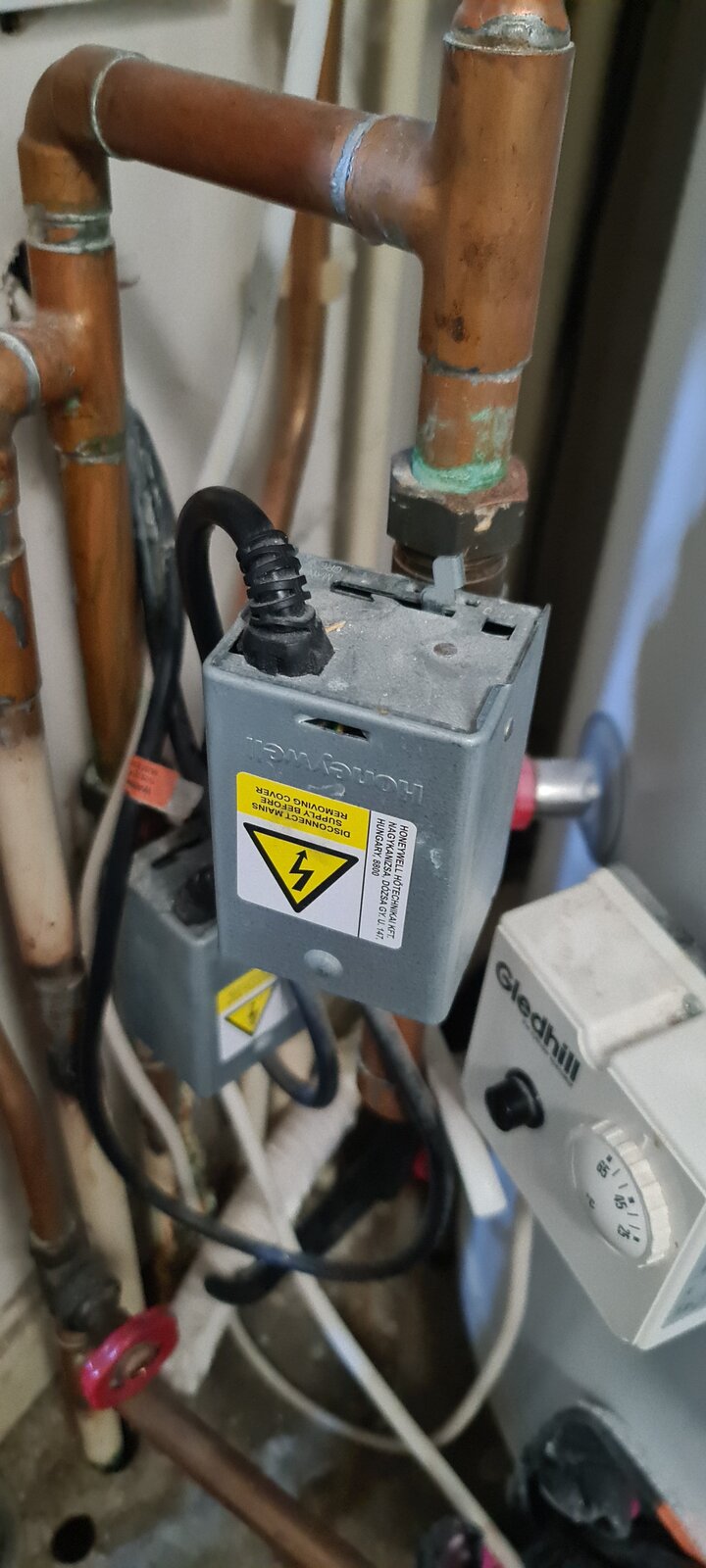

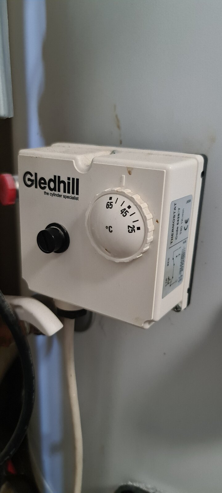

To clarify the thermostat type I have attached pictures of it and the valves that are both the same and set to auto.
Our immersion heater switch was on, as even with it turned off the boiler still is not heating the water

I think you might just be a genius. I switch my immersion spur off and pressed this reset switch and (whilst only early days) it seems to have kicked the boiler on for the water! Will see how it goes and let you all know if this fixed it.
Side note, if this little reset button has cost me a ton of electricity for 2 years I'm gonna be annoyed with myself
