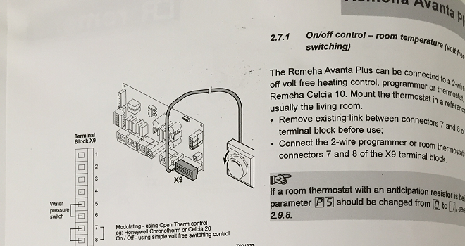

ok i have tried to work out how to install a nest to our boiler, we currently have no thermostat installed i have looked at the connections but nothing seems to correspond with the connectors for the nest
i have tried to attach some images to see if you guys can help

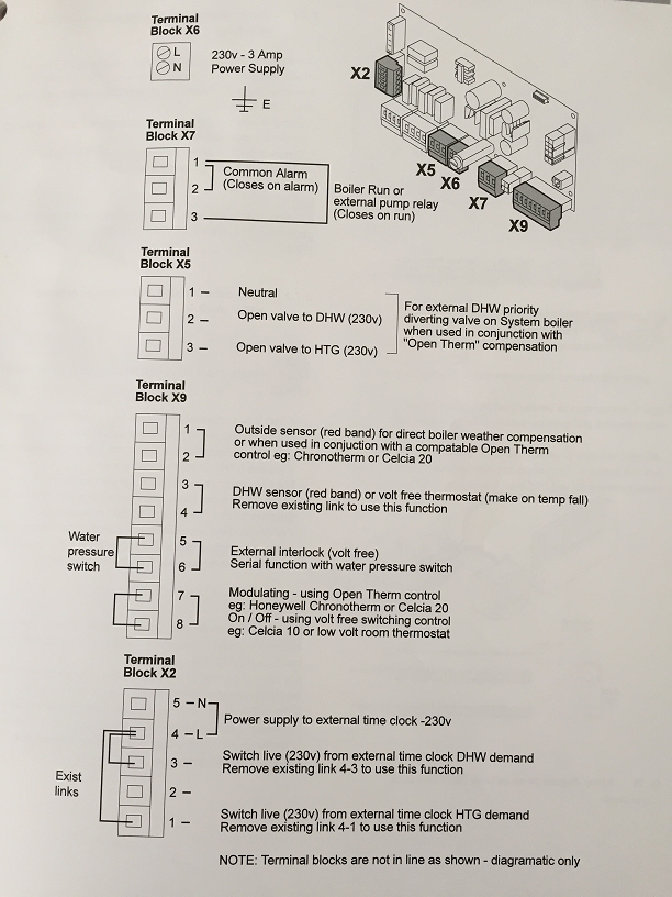

connectors from the boiler
full
full

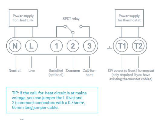

connectors for the heat link for the nest
full
so is this right ?
& remove the jumper wire between 4 & 1?
As far as i know doesn't the case that provides the room seal for this model have to be removed to get to the electrics, not really diy territory.
In fact it was in the news recently that a diyer didn't put the case back on the boiler correctly and /or tested it's effectiveness which led to the co poisoning of a family. The culprit was fined for £5000, could of been prison if there was a death.
