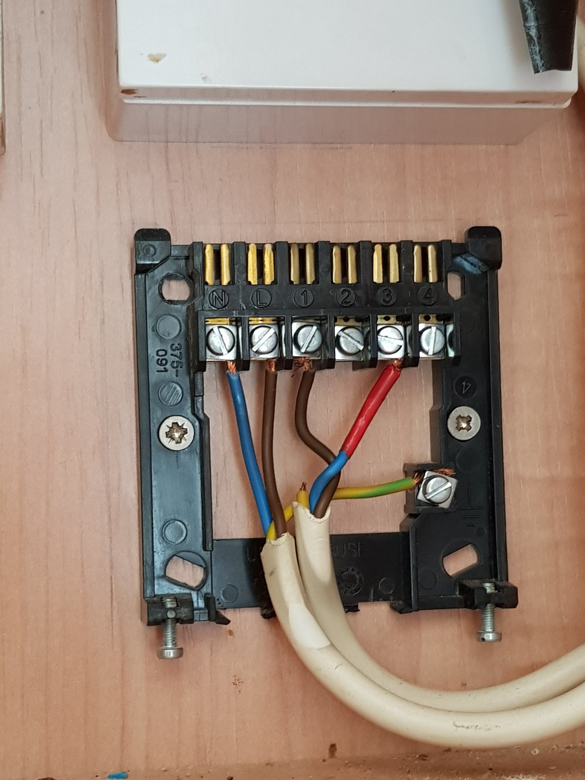

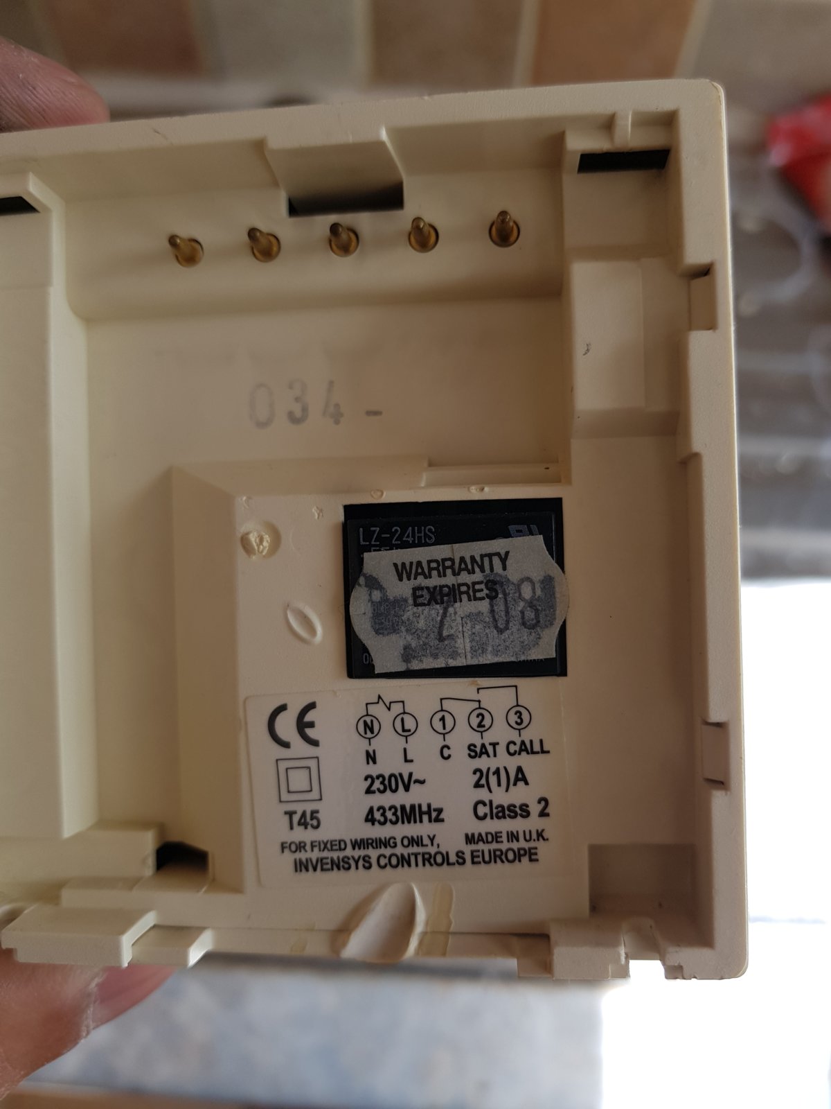

Hi all,
I am moving into a new home and wanted to install the Nest. I looked at the wiring to the Drayton reciever which seems simple enough, also wiring from the Glow worm boiler.
I have the Neutral and Live coming from a fused switch and then 1 and 3 coming from the boiler.
My assumption is as follows,
Connect the N from the switch to N on the link
Connect the L from the switch to the L on the link
Wrap the earth wire up from the switch or connect to the earth on the link
Im not sure where to connect the current 1 and 3 to? Would it be the same 1 and 3 on the heatlink or do I need additional wiring?
Any advice is much appreciated and thanks for responses in advance.

Looking at this wiring diagram 1 and 3 go to 2 and 3 if nest used as an on/off thermostat. I did look at compatibility list and it seems your boiler is not on it.
