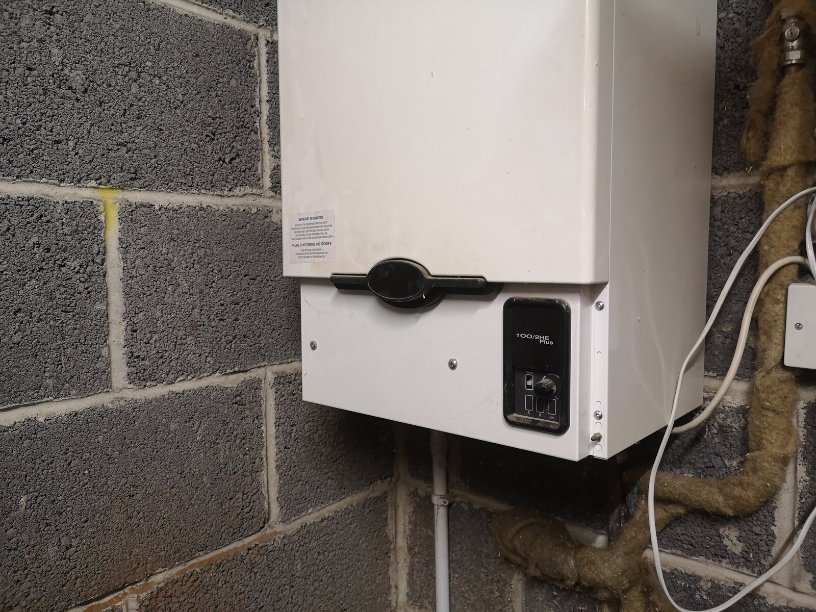

So I have a Baxi 100/2HE Plus boiler, which has been working fine.

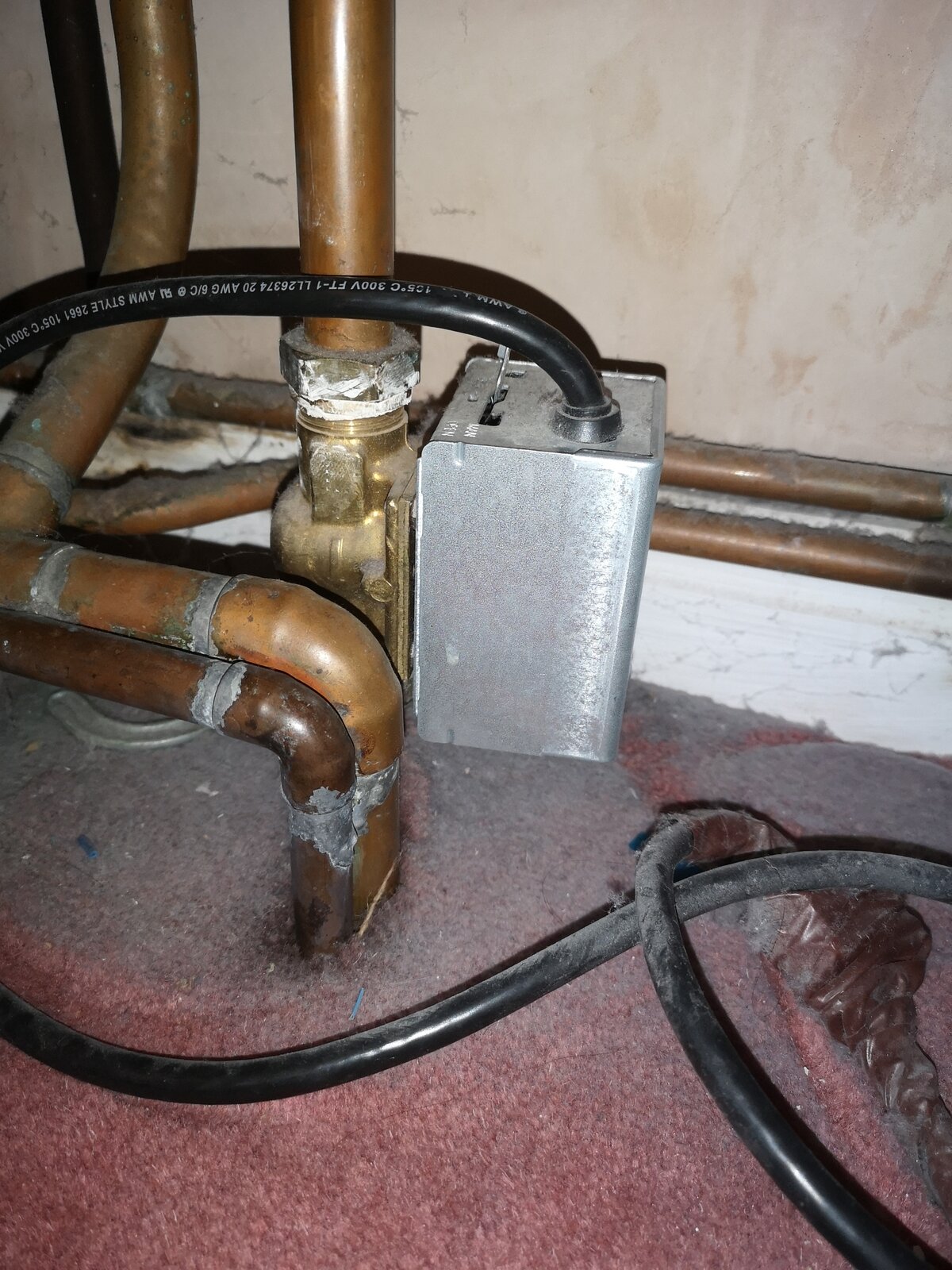

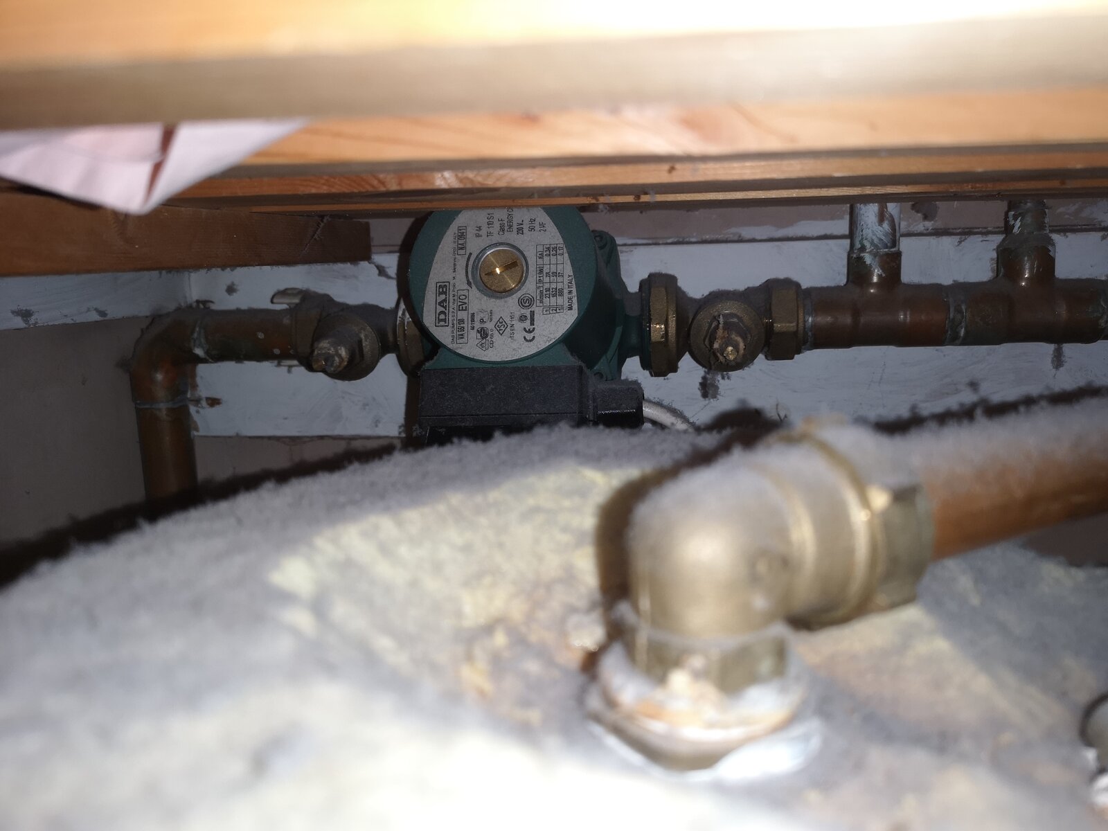

Forgive me I'm not a plumber. Not sure if this is a S or Y plan... I have the valve and a pump as per picture.

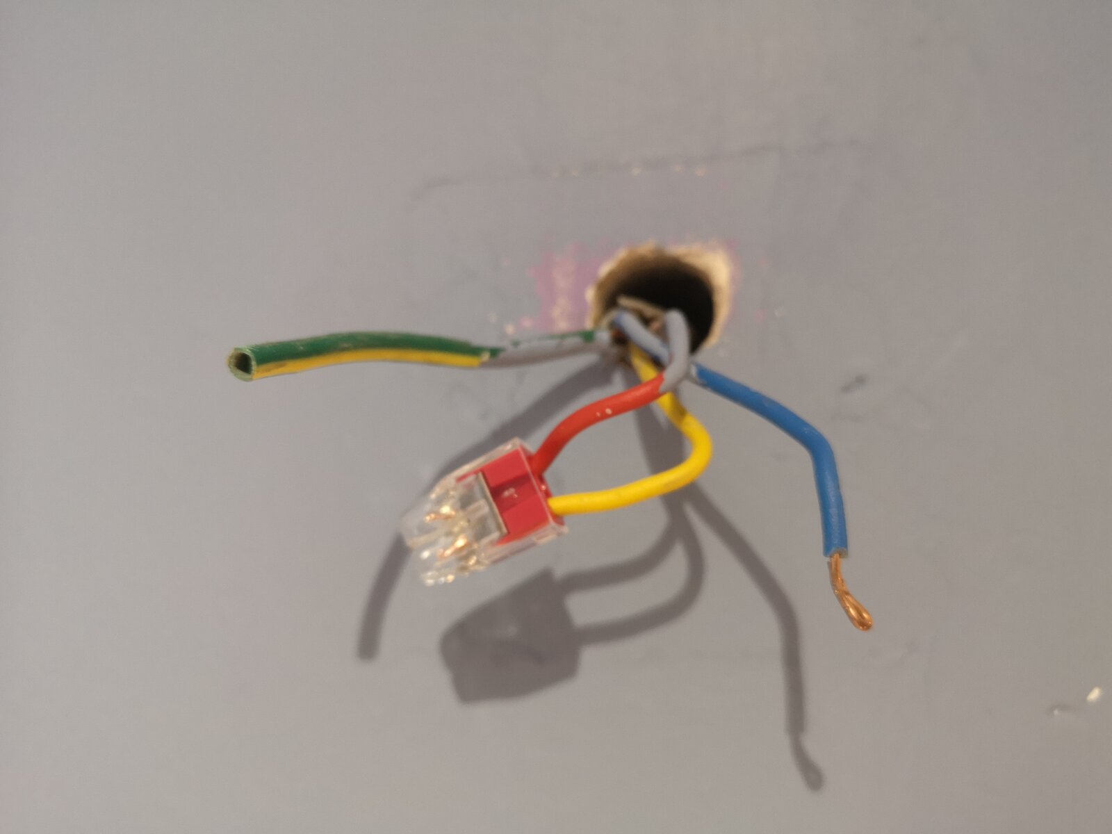

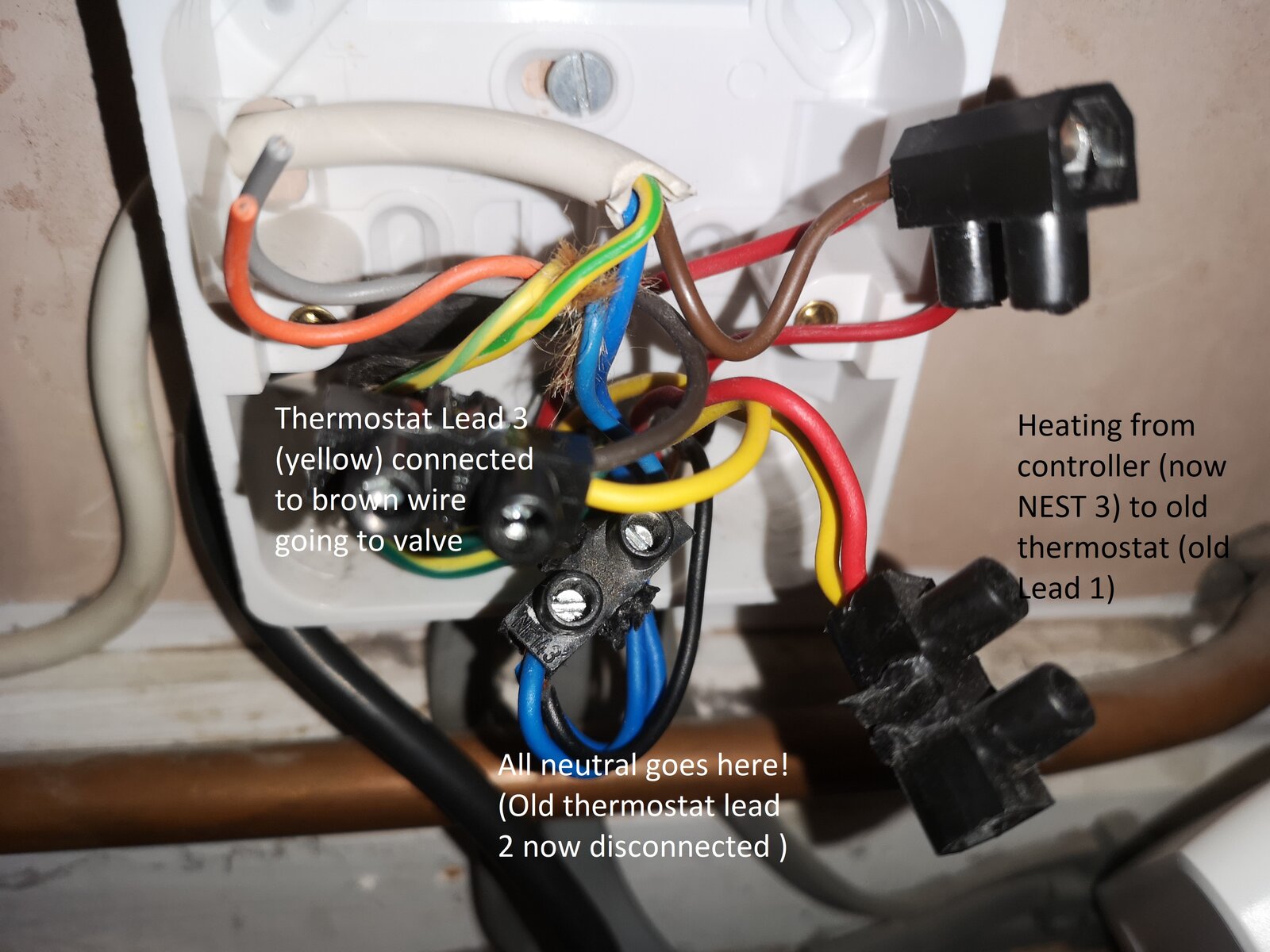

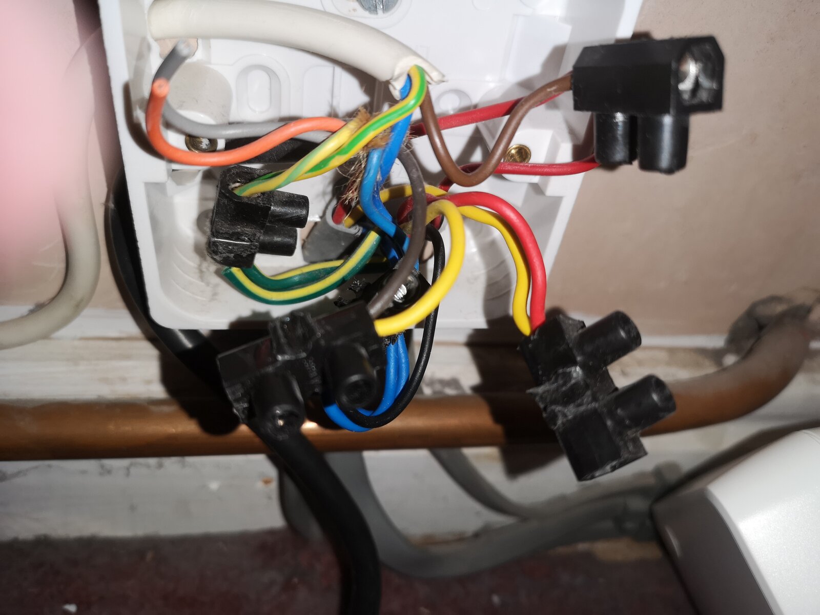

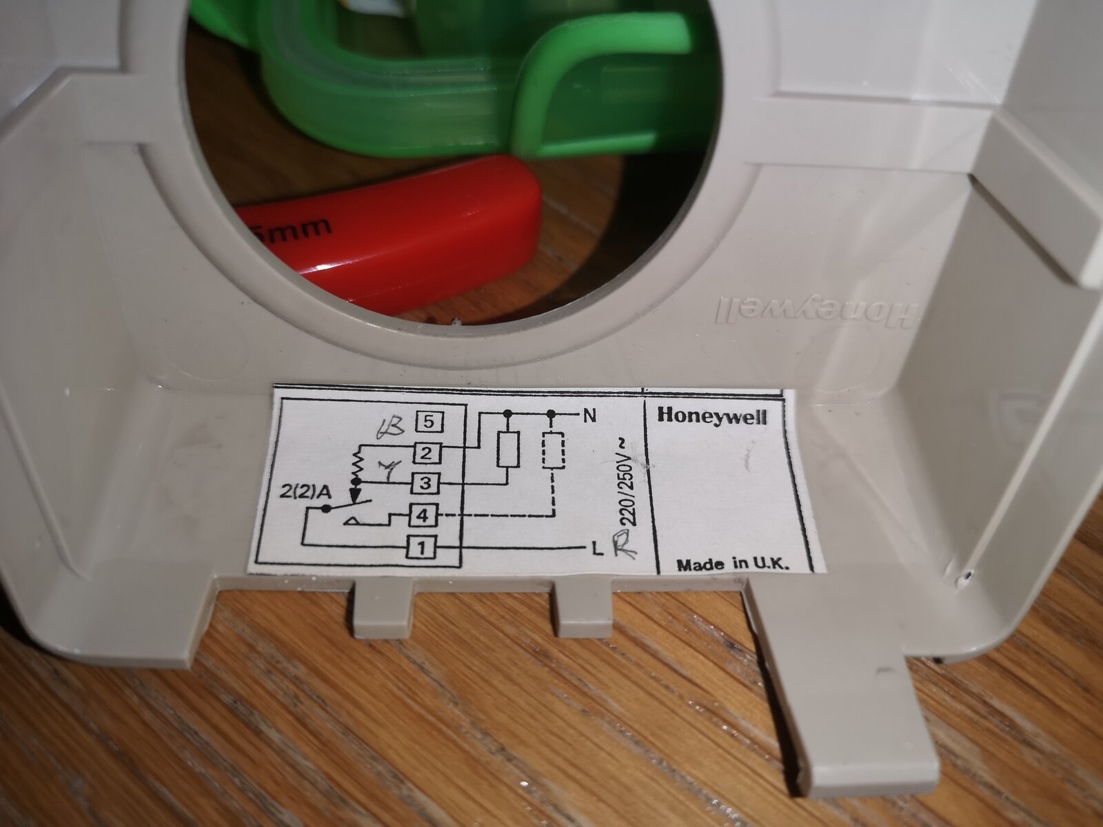

The wiring is going to drive the plumbers out there crazy (probably). Here is what I worked out:
Old Honeywell thermostat now removed. I have noted the wiring before removal:
1 and 3 connected. 2 just floating in the air.

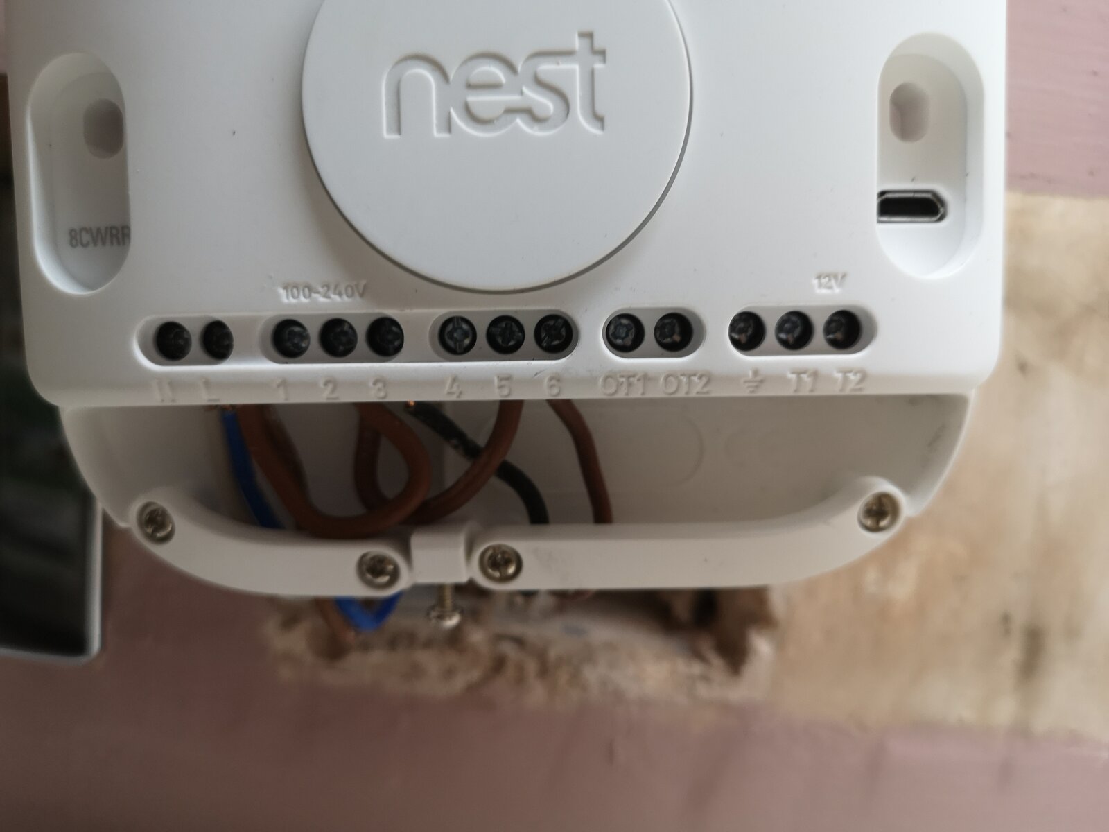

I wired the NEST as described in various posts here:
N and L
L to Nest 2 and 5
CH to Nest 3
HW to Nest 6
Turned heating up to 32C (ambient is 29C at the moment) but boiler is not firing up. In fact the power light is off.
The boiler will power up on "manual boost" so something is working, but there was no heating with that. Water is scorching hot so pretty sure hot water is working (immersion tank heat is wired separately.
I must have wired something wrong somewhere. Please point me to the right direction! Thanks.

in your last pic the orange and grey wires are not connected to anything, they should be the grey wire should be permanent live and the orange wire connects to the same terminal as the orange wire on the HW zone valve, that is the wire that brings the boiler on

We lived in this house for 10 years and with the old thermostat everything was working fine. The orange and grey wire had been like that all this time. Are you saying the Heat Link needs to be moved up to the junction box and get everything rewired? Any idea of cost involved, including a proper junction box!?

you must have another zone valve somewhere, you have an S plan if those two wires have never been connected, it has never been wired properly

orange and grey not connected. I need to connect grey to HW off (Nest 4)?
What does orange do?

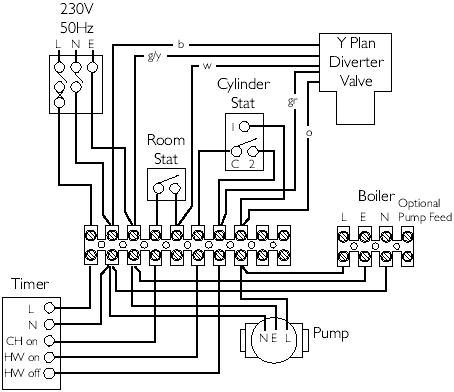

This is probably the clearest chart I have come across so far.
No you are wrong that is a two port valve, you have an S plan, but if it was a cowboy install you might only have one valve, you should have two or sometimes more

So when the heating is switched on by Nest, signal goes from Port 5 to the CH valve. However because I don't have the cable from CH valve to Port 10 --> SL (switch live?) Boiler, it doesn't come on.
However if the water is also on, then there is hot water flow anyway so the CH works.
Is that correct?
So I need to locate HW valve and find the "orange wire" or "Position 10" wire. This should lead to the boiler SL port. Linking the orange wire from the CH valve to this should make the two system working independently?
Where is it likely to be? I have a water tank in the loft and cylinder in the airing cupboard where the junction box is...
Also notice in the photo of my valve, there is some "dodgy wiring" underneath the valve cable. I am going to guess someone botched it to make it a bit longer.

By the sound of things, what they have done is wired it so the HW is always on and the zone valve was getting power to open when they wanted CH, you would never have been able to get heating without HW, hence why the end switch wires are not connected, this can be achieved with the nest but you have to set it to gravity HW even though you dont have that, very uneconomical would be best to get someone in to do it properly
Took a bit of time to digest that.
So what you are saying is my system is not quite an S plan. It's rigged so that the HW On is wired directly to Boiler SL, that's why there is no HW wiring at all in the junction box. I have no HW Valve. When HW is on the whole system comes on, but CH valve is closed so the there is no CH. For CH to be on, HW must also be on to i) activate to boiler, ii) open the CH valve. Is that correct?
