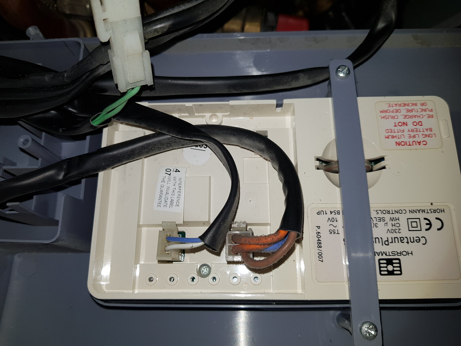

It's got the programmer (A Horstmann CentaurPlus C27B) "built-in" to the boiler along side the control board which can control hot water and central heating. Outside of the boiler, there's a Potterton PRT2 manual thermostat on the wall for just the central heating.

And the programmer next to it;

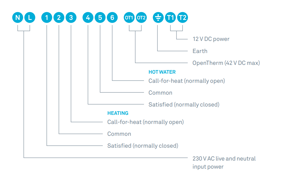

As best I can tell from the Nest's own wiring diagram;
Terminal 1, grey cable, goes to N.
Terminal 2, black cable, switched live or call for heat, so that goes to 3.
Brown live goes to L. And then according to the nest manual I can bridge L & 2 since it operates a mains voltage.
If I've got that totally wrong please do give me a slap and correct me so I don't blow something up.
