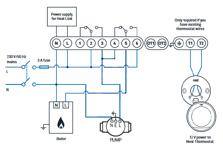

It is very simple to do but the diagram above is wrong so dont try and wire it like that

No that is why you have to tell the nest that it is Gravity HW, the CH can not be selected on its own the HW turns the boiler on and the CH operates the pump, the HW is always on even if only CH is selected, and the temp of the HW is controlled by the boiler stat, of course this can be changed but will need additional controls fitted
So how do you tell the nest its gravity hot water ?
It is in the settings menu when you set the nest up, can be changed if you upgrade the controls at a later date, gravity HW is exactly that, the boiler comes on and the HW circulates through a large coil in the HW cylinder through gravity, no pump is used , when the CH is asked for, the pump comes on and circulates water through the heating system, but the gravity HW will still be on, you can not get CH on its own with a gravity HW system, many people mistake what a grvity HW system is, as opposed to an open vent system, they are not the same thing, @picasso , this is for others reading this , I know you will already know this but it is the open forum, and is advice to those that mistake open vented systems from Gravity HW systems
