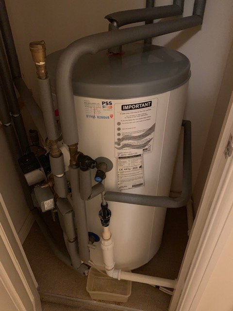

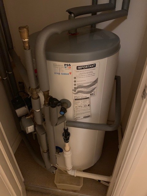

My boiler is a system boiler, not a combi, as I have a large tank in a hall cupboard.

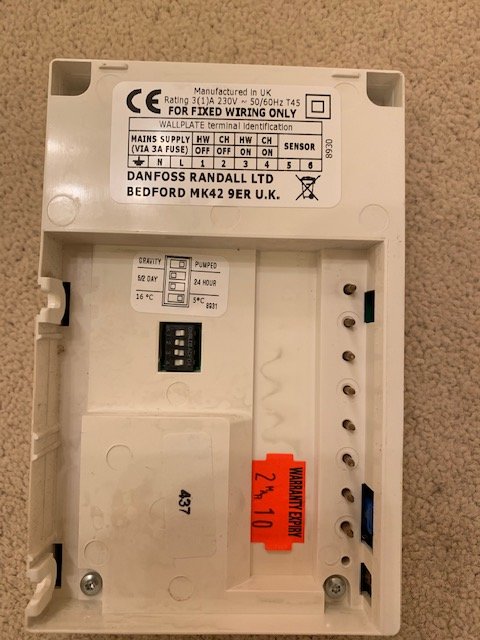

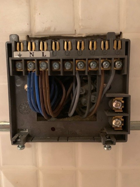

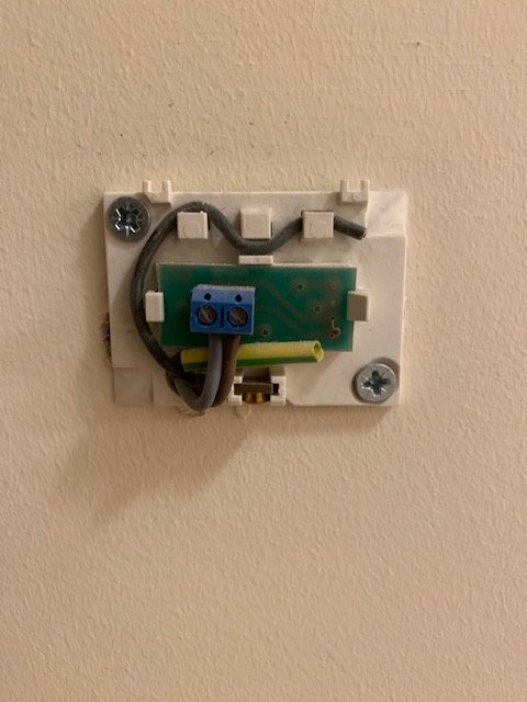

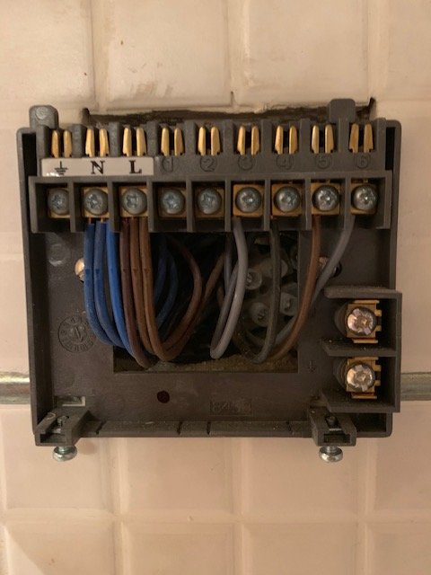

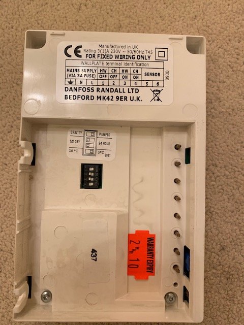

Now from all the reading I had done, I felt ready to take this project on. But now I have 2 questions, do I have Y plan or S plan? (what information can I provide to identify this) and also when I took the panel off the TS2 sensor, and found two 'floating' wires, which have confused me a little. All I was expecting to find were the 2 wires coming from terminals 5&6 of the TP9, so I wanted to ask the forum why this possibly be before I go ahead and start the install.

Hi Branagorn & Welcome to the forum. Good first post, you have included the necessary information.
You have an S-Plan with two x 2-port motorised valves. The absence of a wire in terminal (1) which Y-Plans have is the clue.
The good news too, is that because the sensor is actually part of the programmer and the switching bit is inside the programmer, it makes the replacement easier because there is not a remote thermostat to decommission.
Remove the sensor wires from 5 & 6 and remove them, they are no longer required. (standard 3 core and earth cable has been used, so there are two unused wires, quite common) You are then left with wires in: N, L, 3 & 4 they go to the Heat link as follows:
N (Blue wires) they go to heat link N
L (Brown wires) they go to heat link L
3 (Grey wire) is hot water call for heat or 'on' and goes to Nest (6)
4 (Black wire) is heating call for heat or 'on' and goes to Nest (3)
Then links are required between (L) and the two Commons (2) & (5) so that the three terminals are electrically connected.
If you want to power the Nest thermostat from the Heat link instead of using a separate plug in power supply run a cable to connect it to T1 & T2. Don't forget the earth connection.
Where there are several wires in one terminal you will find it difficult to get all of them into on terminal at the Heat link, it's a fiddly beast to wire. So, I normally terminate them in screw terminals, tuck them away in the back box (I see there are some already in there) and then just run one wire to the appropriate Heat link terminal.
