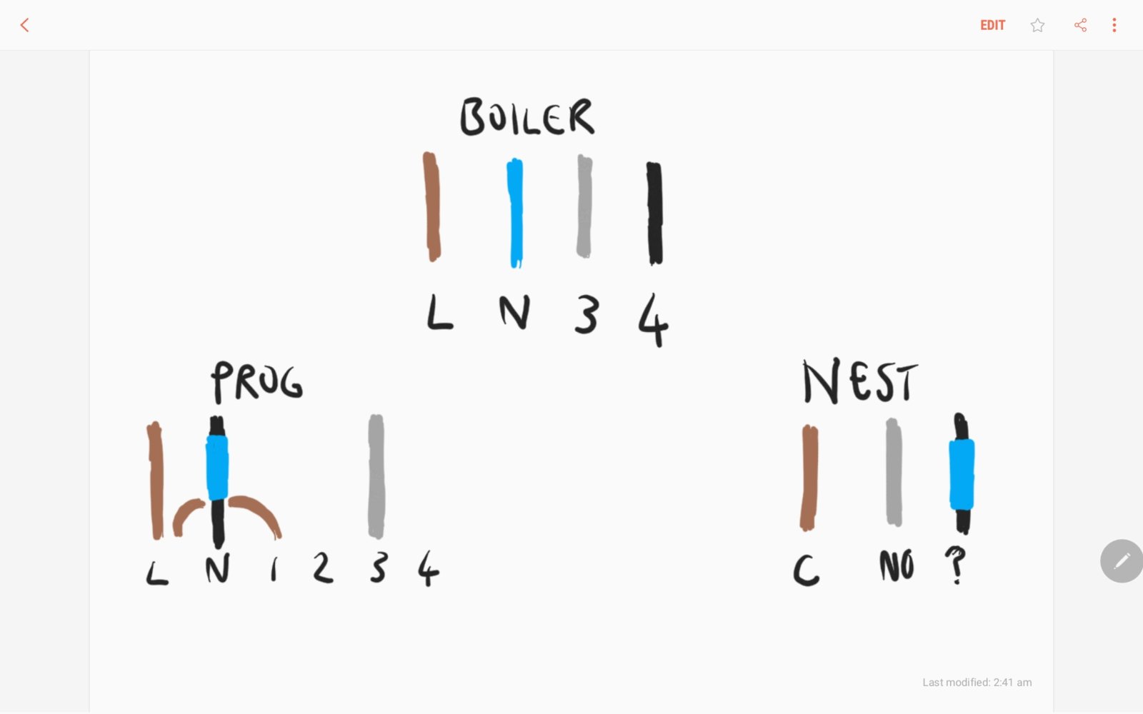

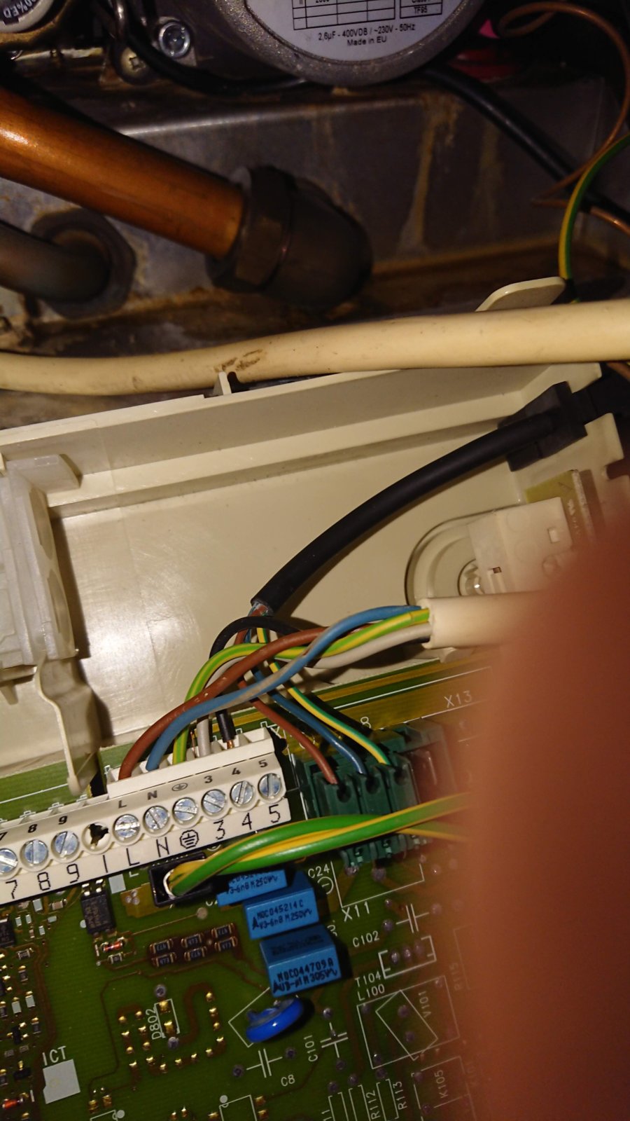

Ive attached images of all the wiring in both the Valliant Ecotec Pro 28 combi boiler, the nest thermostat E and the programmmer.
The neutral wire from the boiler doesn't appear again in either the programmer or thermostat 'wiring box'. There's also damage to the neutral cable in the boiler and the copper is exposed, possibly why the thermostat never worked?

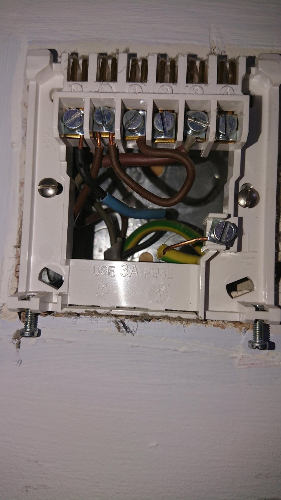

Can we have a picture of the wiring centre/ heating joint box?

Reading the instructions it says
Connect the switched live supply with the terminal marked RT at X1 (beside the LNPE connections) then remove the link at X100 (do NOT connect 230 volt to any other terminal than the RT connection).
It also refers to "Observe the flue-gas connection that is required on a room-sealed air/flue gas installation." so would assume this needs doing by some one registered as gas safe?
There’s no link on these older models of pro. Ebus and 20v which says do not use for U.K. shouldn’t really be removing the cover on this boiler as it forms part of the room sealed appliance. Which programmer is it? Your Nest common and NO look both brown cables to me.

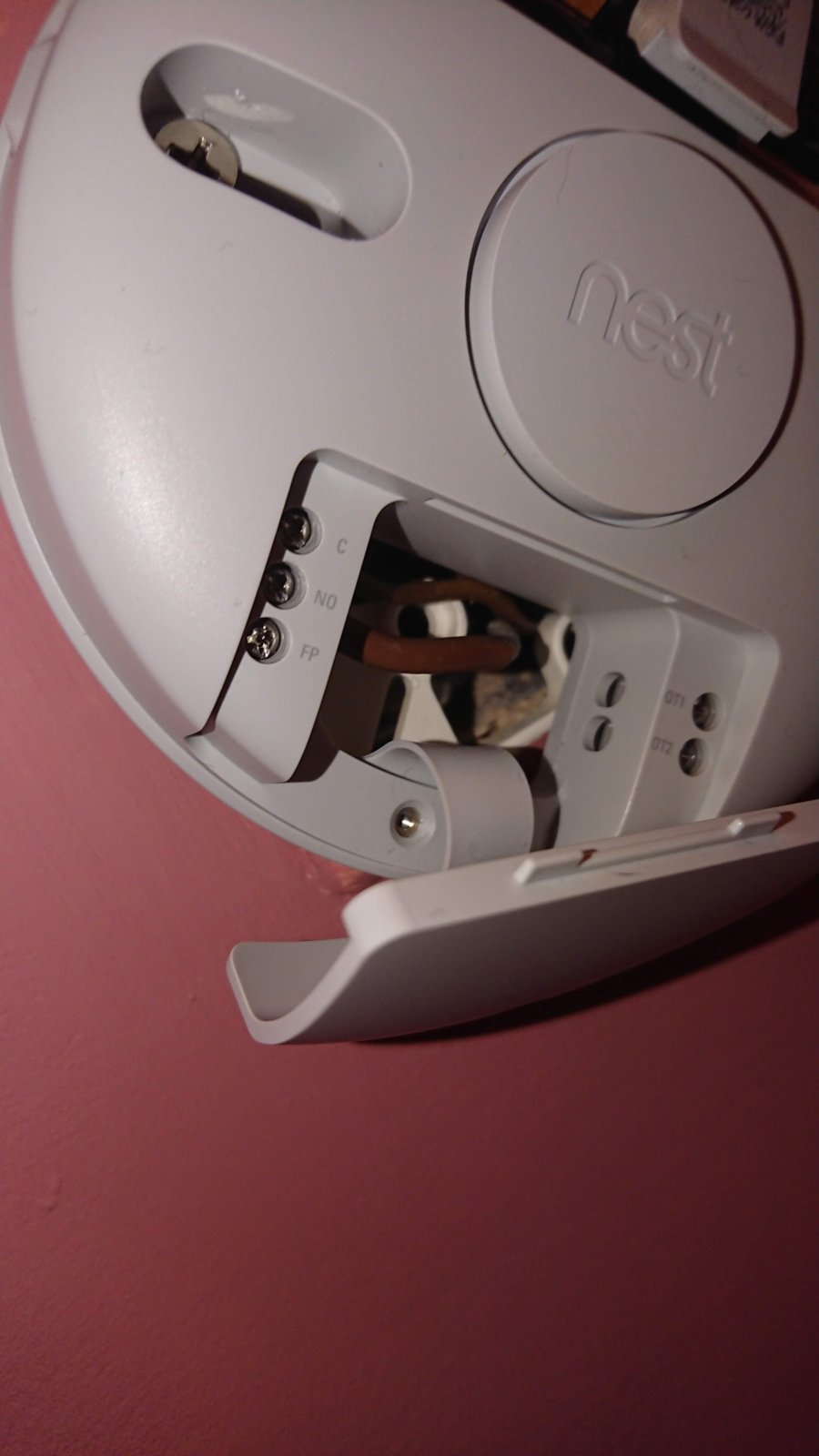

remove the batteries from the nest E , if boiler stays on the fault is at the boiler end, if it goes off the fault is at the nest end

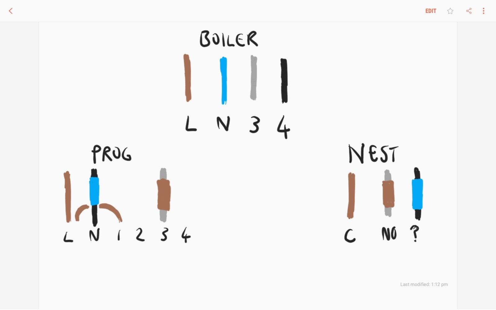

The programmer is a British Gas model UT2. The NO is a grey wire with a brown sheath, as is '3' on the programmer. I should of made that clear on the diagram, apologies.
The boiler will be on depending on the programmer. The nest doesnt seem to make any difference.

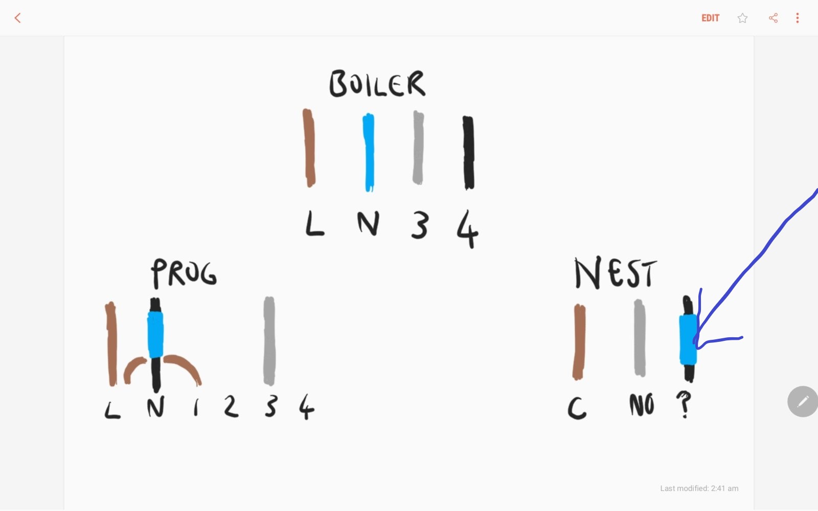

why did you post this , there should only be 2 wires in your nest E
Behind the old thermostat was them 3 wires in the diagram including an earth. The black wire with a blue sheath and has been capped off (?) as instructed for any wires not in use.
Put the programmer back in place, select heating on and see if either of the cables in the nest become live.
This has always been the setup. The programmer controls the heating and the nest heat link doesnt do a thing when its supposed to turn the boiler off to regulate the temperature.
The cables to the nest must be live as the circuit wont complete otherwise as the programmer doesnt switch on.
