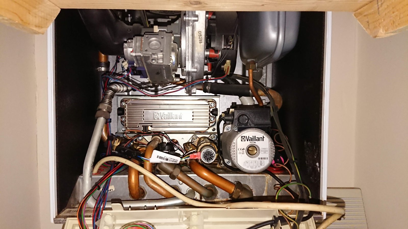

what are you on about ??? it is a Combi boiler, the pump is internally controlled by the boilers PCB
As I have said the numbers don't match and @picasso pointed out seems I found wrong set of instructions, the pump is clearly controlled by the boiler, but that does not mean it has to be built into the boiler, but really it does not matter, the fact remains flex leaves the boiler, and clearly any wiring in and out of boiler would need to be of a type a stuffing gland can seal on, but the cable to programmer is triple and earth flat cable, so some where there must be a junction box, or it seems heating people call them wiring centres.

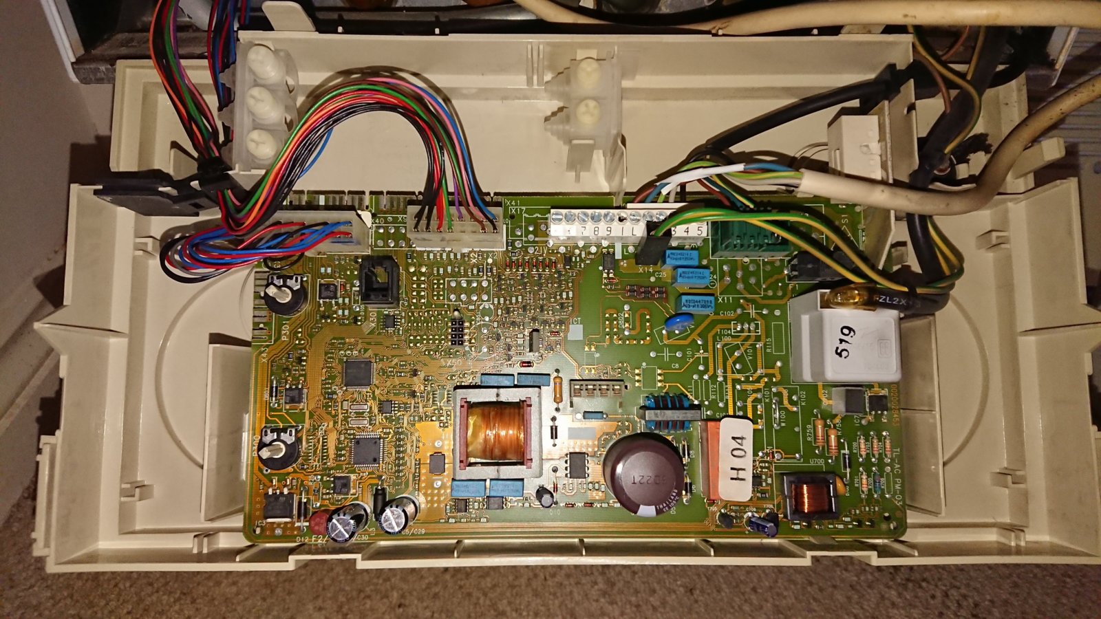

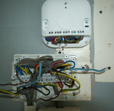

Sorry, I thought id already posted these images. As you can see from the electrical tape on the neutral cable it looks like the previous owners had issues at some point.

Sorry this
is what I mean as a wiring centre, in this case too many wires to fit in the Nest heat link so the junction box was fitted below it, I suspect some where you also have a wiring centre or junction box which is where the flex changed to flat cable, it is hard to seal on flat cable, so since the boiler is sealed and hopefully the seal tested after it is disturbed, some where the round cable changes to flat cable which you can see at the other devices.
Although the junction box/wiring centre shown is surface designed for central heating wiring, often they are socket boxes with blanking plates and a strip of connector block inside.
I know I also have a hidden junction with my central heating, in main house I have flat triple and earth red, yellow, blue, and when it arrives in the flat it is brown, black, grey so that rang alarm bells, on testing found one core was open circuit, running a new cable was going to be hard, so I had to find a way to work with two cores, and since there was clearly a fault want low current and voltage on those two cores, that is why I fitted Nest, I could control DHW and CH plus power the unit with 2 wires.
But until your junction box/wiring centre is found only way to work out how to wire is a long piece of wire and some device to "bell out" each wire. Normally we would use a multi-meter, however the name "bell out" comes from using a bell and battery to do the job, in many ways it works better than the multi-meter, but there is no magic cure, either you need to physically trace or test wires.

My nest E is now wired up as you described but once the call for heat is made the fuse in the boilers isolation switch blows. Any ideas? Its rating is 3amps and now I have no fuses left!
Crimped/pinched wire, on insulation? If it didn’t do it before, I’d say it’s only what work you’ve done.

If so, that is the correct way, so doesn't explain why fuses are blowing. So, either get a pro in as has been suggested, or try posting a couple of photos of the wiring connections at the Nest-e Heatlink and the boiler which might help.
