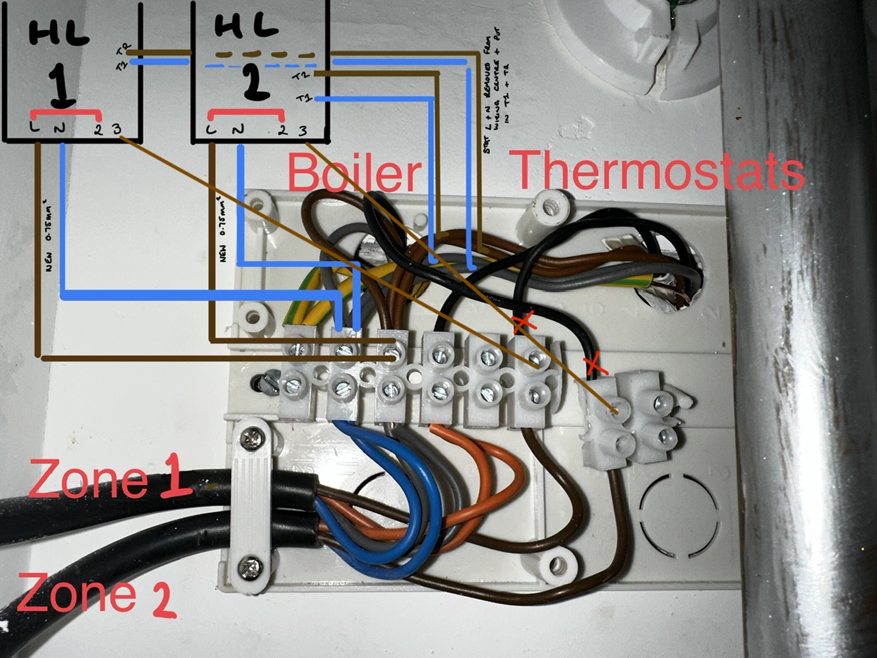

I’ve read many threads on many forums trying to piece together how my system should be wired but I’m looking for guidance from those more knowledgeable than I.
I have a new build with a Logic ESP1 35 Combi Boiler working with 2 Danfoss TPOne-M thermostats on a 2 zone valve system - upstairs and downstairs.
I have purchased 2 Nest Gen 3 Thermostats and got a quote of £160 for a nest pro to install. Though expensive I thought this was necessary due to wiring inside the boiler and removing the cover. However I’ve since realised that the wiring is done from the wiring centre under my stairs, next to the zone valves. So I’m happy to do it myself so long as I can make sure I’m wiring it correctly.
I’ve labelled where I believe the cables are from, though I would need to buy a continuity tester to make sure. The zone valves weren’t labelled but I’ve changed them to manual to confirm.
Here’s my planning so far;
is this correct so far? I think I now need to get live power to from each zone in the terminal block to the corresponding heat link at connection 3?
Above is one of the Danfoss TPOne-M thermostats. Both are wired the same. Am I correct to think I remove the red jump wire, terminate the black switched live and connect the L and N to the nest wall plate?

Not quite. You are close, but you will also need a connection to terminal 3 of the Heat link as this is what is actually responsible for turning the heating on. If you look at the TPOne-M terminal with the black wire in it is marked NO1 (NO = Normally Open) this terminal corresponds with Nest 3 (Which is also marked Normally Open)
I'll just describe one as both will be the same. The wires currently in the TPOne-M are moved to the terminals at the Nest Heat link that have the same function as described below. You can re-route the existing cable, or disconnect the existing cable from the wiring centre and replace it with a new cable to the Nest Heat link instead, then the old thermostat cable can be used to provide the T1 & T2 connections
TPOne-M N goes to Nest N (grey wire in your photo)
TPOne-M L goes to Nest L (brown wire in your photo)
TPOne-M NO1 goes to Nest 3 Heating call for Heat (black wire in your photo)
Add a link between Nest L and Nest 2 Heating Common
Looking at your photo, The live brown wire from the motorised valve is the one that connects to NO1 (or Nest 3 Heating Call for heat) so that the valve opens when this wire becomes live. As far as I can see, the brown wires from the two motorised valves are the two I've marked in red elipses below. If so, the black wires in the same terminals should be those currently going to the two TPOne-M NO1 terminals

Are you saying that rather than adding two new lengths of cable from the blue and grey connections from the zone valves to the Heatlink L & N, I should take the grey and brown from the TPOne there, rather than T1 and T2 as I have drawn?
Below is how I was thinking with the permanent live connection between Heatlink 3 and the motorised zone valve lives. Terminating the black ones from the TP ones where indicated with a Red Cross?;
Your amended photo / diagram looks good.
The blue wires to the MV are the neutrals
The grey wires to the MV are the permanent lives
The orange wires are the switched lives that control the boiler.
The brown wires from each of the MV's are the control lives that go to their associated Nest 3
The two old thermostat cables (i.e. the cables containing the black wires in that you have marked with the red X should then be completely disconnected) then, if required can be used to connect the Heat link 12v supply for the Nest thermostat T1 & T2.
I was planning to redirect the brown and grey wires from the old stats directly into T1 and T2, leaving the blacks unused. Is that incorrect?
Yes, I thought that was what I said :unsure:
Once the old thermostat cables are completely disconnected from the mains wiring, then you can use them to connect the T1 and T2 terminals of the Heat link to the T1 and T2 terminals of their new associated Nest thermostat. This is a 12v connection that provides the Nest thermostat with its operating power from the Heat link.
