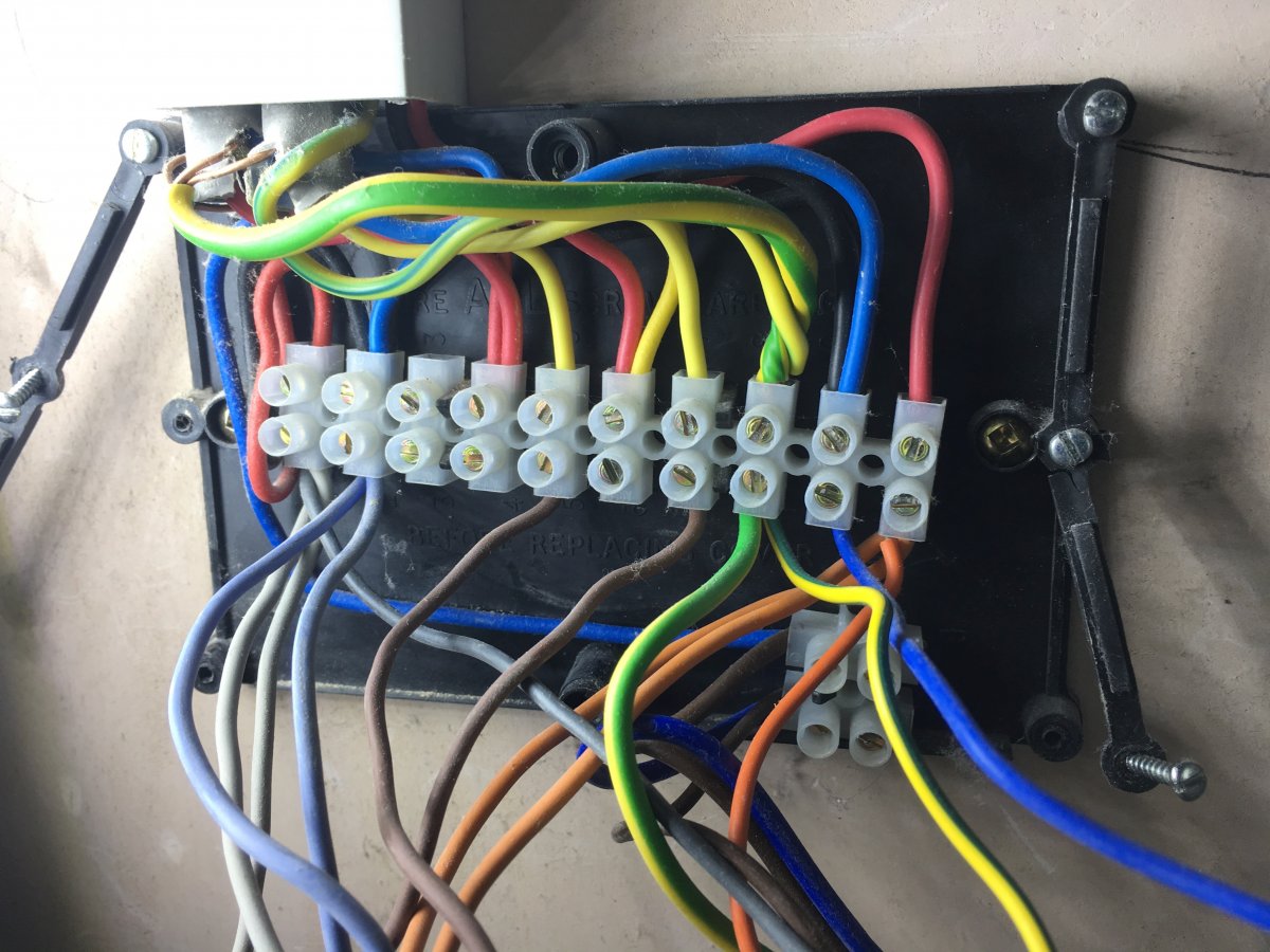

I have two more to install now in my own house, which has 3 zones, bedrooms (heating), main house (heating) and Hot water. This I presume is an Splan install.
The install is obviously different to my last one, but the junction box looks totally different to the other houses wiring.
There are 3 valves. 2 white plastic ones for Living area heating zone 1 and bedrooms heating area zone 2, just below this junction box, and a metal incased valve on the hot water tank. The wiring is as follows (with reference to Junctions 1-10 on the choc box above from the left)
Hot water tank valve has 5 wires, orange to 10, grey to 1, black to 2, blue to 9 and earth to 8
Heating valve 1 (living)has 4 wires, orange to 10, grey to 1, blue to 2, and brown to 5.
Heating valve 2 (beds) has orange to 10, grey to 1, blue to 2 and brown to 7.
I have a black cable coming through the wall with red to 10 (on top in the pic), black to 9, and green to earth 8 (could this be the boiler which is located in the garage?)
from the grey sheaths coming down the conduit, there are 2 reds going to 4, a yellow to 5, a red and yellow to 6, and a yellow to 7 , some of these at least are likely to come from the hall and bedroom stats.
I am only concerned with the living area (zone 1) and hot water install at the minute, once that is successful, Ill connect up the 2nd Heat link. I should know where I am by then.
On the heatlink, I am running live to live, and n to neutral from the switch. I am then linking L, 2 and 5 together.
1 and 4 remain unconnected?
This leaves 3, and 6 to the heatlink.
Im thinking 3 on heatlink goes to 5 on the choc block to meet the brown wire from the living area heating zone valve?
I have not located the cylinder thermostat, just the metal valve as described above. I understand 6 on the heatlink needs to connect to the cylinder stat?

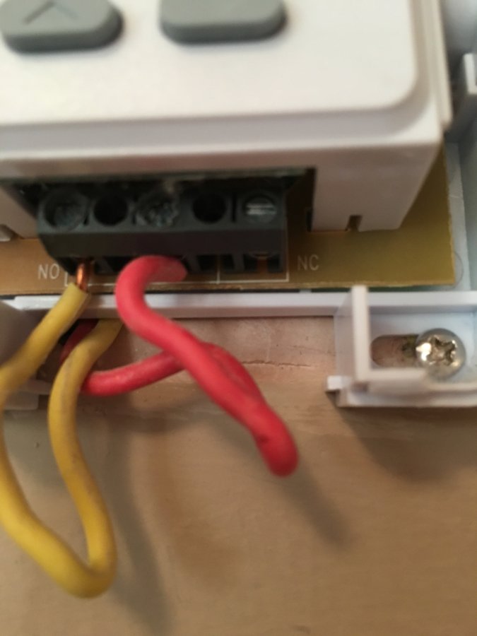

This is the living area thermostat. which of these two wires would be the wires that attach to t1 and t2 on the heatlink for nest 12v power? and what should I do with the third?
This is the bedroom zone thermostat. Easier this time as there are only two wires. Ill join them and run a continuity test.
Why would the first stat have three wires, and the second only 2 wires?
OK sounds reasonable.
Probably not, because according to your description of the hot water valve wiring, terminal 9 would appear to be the live supply to the hot water motorised valve. So I suspect it will have more to do with the hot water thermostat and any hot water time control (of which you make no mention) But you need to confirm this.
To work out what they all do, you need to say what each of the above wires is connected to at both ends. Unfortunately, there is no defined colour code and the wires would be chosen according to the personal preferences of the original installer. It would be foolhardy to guess.
Sounds OK
Can't comment on this without knowing where the wires from the living area heating zone room thermostat come in to the wiring centre
Correct, so you need to find it. Also, what controls on on/off times for the hot water. (I assume that the room thermostats are programmable to provide time control for the heating part)
None of them, until you trace them and remove them completely from the wiring centre, otherwise you could put 230v on your thermostat and blow it up. Once the wires are disconnected from the wiring centre, you can use whatever colour you like, so long as T1 at the heatlink goes only to T1 at the thermostat and T2 at the heatlink goes only to T2 at the thermostat. For the unused third wire just insulate it so that it doesn't cause any short circuits and tuck out of the way.

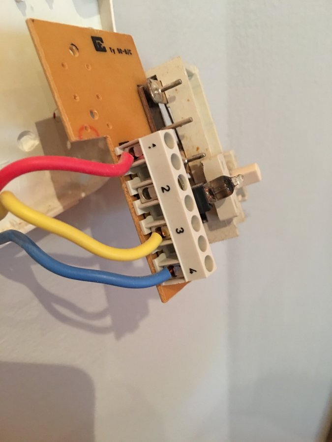

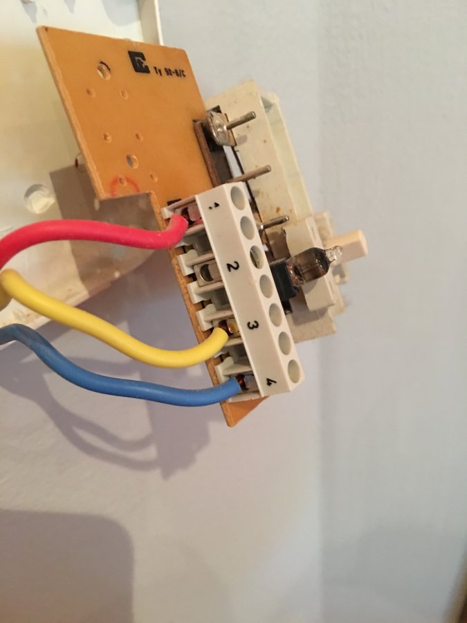

and the corresponding wiring on the wall plate:
Apart from the L, N and Earth coming in, there are only 3 wires, red to 1 (zone 1 living area common), yellow to 3 (zone 2 bedrooms common) and blue to 5 (hot water).
I will be using 2 Heatsinks. The first will control Zone 1 heating for living area plus HW, and the second will control just zone 2 heating for Bedrooms. Would I be safe then connecting red on 1 above to 3 on Heatsink 1, and blue on 5 above to 6 on heatsink 1? Then for the second zone (bedrooms), yellow on 3 above to 3 on heatsink 2?

So, it was back to the main junction box in the airing cupboard and a concerted effort to trace all the wiring. What was throwing me was that I couldn't find an obvious cylinder stat, but I knew there had to be one.
So I pulled the instructions for the tank, a Santon PremierPlus 300 ltr unvented. It is delivered pre wired and assembled, and after reading it was clear that the thermostat was actually incorporated in the immersion heater housing.
Once I could see that, it was easy enough to trace the stat comm wire back to the junction box, and a connection to 6 on the Homelink. Then 3 to the brown on the heating valve, 5, N and L took care of itself.
On the 2nd homelink, just N, L and 2 to the bedroom zone valve.
To trace back the stat wiring from the 2 room stats to the junction box, I found it easiest to (with mains power off) join the 2 wires at the stat end, then use a multimeter to run a continuity test. Done the same with the 3 wires on the other stat. Quick connection to the T1 and T2 terminals and I have the Nests wall mounted and powered.
