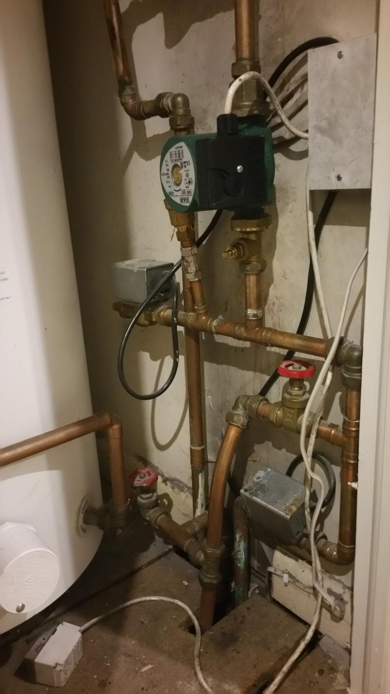

There are zone valves there (see pic). The pump water flow is in the DOWN direction (surprising) and the zone valves are after/below that.
Does that make sense?
The safety discharge is a lot of work though. It's been mentioned before, in the context of "I can't change anything without making that copper pipe, but that would require a new pipe through the bathroom = £££".
that box in top right hand corner is the wiring center thats where your heat link needs to be fitted
that is your current setup.
you need to follow the s plan diagram in the nest manual.

It seems like some of these random wires coming from the wall might be connecting to those zone valves then?
I'll check out that box, see what it has to say.

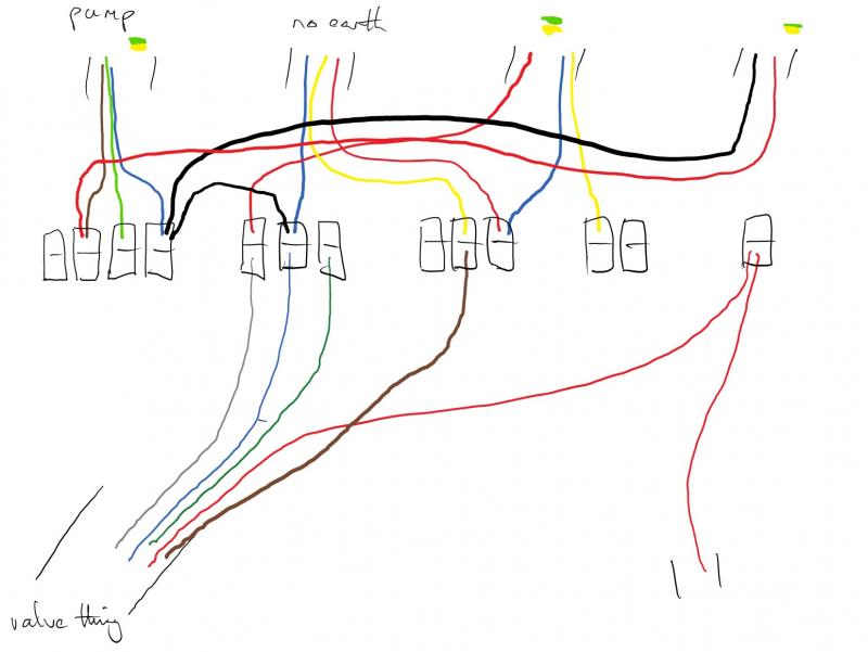

Okay, here's what I have upstairs. I've omitted the earth wires.
I guess the DHW switched live/call for heat would go into the other valve (which I didn't include as it's not used).
From your diagram, the brown wire from the valve seems to go to the DHW terminal (3) in the thermostat, but surely it should go to 4 in my case. Maybe I got it wrong.
Is it more obvious where I should plug in the Heat Link, and if I need to use the Common or Satisfied?

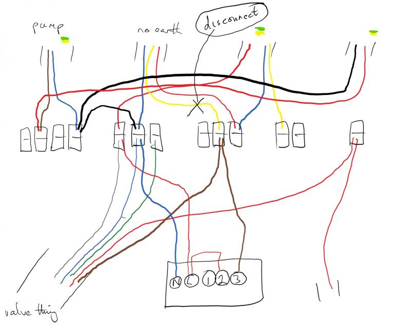

obviously liva and neautral to heat link then put a wire bridge between L and 2 on heat link then wire 3 from heat link to brown on motorised valve but disconnect and isolate the existing wire going to brown.
Just leave your timeclock connected it will be redundant but saves mucking about with it.
use the usb adaptor to power the nest itself don't worry about t1 and t2 no risk of blowing it up then.
thats it, but terminate that spare wire properly using a terminal connector, just because the rest of the installation looks like dog turd doesn't mean yours should :lol:
do it properly and safely and be the better person :D

So, I thought I'd tinker and investigate more, and I am still a little confused about the wiring.
You're rolling your eyes now, but I wanted to essentially unwire the current thermostat, and I've worked out which one that it.
Currently though, I did what I suggested at the beginning (directly replace the current controller with the Heat Link). I know, I'm a stubborn sod, but an inquisitive one. And it seems to be working.
However, I'm not sure it's not actually still beholden to the old thermostat so I need to work it out tomorrow.
Is this why you suggested putting it upstairs by the pump, because it would essentially then bypass the old thermostat?
