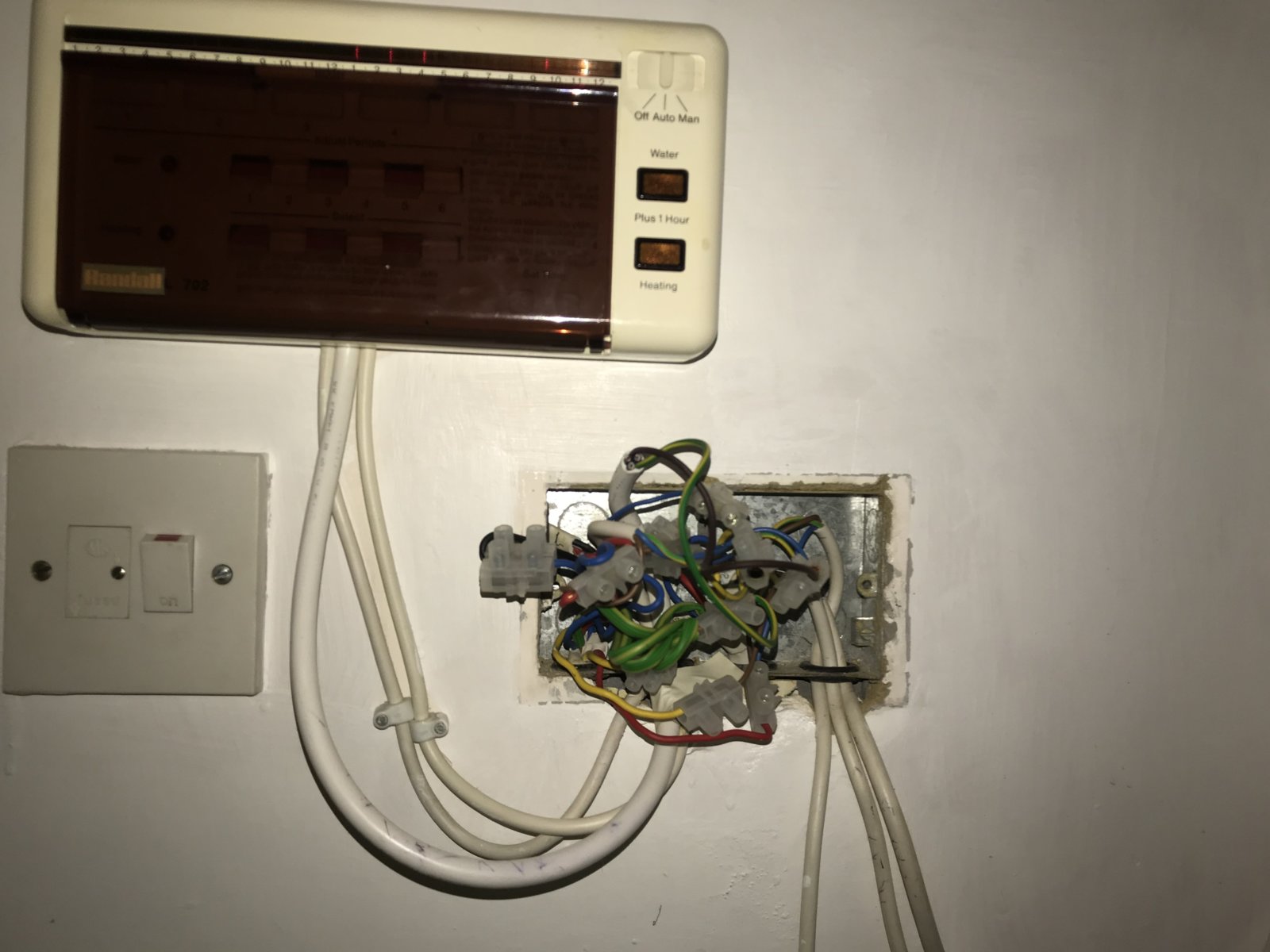

It did flash through this when initially setting up and I recall some issues at the time which involved much running up and down stairs, which is where the heat link is installed, in the airing cupboard. I am surprised I can't access set up from the iphone app. I will report back once back home and checked it out. If not I will rip the spaghetti soup original wiring out and do a proper fit out to be doubly sure. I will upload a couple of pics of what I have inherited!

I'd be rewiring that
I definitely will be, but with a Honeywell 10-way junction box. I have recently moved in so lots to do, just need some hot water!
All now working 100%. After much faffing about ending up total rewire of junction box and setting the NEST to the correct boiler type. See above edits.
