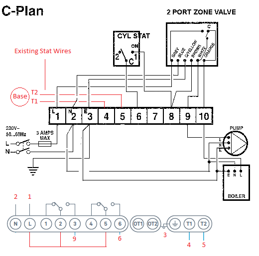

Oh look, more terrible central heating wiring!

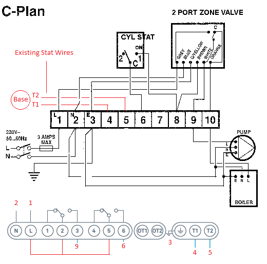

Is it me or is the 3 core flex to the programmer redundant as it is doubled up with the 5 core flex?
Is that diagram correct? I would have expected a blue wire in cable 1 not cable 2.

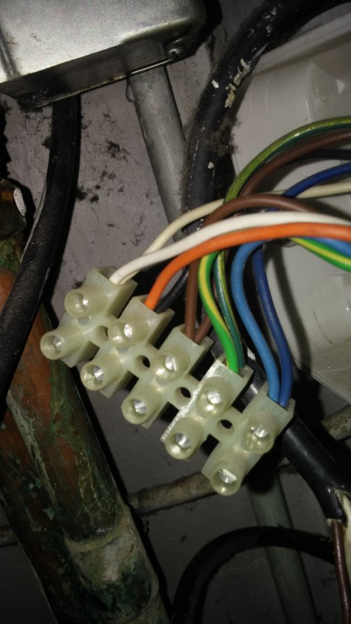

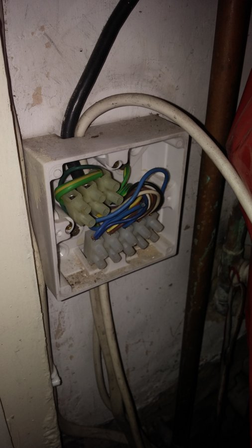

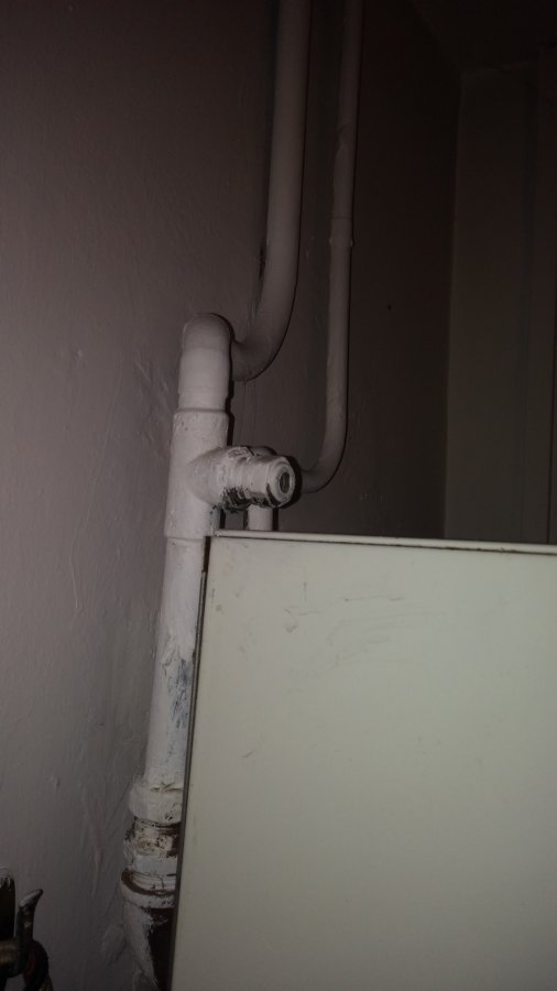

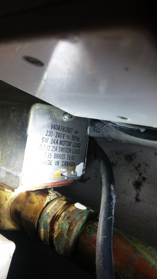

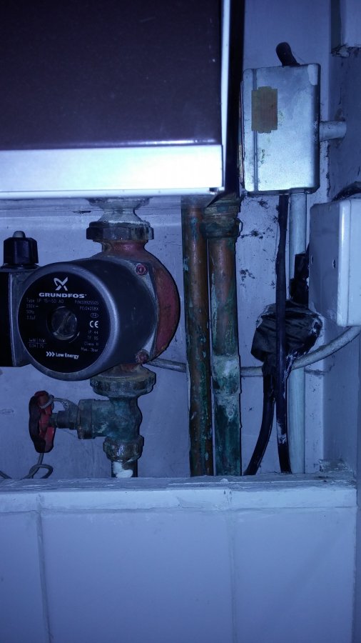

Right, here's a picture of the motorised valve on the pipe, i can't tell you what pipe it's on as i have no idea what pipes are what. Also pictures of other pipes from the boiler.

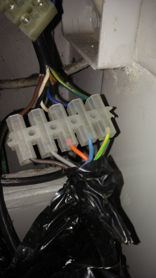

Also there are only 5 cables coming from the motorised valve as shown (the bottom set of wires in the pic, it is then joined to another distribution block and then on to the junction block as per previous diagram) I've also included a picture of the model of the valve.

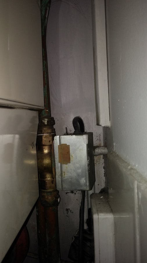

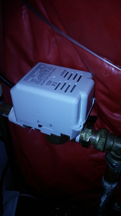

Lastly a picture of the cylinder thermostat, there is also on the a cylinder pipe a zone valve actuator. Last picture shows the actuator wiring being joined to the wiring of the cylinder thermostat (i haven't yet determined what is joined to what) which then goes down to the boiler room. I have no idea what the zone valve actuator does to be honest. the whole system seems a mess but it appears to function, correctly or not I don't know...

So your saying now that there are 2 motorised valves? If that is the case then it is a S plan system.
Why not just connect the Nest two wire ( com and call ) output in place of the room stat for the moment and put your programmer onto 24 hr heating on?
Then at least you can have all the fun of the Nest.
Later you can see if you can sort out your wiring mess and if there are really two zone valves then rewire it at your leisure as a conventional S plan and ultimately connect the Nest water connections.
With that wiring mess it may be easier to just move house!

Tony, sorry I'm confused, do you mean remove my existing programmer and install the heatlink in it's place with the same wiring (live, neutral and earth then connections for call for heat and water) and just replace the room thermostat?
Ok, if looked at the wiring instructions for the drayton zone valve here:
http://www.draytoncontrols.co.uk/WorkArea/DownloadAsset.aspx?id=10510
and my wiring diagram is beginning to make a bit more sense now. I think some of the confusion here is some of the cables have been joined/replaced with different coloured cables. Just want to know if safe to wire as is to nest heatlink.
Many thanks for everyones time.
Well as the wiring is very poorly installed and does not meet the minimum requirements of the wiring regulations, I'll say no, it is not safe to wire it as it is.
I would strongly advise calling an electrician to properly re-install all the heating controls.
