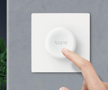

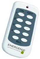

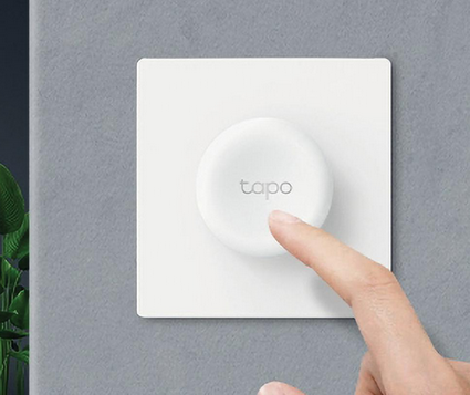

There are so many smart controls, from the smart bulb, to smart relay which can easy be mounted in the lamp so can also have switched, and then three types of smart switch, one which needs a neutral, one which passes a small current through the bulb, and one which uses a battery.I use a remote control 1709150024652.jpegit has the disadvantage is it can get lost, knock it off my bedside table, the magnetic backed button 1709150210414.png is another method, I use one as a door bell push, turning it can also dim lights. The big advantage is you can mount it anywhere, at one point it was stuck to the metal head board of the bed.
