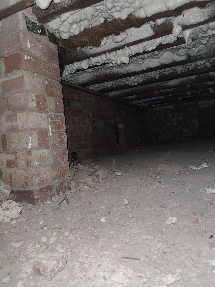

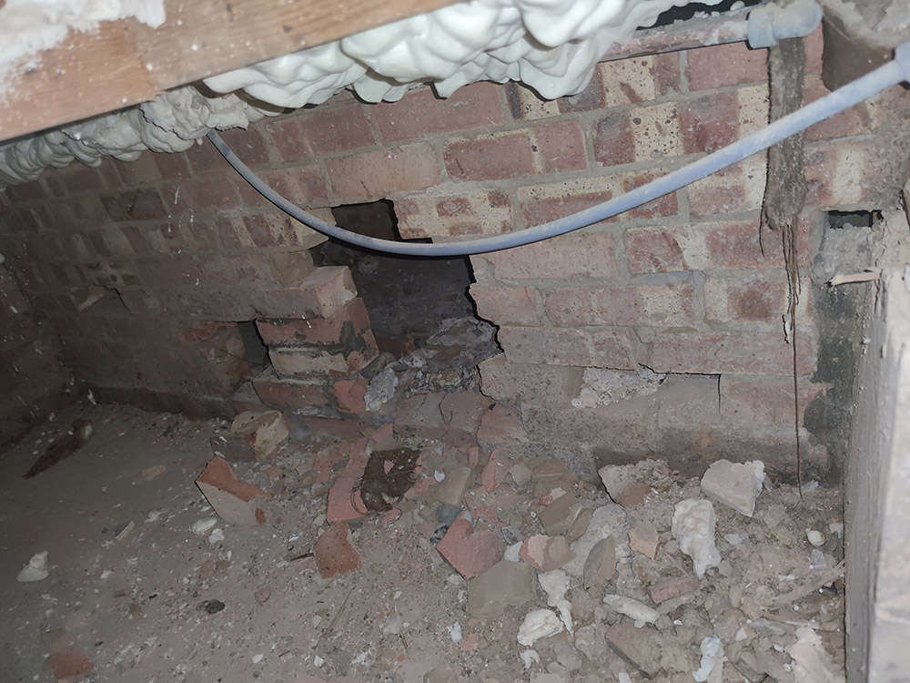

Small development.. that I am really concerned about. The builder came along and told me he will find the central leak.
Our house is built on suspended timber with a brick wall foundation that is built within a large concrete sub foundation.
To find the central heating leak, I came back to find he has entered under the flooring by lifting the floorboards and making small holes in the brickwork to pass through. I have attached the photos. When I asked him if he will repair the brickwork he told me that it is not necessary as the foundations are strong enough and the holes were as small as possible.
Side note - he did not find the leak. So these holes were completely fruitless. And when he came to put the laminate back in place, he repeatedly tried to put cardboard to even it out again..
Have I reason to be concerned that the ground beneath me will collapse?

Evening, no it won't fall down, but it's shoddy to say the least, he's a bodger.
Give this guy his P45 and a lighten your load.
As a side note, it's quite a curious way of insulating joists o_O are the air vents on the outside of your house, unobstructed?
Is that foam in between the joists???

And get that brickwork fixed please.
It's icynene spray foam and fully breathable. It was not done by this same builder but a well rated insulation company who gave a guarantee and assured me its fully breathable even over the ventilation bricks. So I was not particularly worried. It was dry as a bone under there but admittedly we're just coming out of summer..

How important is it to fix that brickwork? The floor is only 80cm high and he's refusing to do it..
I think he's forgotten who's paying his wages.
The brickwork was there for a reason and wants re-instating, sleeper walls are rarely neat/perfect, so won't take him long.
Or get rid of the clown and brick it up yourself, yes, you can do it.
