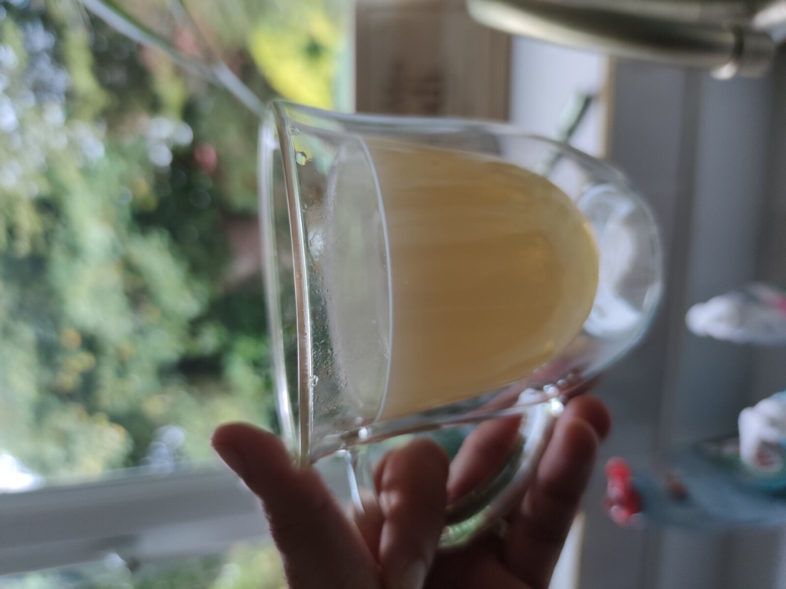

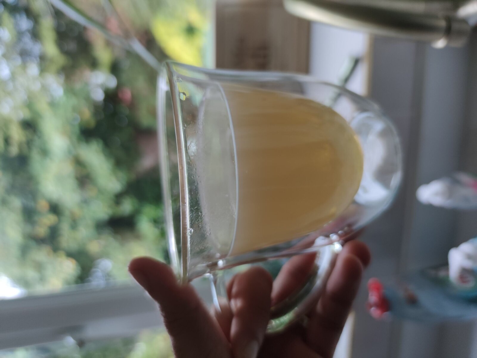

So after stopping the leak, he filled the radiators with water to a pressure of 2.7,bled to 1.9 then left. I further bled them to 1.5 later and this is the colour of the water in the radiators.. Should it be this colour?? Bear in mind all the radiators are brand new
Your heating setup is a mix of old and new, pipes with accumulated deposits from the old etc have been drained and then refilled with a mains pressure whoosh. I wouldn't expect the water to be clear, but so long as it contains a suitable mix of inhibitor it'll be ok. There are millions of central heating systems in this country filled with dirtier water than that..
